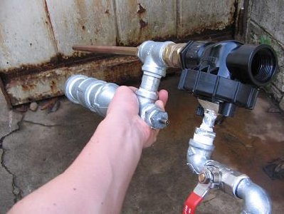

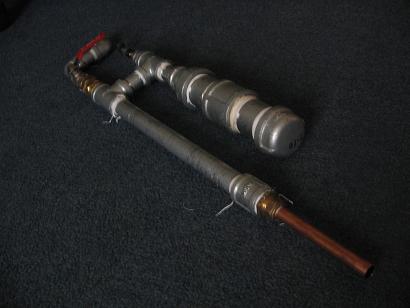

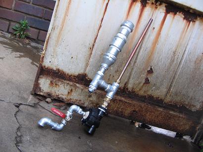

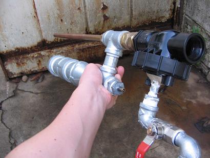

Cannon Name- EVO4
Type of Cannon-Pneumatic
Valve- metal barrel sealing
Exhuast- Low pressure- Hunter Jartop sprinkler valve (looks crappy)
-High pressure- 1/2" ball valve
Main ammo- Nails sharpend both sides and tempered.
Right now I have the sprinkler valve on it for the best preformance at low pressures. It does make it a little ugly though. But at high pressures (when I eventually go to high pressures) it just has the ball valve as the exhuast and trigger and looks sweet.

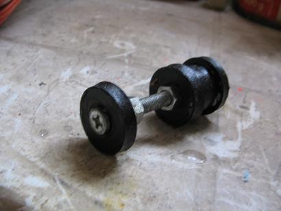

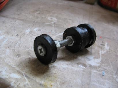

All metal design, very tough and it has an ultra light piston made from a bolt and some nuts and rubber washers. It has no pressure gauge and nothing fancy on it, which makes it really easy to operate, really easy to make and leaves it compact, portable and easy to modify.
Lots of work and time has gone into this project and as a result has made a spudgun with few flaws. Not bad for my first piston valved cannon, first metal cannon and fourth ever cannon. :D All the wall of doom episodes were made with this cannon, here is episode four(which is the best one):

I like it Alot!! I like how much its evolved from the start till now. The piston is very simple and and i bet its pretty light. Did you notice a big difference in power when you upgraded to a sprinkler valve? All these new piston cannons are making me crazy! I need to build one.

Thats awsome! what pressure can your sprinkler valve hold up to, coz having a metal gun it would be great if you could take it up to some high psi :twisted:

The piston also has a spring behind it. There was more power when I added the sprinkler valve and it did change the sound more like the a real shotgun but it should only make a difference at low pressures. The sprinkler valve is rated for 10bar, 100 psi is about 8bar.
I was planning to do more to the shotgun but when you don't have the right tools and enough cash it can be difficult. Owell, there will be many more.
Forever dreaming...
joannaardway
Posts: 949
Location: SW Hertfordshire, England, UK.
100 psi is about 7 bar, not 8 (which is about 115).
10 bar is almost exactly 145 psi, which is enough for a very decent amount of power.
