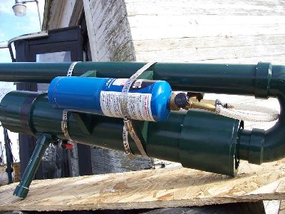

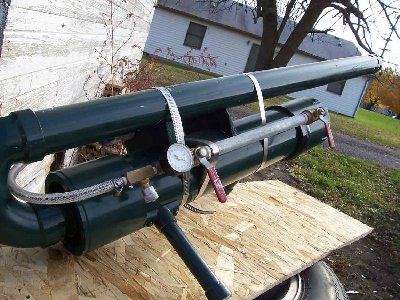

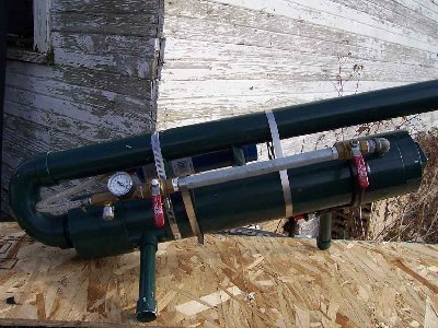

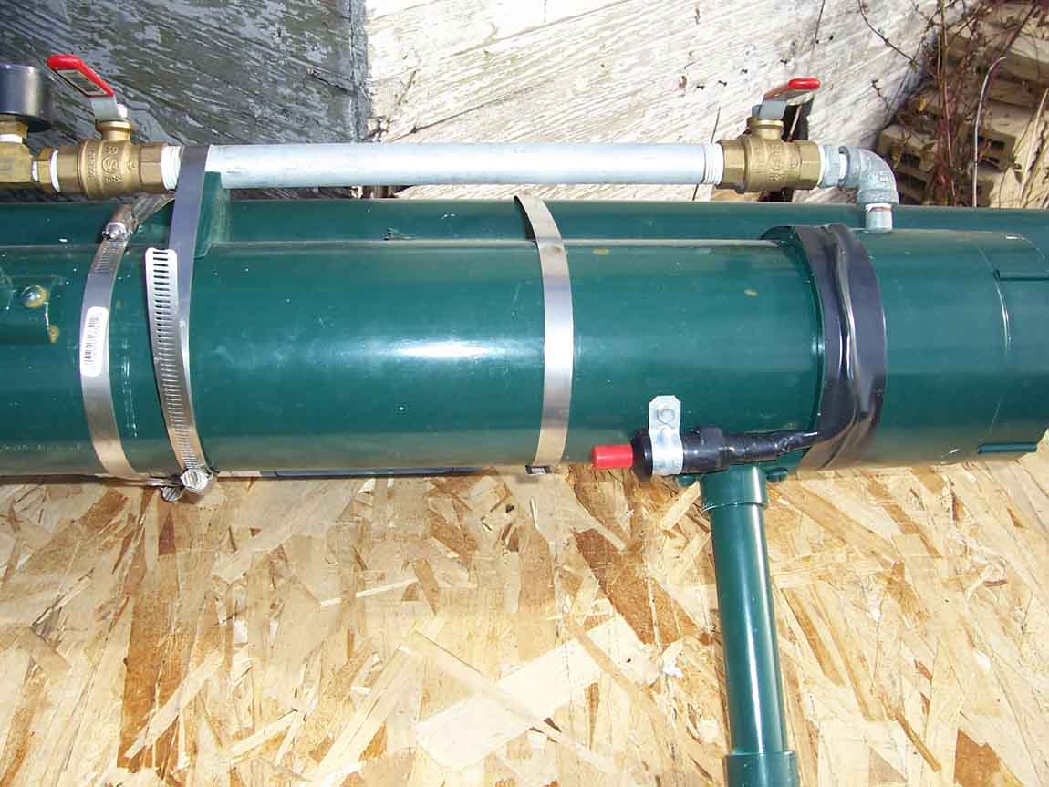

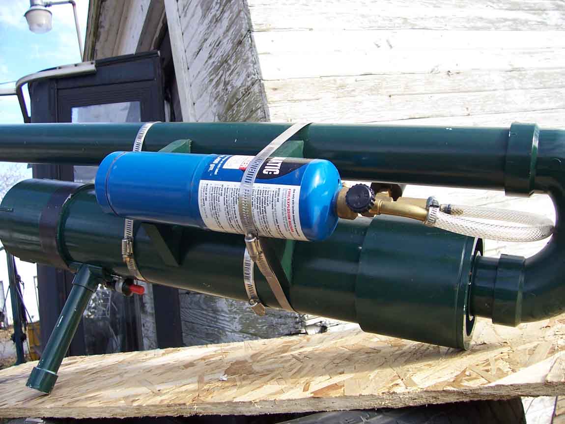

Here is yet another propane injected spud cannon. It's not anything special but it's simple, sturdy, easy to build, and launches huge potatoes well over 300 feet.
Propane Injection and BBQ Igniter

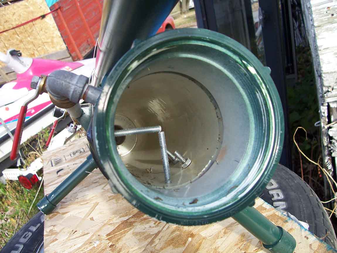

Single ignition works pretty good, might try dual later.

intresting tripod stand you got for it lol
how much propaine u put in it :?:

Wow :D looks very good.
How much volume the chamber have ?
Which diameter are the tube have ?

WOW! Very nice and clean, one of the nicer guns to come through here.

Spudstuff you mentioned you do it without a regulator does it work good that way?

You can get by but the problem is that when the pressure in the can drops it effects the performance. I would always reccomend using a reg.

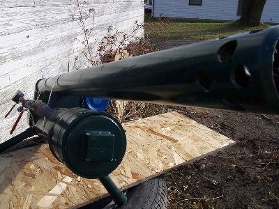

I charge the 12 inch x 1/2 inch injection pipe to 40 psi. It's the most powerful to cosistent ratio i've found. I have fired a 60 psi charge and it blew the potato into tiny pieces as it came out, but it misfires a lot any higher than 40 psi due to incorrect fuel to air ratio. The chamber volume is roughly 300 cu/in and for it I used 4" pvc the barrel is 2". I could have used a longer barrel but it think it looks better this way and is easier to carry.

Do you have interchangeable barrels on that? A chamber that size could launch some heavy things pretty far.

nice gun, i'm lovin' the hose clamps!
