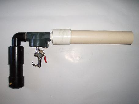

Yes this thing looks stupid and not very formidable,but this thing surprised me alot from the first shot a a nice fitting tatter it sent it flying about 80meters and the chamber smacked me in the mouth and gave me a nice lump.

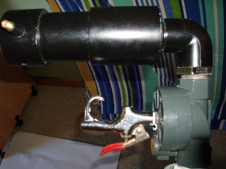

Its quiet to shoot and doesnt take very long to fill with a pump which is good as its portable.The C:B is about .5:1 and i have fired it at 150psi.It is all class 18 construction apart from the barrel which is class 12 both chamber and barrel are 50mm diametre.The valve is a 25mm modded sprinkler which for some unknown reason leaks a little out the sealing face.
Max Velocity:800fps+
The whole unit.
The whole unit.
Chamber valve and schrader.

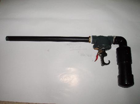

Thumper with PB barrel.

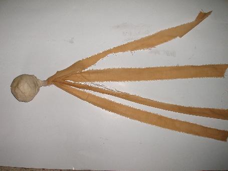

Special ammo for the 50mm barrel its a clay ball coverd in tape and cloth for stabalisers.

Why does the barrel look so wavy? I am starting to sway against sprinkler valves because pistons are so much better. Good job overall.

It was a quick throw together and it fun,plus i didnt have to worry about making the piston and why the barrel looks all wavy i dont no...Just how the photo was taken.

jrrdw-I do actualy have a smaller barrel for it which i didnt thing about posting its 20mm PB barrel and is 60cm long it is also good for marbles.
I'm going to get some pictures of the cool ammo i made for it up soon and the other barrel.

Sure is a pope valve,and there are new pics with the PB barrel and special ammo.
