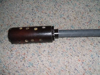

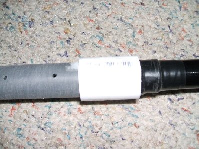

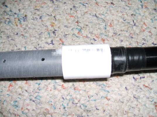

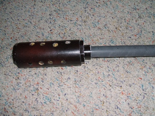

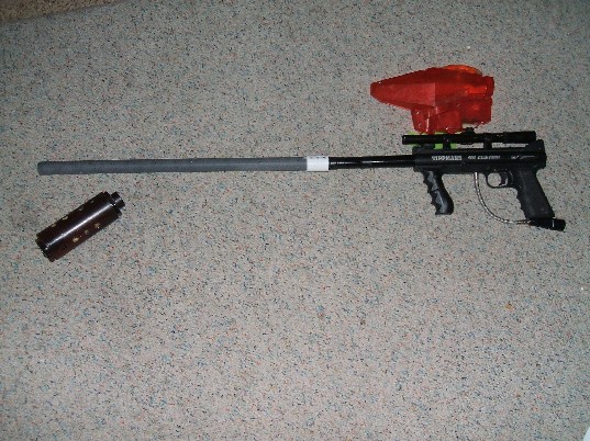

About two weeks ago, I had nothing to do so I modified my paintball gun (again
). I modified the barrel because some of you might know, a Tippmann 98 Custom comes with only an 8.5" barrel when you buy it. I found out that with a few layers of electrical tape, a 3/4" coupler fits perfectly over the end of the barrel. So I got a 2 foot piece of 3/4" Sch 80, chamfered one end, and stuck it in. This thing shoots as fast as ever, never breaks paint, and has more than twice the range of the original barrel, made for about 3 bucks. I know 3/4" Sch 80 isn't as good of a fit as SDR-13.5, but I tried an SDR-13.5 barrel and do to old and swollen paintballs, none made it out of the barrel intact. I recommend this mod to anyone who is tired of having to aim your paintball gun at a 30 or 40 degree angle to try to hit enemies at long range. And the suppressor from my sniper rifle fits (too bad the gun only makes noise at the bolt anyway
) Oh well, it still looks cool, or will if I ever paint the new barrel black and red. Anyway, here's the pics.
