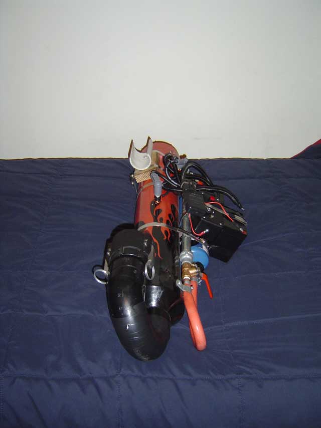

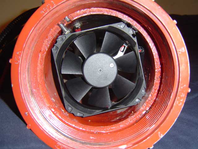

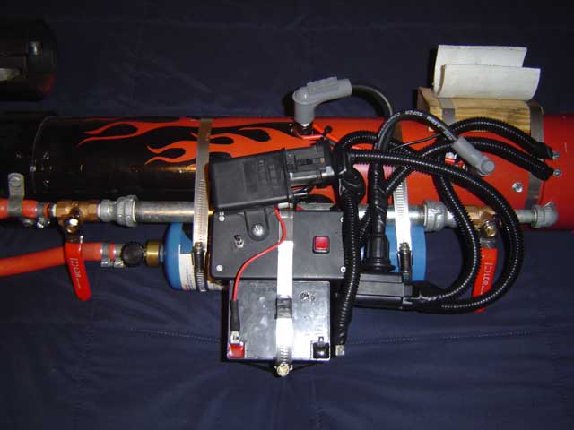

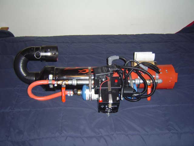

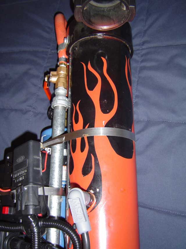

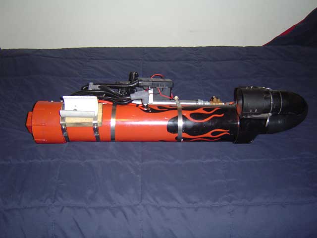

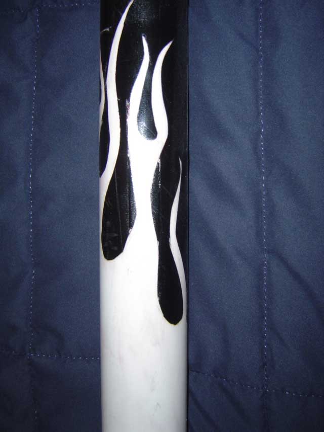

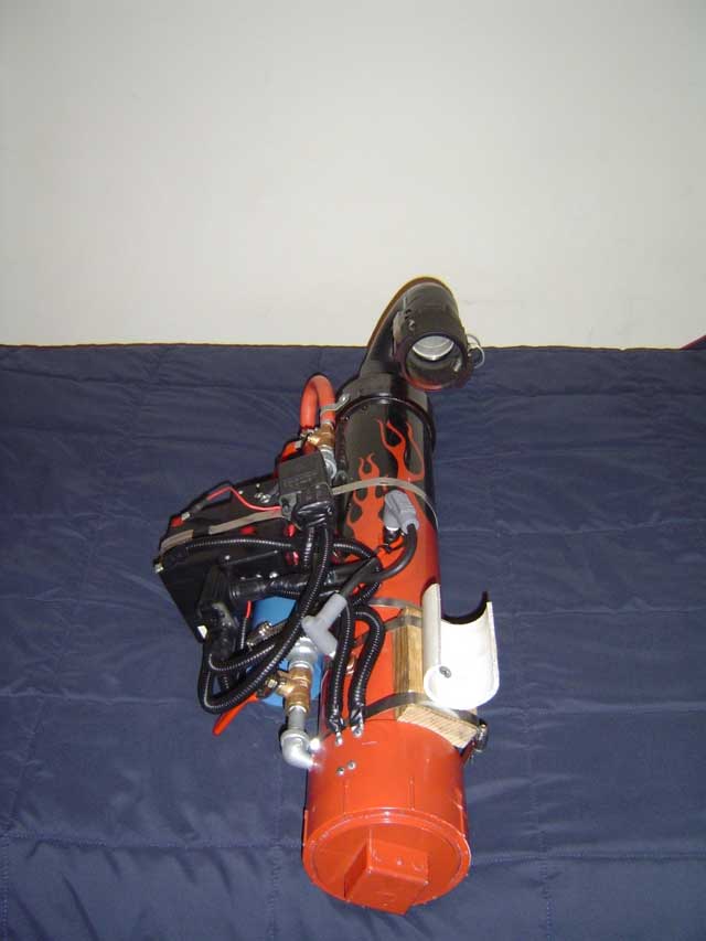

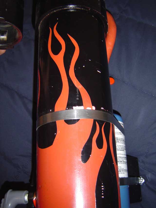

This is my latest combustion cannon. It features direct propane injection, a chamber fan and a full automotive igniton system. The ignition system consists of a coil with a module built in that only requires a low voltage signal to fire the 2 spark plugs. the signal is provided by a sensor that puts out over 100 signals per second. The idea for the igntion system was provided by my friend Larry who is a master mechanic. The gun also features a 24" long 4" diameter chamber with and over under configuration and a 6 foot long 1.5" diameter barrel. It kicks like a mule and fires like a champ, every time. Approximate distance reached at a flat trajectory is 100-150 yards. It shoots about 2 city blocks at a 20 degree angle. I also added a custom flame paintjob to the chamber that is black with red flames.

spudshot: this might not make sense for most people but this is the way my igniton works
an automotive coil that has a module built into only requires a low voltage signal in order for it to fire, thus the module (yes two different modules one is in the coil the other is called a MAP sensor) the MAP sensor reads engine vaccum and sends a pulsed signal to a cars onboard computer. this one in particular sends a 159 hertz signal at 0 inches of vacuum or when there is nothing hooked up to it. so the coil is acutally trying to fire 159 sparks per second but it really cant keep up that fast so it is more than likely around 80-100 sparks per second.

Added the images :)

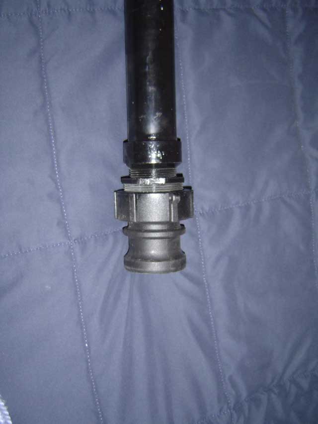

what are the campy things that you have used to secure and detach the barrel called? :?:
Biopyro
Ukraine
Posts: 654
Joined: Fri Aug 04, 2006 5:32 am
Location: UK
Those are called camlocks. They allow the easy changing of barrels because they just unclip.
