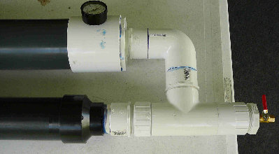

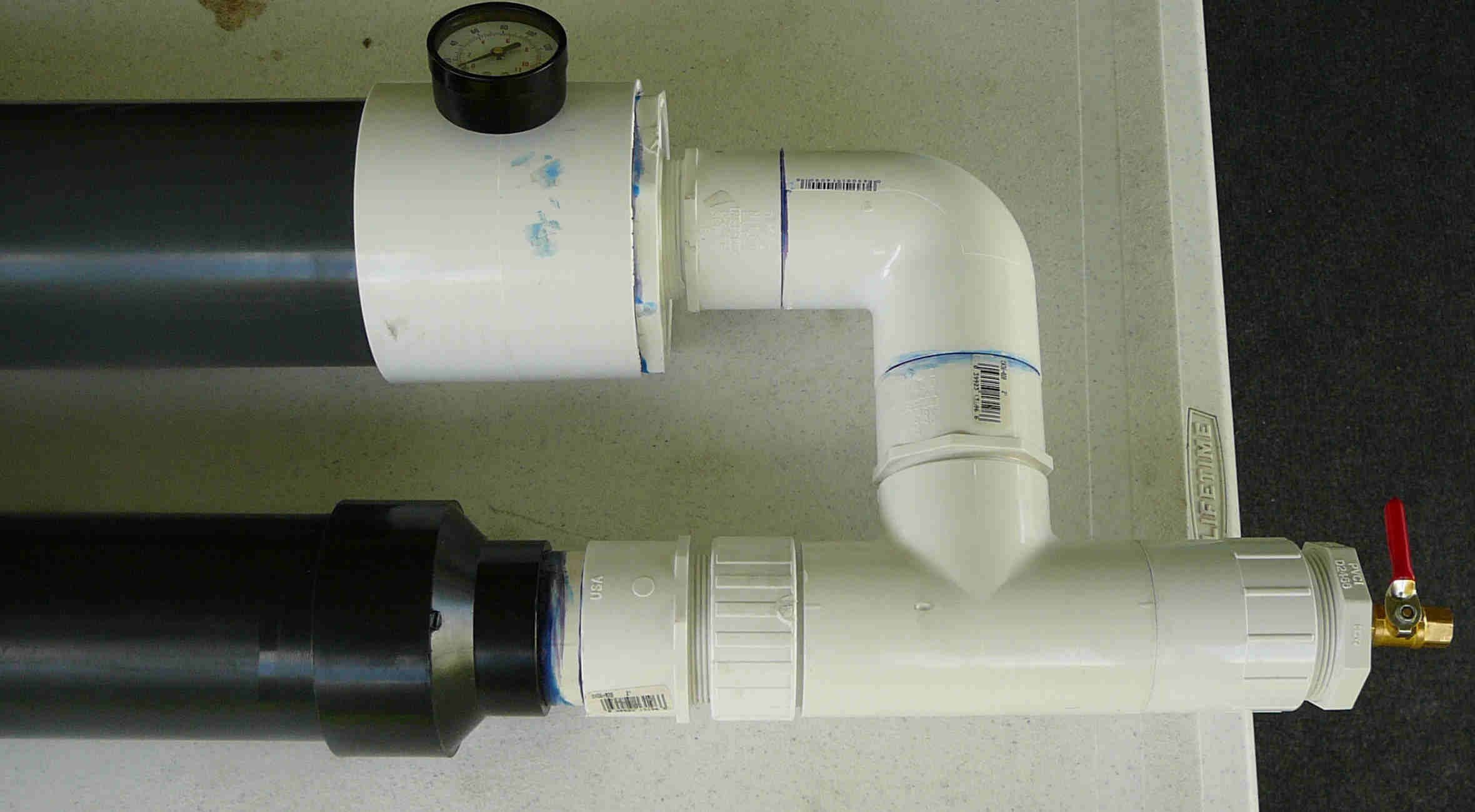

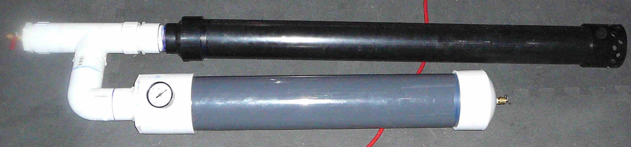

This is my second pneaumatic cannon. It uses a Cobbs valve (1.5 inch porting piston valve in a 2 inch tee.) It has 4" diameter 27" sch80 chamber and a 3" diameter 30" barrel. My first test fire I shot a t-shirt from my garage out of the end of my culdesack at 40 psi and nailed my neighbor's house. I'm currently porting it with a 1/4 in" ball valve, but I have plans to change over to a pneaumatically modified sprinkler valve(mostly to allow for it to be fired from the shoulder, it has plenty of power.) I also have plans on adding a breech to the barrel for easier loading. It's called the highlander because it's going to be used as a t-shirt launcher for my college and their mascot is the Highlanders. I also plan on giving it a nice paint job, maybe even a kilt paint pattern for the barrel. Tell me what you think.
The valve setup
The valve setup
The cannon
The cannon

Looks good. What kind of air supply are you going to use? Or are they only going to shoot 1 shirt? I would suggest a small CO2 tank, like a 5LB with a regulator.

NEVER use ABS in pneumatics. Make a new barrel. It's not pressure rated and can and will eventually be ripped apart, causing it to be dangerous.

I personaly dont believe using ABS as a barrel is any riskier than using PVC. The pressure is going to be in the barrel for a small fraction of a second. ABS does tear apart THAT easily.

Barrel seems to be fixed with the PVC fitting with PVC Cement.. BAD... REALLY bad.

Just pop a few screws in the joint. You really do need to replace that barrel. It WILL rip apart. I have has a ABS barrel on a combustion rip. That produces a maximum of 75 PSI for ~1/10 of a second. That is NOT safe. If you spent the money for a SCH 80 chamber.(unnessary) Buy the barrel.

its especialy useless with regular sch 40 fittings. But over all this is a good cannon. Did you buy the valve for the talon guy? If you could, get a new barrel then get one. A few extra dollars is well worth peace of mind knowing that it wont explode.

the chamber is sch80 just because I happenned to have some left over from something else. I'll put those screws in though. I won't be firing over 70 psi so I'm not worried about the barrell blowing up one me.
