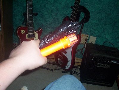

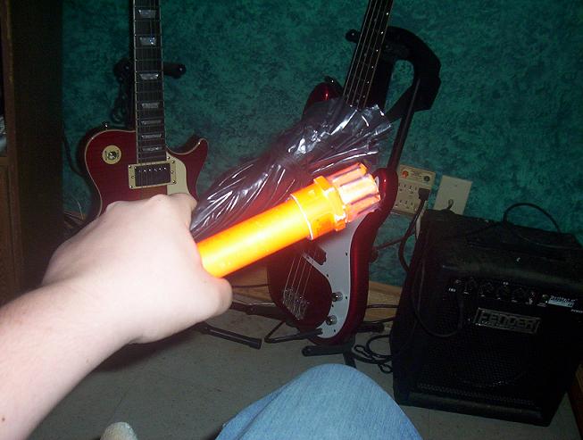

im going to try and put a parachute on a peice of ammo, its a 5in piece of 3/4" pvc filled with water and capped off
i was thinking of making the shute out of a big garbage bag, i have 2 questions about the bag:
1. would garbage bag work or would it be to heavey? if so what should i use?
2.how big in diameter should i make the chute?
parachute ammo
sorry it took so long for me to get the pics but i didnt have acess to a camera for a while
no it doesnt open up right when shot or thrown it goes and comes down about 5-10' before it opens
and heres the pics:
and heres the pics:

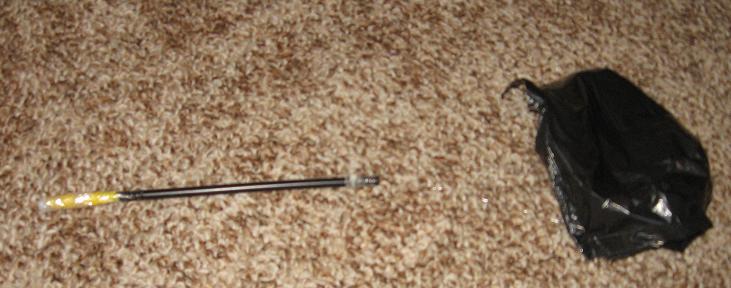

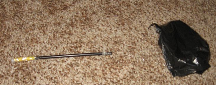

I made one with a pencil for the body, blu tac wrapped in electrical tape weighting the front. I used a chute about 30cm x 30cm made of bin bag, fishing line strings, and a cable tie attaching it to the pencil.
Pretty mediocre height, the lines started to unravel just after apogee, proving that it should work with a few tweaks. The problems started after the parachute lines unraveled. Due to the light weight of the projectile, it never got enough speed to 'pop' the chute open. I may try it with a thinner, more flexible plastic. Any ideas?

Well I made another smaller version, weight was an old shrader, the shaft was a part off a sprinkler system, and the chute was smaller to try and helf it open. It was a total failure, not sure what went wrong but I think it opened like a second after leaving the barrel, and the strings came off a few of the corners. I didn't manage to find it again so I can't be sure on why it didn't work.

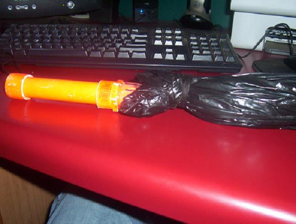

EDIT: insomniac how long are the strings on your chute? try making the strings:chute ratio 2:3 that seems to work best for me (i failed several times before i came up with this) or it could need more weight cuz im not sure how much that weighs
or its possible the problem is the way you load it, heres i prepare mine:
grab the very center of the chute so it falls into a cone shape the just squeeze it and get it as skinny as you can then fold the tip of the chute to the bottom of it and squeeze again the wrap the strings as tight as you can around the bottom of it (where the top meets the bottom) and then fold it over next to the load or put in front or behind the load to shoot, try different things and see wat works best with that size ammo

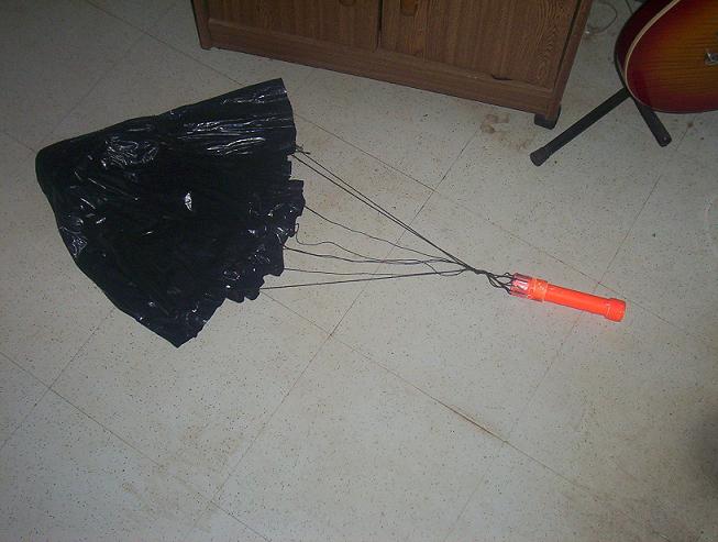

Heres my version of this. If you make slits up the side of the chute it exposes more surface area and causes more drag.
