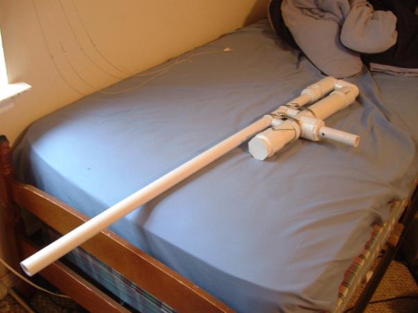

This is a gun I made today for around 20 bucks. Simple, easy to use, and quite powerful given it's size. Chamber is 18" of 2" SCH-40, and the barrel is 48" of 1" SCH-40. Over under design, breech-loading barrel, ignition handle, and piezoelectric ignition.
Last, I know this looks kind of "Blue-Flameish", but it's actually based off my first combustion, with the addition of the handle. It suprised the hell out of me when I finished, that it looked exactly like a Blue Flame cannon.
Butane works great, but the loudest shot so far has been with the solvent cement fumes. :oops:

Cool! What colour are you going to paint it? I really like the look of over under combustions. You should put a muzzle break on the end 'just for looks' Great cannon.

Ehhh... I'm not gonna paint it. Defeats the purpose of me building it as a simple cannon to play around with.
I've also figured out something very cool. Instead of a chamber fan or anything fancy to mix the fuel, throw in a few pennies, (about $0.20 worth), and shake that around after spraying in fuel. Makes the thing fire like pie every time with a nice, loud report.

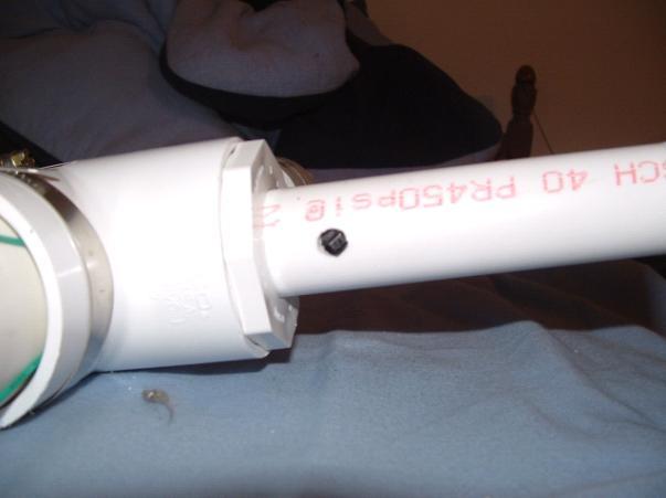

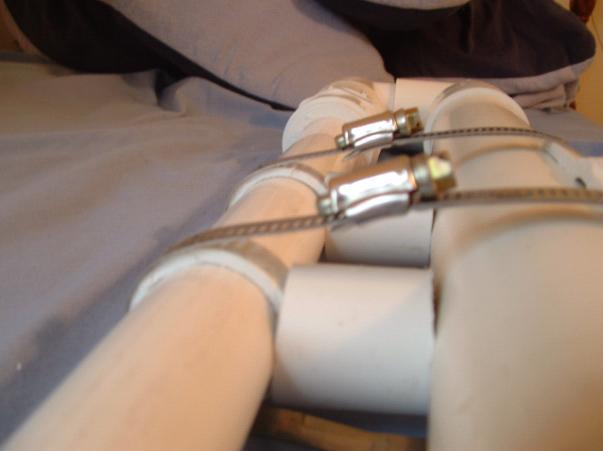

Nice breech idea. That's the concept I'm Building by omega around. The barrel is sliding throught the guides right?
Posts: 3643
Been thanked: 62 times
Yup. They stick a little, though. If you wanted to counter that, (it's not enough to bug me significantly), on your gun, line the inside of the guides with some felt and make them a little looser. Also, I'd suggest making them out of steel so the clamps don't warp them around the pipe. My clamps aren't tightened that much, or they'd do it.
