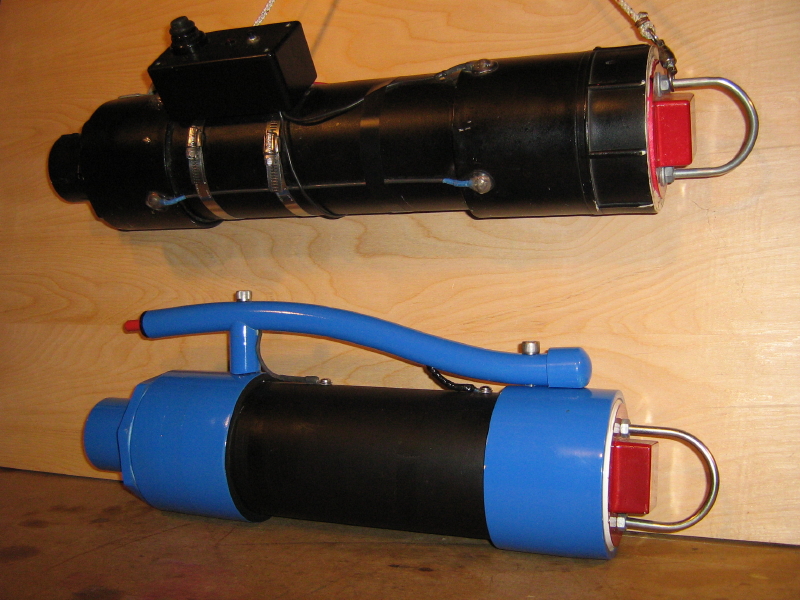

So here ya go Steven, I'll post this picture for you.All black: 2 sparks from AAA bat.BBQ ignitor,w/ fan.
Black+Blue:Pezeio, chamber short,heat bent PVC handle.

NO blow torch. Jeez... not unless you want PVC soup.
Just use a paint stripper/heat gun. I've bent plenty PVC like that no prob.
Strange thing was though, the lettering on the pipe got baked on and wouldn't come off.

Why couldn't you use a blow torch? That would work fine just don't hold it on it for more than like 2 seconds.

It would be a little over kill. A heat gun is like a hair drier but it direct really hot air at something. Our hockey team uses one to give our sticks more of a curve for better shots.

PVC Arsenal 17, you obviously haven't the foggiest to what your talking about. Using a term called 'moderation', it works. One simply doesn't hold the torch in one spot, rather the user 'runs' the torch along the bend not as to heat one region to much. Ive seen some plumbers that do it with weed burners as they are to impatient for smaller torches.
Hair dryer would take a pretty long time, although Ive used one that is used for applying thin plastic film to model airplanes, and it works. If I recall it emits temperatures around 150 degrees.
BenStern, I don't believe there was anything overly sophisticated occurring in the construction of that handle. Probably just hand bent, although you could fashion some dowel points to achieve nicer curves.
As to the guns... The first one is nice in its simplicity, and looks like a gun that will get its use. I love the second one for both being simple in operation, while being unique with the handle and all. Nothing outrageous, while distributing that typical linear flow of cannon building with some artful curves. Noice!

Sure, it can be done. But there's not much room for error when you have a 3 inch flame burning at 3000 degrees right next to PVC. Hang on too long, and it melts or distorts the pipe too much to use. And you'll most likely end up browning the pipe no matter what.
The plumbers you've seen have probably done it many times. Not many people are skilled enough to pull that off without harming the pipe. Of course it can be done, but a heat gun is a much more practical approach. Go try it. If you f-ck it up, too bad.

Wow, were you just talking out of your ass? [JK] After seeing a few plumbers do it, I went home and tried it myself. This with no formal training, or any special skills. Id suspect the only one not capable to pull it off after first watching someone do it, is someone mentally ill. What really bugs me is your speaking out of no previous experience.

wow those are very nice. they look very profesional. i love the wicked curve in the blue one thogh.

Nice guns. We need people on this forum to stop bitching about other peoples guns and actually build one's like these.
