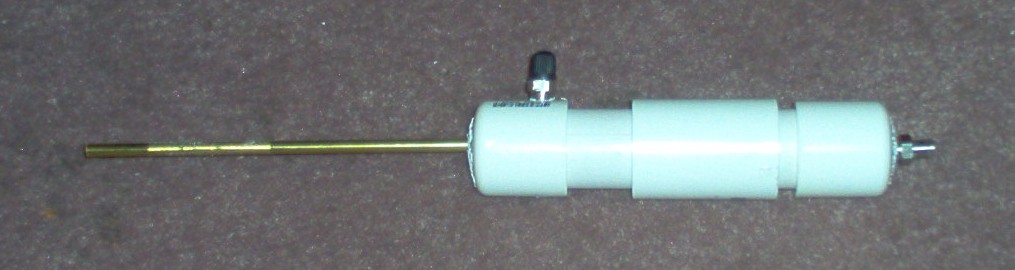

Yeah, i had a strange idea one night and i thought "y does combustion have super small pill guns but pnumatics are all a lot bigger" so i desided to make a super small pnumatic. its just a 1" diamiter chamber with a BB barrel and a diaphram with a schrader valve to trigger and fill it. i havent glued anything yet so if u have suggestions now is a good time to give um.

why don't you add a hand pump right on it for portablility, other than that, keep it simple.
What did you use for a diaphram?

a drain stopper i cut into a circle

one other thing, how are you going to get the pragm out if it needs maintenence, it seems like you're using all solvent weld parts
iamthewalrus
Posts: 559
Location: Iowa (SO BORING!!)
no idea, if it breaks i wont care a whole lot, i dont even know y i made it, just thought it would be fun, i doubt it will work once i finish it and its a good place to store my spare schader valves
