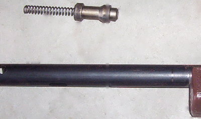

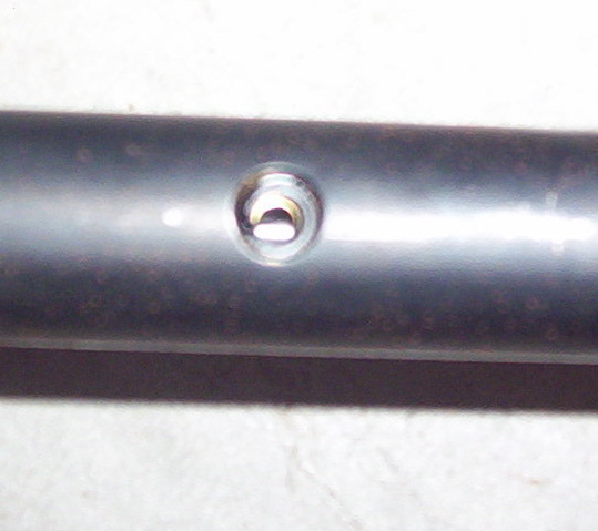

how is it attached in the gun? (Could you tap threads into it if they aren't already there, or is it too thin?)

You could possibly transition from the inlets and outlets provided to something more desirable using some hose and hose clamps.

A few photos may make this easier.

I say make a saddle tee.

LGM, I hate to burst your bubble but unless you can generate about 1000psi that valve’s going to be next to useless. Pump-pneumatic air guns generate as much as 2000psi, if you used the pump tube that would be a different story. What caliber are you going for?
What's a saddle tee, one that has only half of the long section?
And I was thinking of putting that pump tube under the valve to save space, would this be doable? Or using a small steel dry ice chamber. I was thinking of 1/8 to 3/8 inch.

A'm i rite in assuming when you cock the bb gun the trigger catchs the hammers ridge closest to spring, and then you pull the trigger, that releases the hammer, the hammer strikes a valve plate/diaphram.
Which then does what? Exactly?
Yes i have had pump up air rifles before, just never taking one apart.

LGM, unless you can work with 1000psi I think, for simplicity and safety’s sake, keep it in line. And if your gun was not designed to use Co2 do not use Co2, Co2 guns and pumpers use different valves, a Co2 valve MAY work in a pump pneumatic, but a pump pneumatics’ vale is not designed to take the cold generated be Co2.
Jrrdw, although this page is an explanation as to why this type of valve “squanders air”, it should answer you questions as to how this type of hammer valve works.

LGM, the valve is the chamber. And DON’T USE Co2! You could screw up the valve.
What are you trying to make, what caliber? And airgun valves are designed for a specific task, i.e. shooting .117 or .22 caliber BBs and/or pellets.
What gun is you valve from (make and model)?
At the moment I am holding the valve out of a Daisy Power Line 856, valves like this are useless for any thing other than an airgun, and there not vary good at that job ether.
