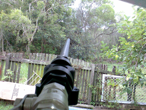

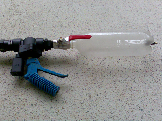

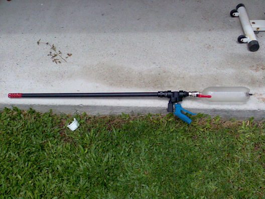

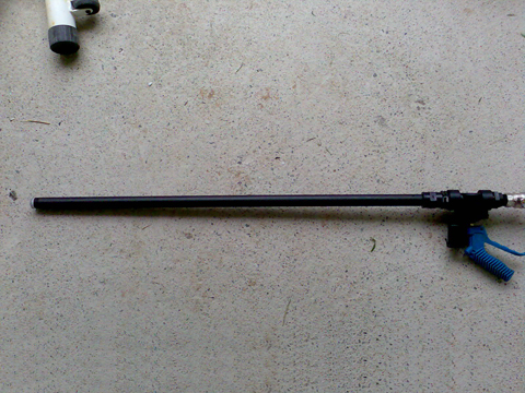

Hey guys, this is my second Pneumatic. I only just build it so at the momment it looks quite "Ghetto" without a decent paintjob and an overall clean up of the gun. Alot of people are gonna give me flack because im using a coke bottle as the chamber....but, I wanted to come up with a Marble Sniper that required absolutely no glue. So I came up with the idea to use Poly Pipe and fittings. Every piece on this sniper screws together which made it very easy to and quick to put together plus not to mention cheap. All up with all the parts, it probably cost me 30 bucks AUD. It fires at roughly 500 feet per sec at the momment (I have a really cheap Irrigation Valve that has a slow opening time plus the blowgun doesn't vent all that quick) so nothing special but well and truely good enough to destroy cans from a distance. I've got a better valve on the way. I'll get some good damage pics asap.
Thanks alot for looking,
Mitch.

That looks good... The only unsafe part might be the schrader in the bottle...
I like the blowgun you used
It looks ghetto? I have no idea what you're talking about, that thing is awesome, and looks great. Soda bottles are rated to 160 psi, so you shouldn't have a problem anyway.
Why is the blowgun in that position? Looks kind of awkward to shoot like that.
It's actually really comfortable to hold aye aye. I put it like that so I've got a curved grip like off a real rifle. I wanna get a small brass elbow so I can have the Blowgun attached the valve the right way round. I can imagine it'll be even more comfortable to shoot with the elbow. Yeah the soda bottles are great. I only go up to 115psi anyway so I got no hope of killing myself
