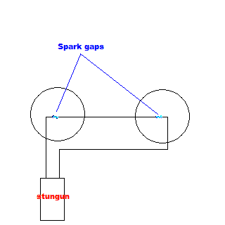

Recently i was asking for info on building a twin chamber combustion cannon. I am stuck again on the ignition part. I have a 100,000 volt stun gun ignition and i am trying to wire both chambers. I can't seem to figure out how i should wire both together any info would be great.

Just run a circuit between both of them. Ummm cant draw a diagram so I'll try and explain my idea. Set up the ignition on both sides as normal axcept instead of the wire coming back to the negative/positive terminals just connect a wire between one bolt on one chamber and another bolt on the other.

Please look at the wiki before you ask things like this. Im new so I dont get anoyed at questions yet but there are many who do.
That aside, I would wire the gaps like this:
- The circles are the combustion chambers.
- diag213.GIF (2.94 KiB) Viewed 3749 times

why dont you simply have two wires comeing from each node

I think this is the wiki entry you would be looking for. It doesnt explain your exact scenario but the same principles apply.
http://www.spudfiles.com/spud_wiki/inde ... park_strip
Edit: Imablackskater: you could wire them up either way, I just wired in series instead of parallel. I guess in parallel you get the same voltage but half the amps. In series you basically get half the voltage per gap, but being he's using 100kv that shouldnt be a problem.
And you use less wire.

Sorry, but I didnt know you only needed to know how far apart the wires should be. From how you worded the question it sounded like you needed help with the whole circuit.
(twitchtheaussie beat me to the reply cause I was drawing the diagram)
About the wiki link, a spark strip IS actually what the diagram depicts, but with part of the strip connecting the chambers.
Anyways, peace, and sorry for the confusion.
