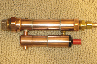

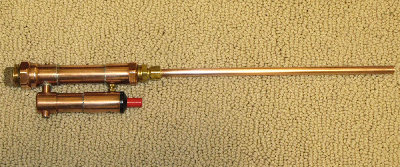

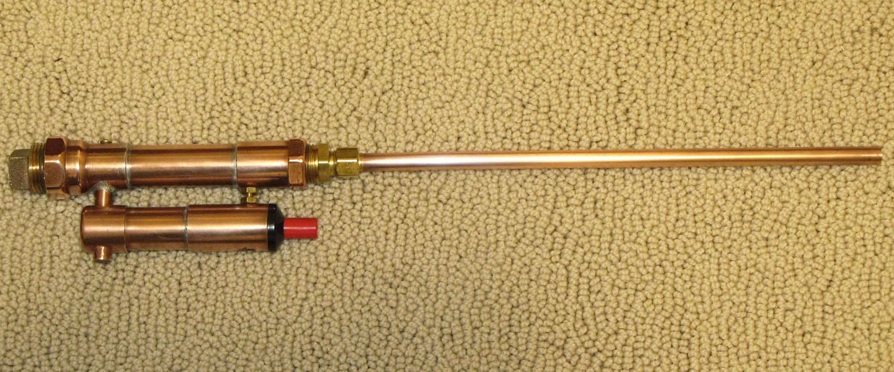

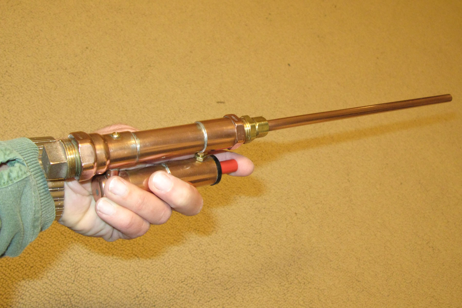

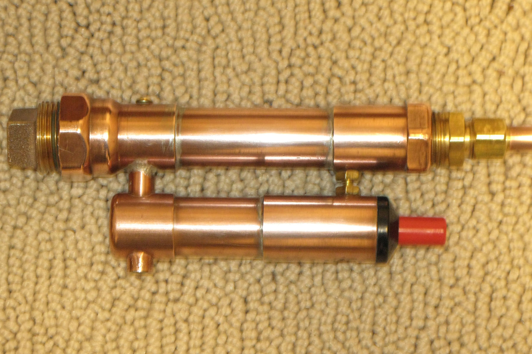

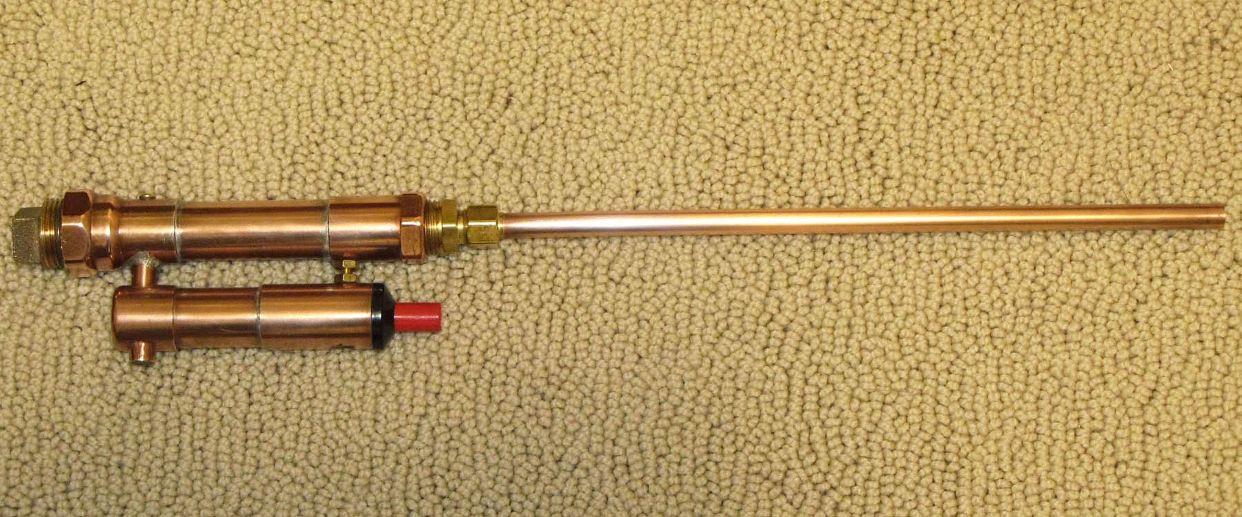

Hello,
This is my first cannon posted. It is a copper mini combustion with 1/4" diameter barrel. Good for shooting q-tips around the house using map gas as a propellant.

The C:B ratio looks out of wack though, I think it would be better with a larger chamber.

Insomniac wrote:The C:B ratio looks out of wack though, I think it would be better with a larger chamber.
The C:B ratio is not optimal. However, I wanted to keep the two tubes the same diameter and close in length to minimize the size.

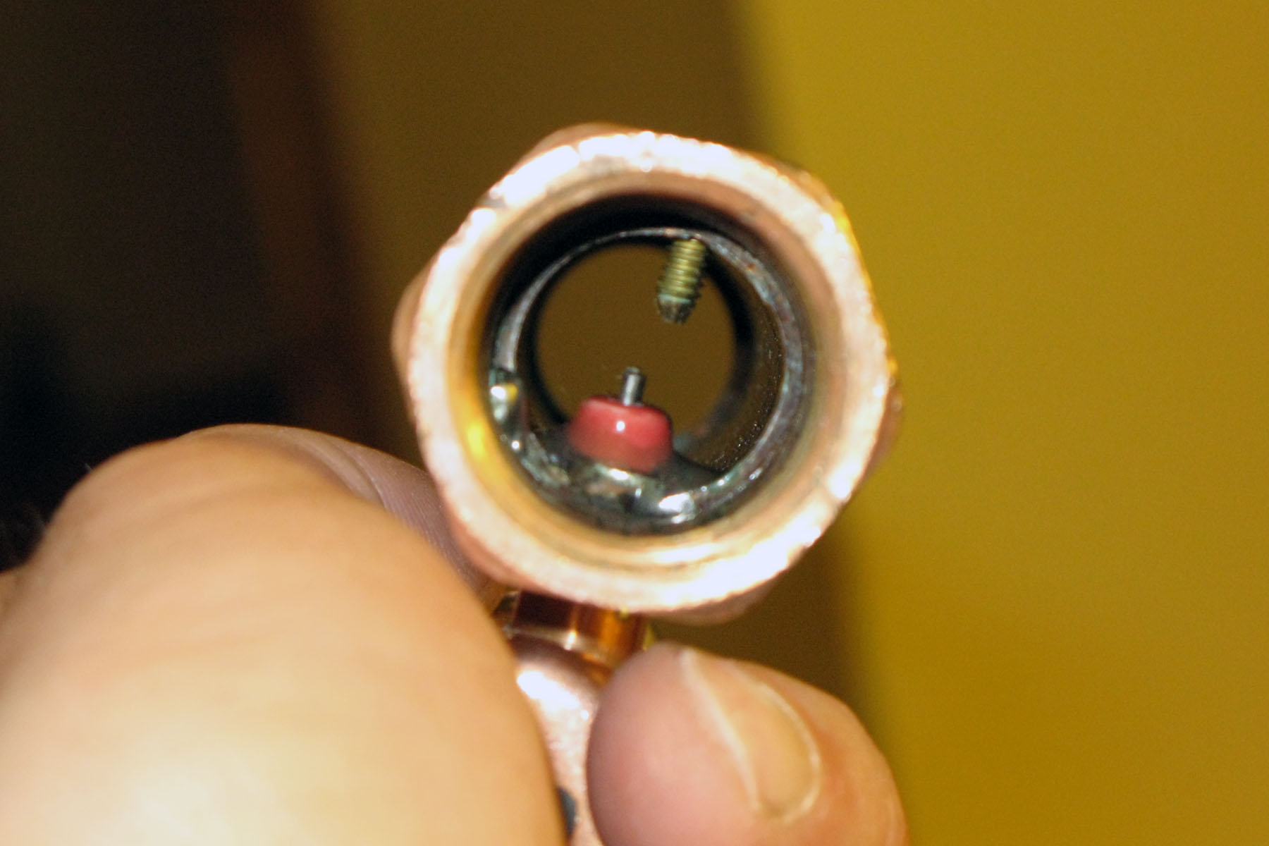

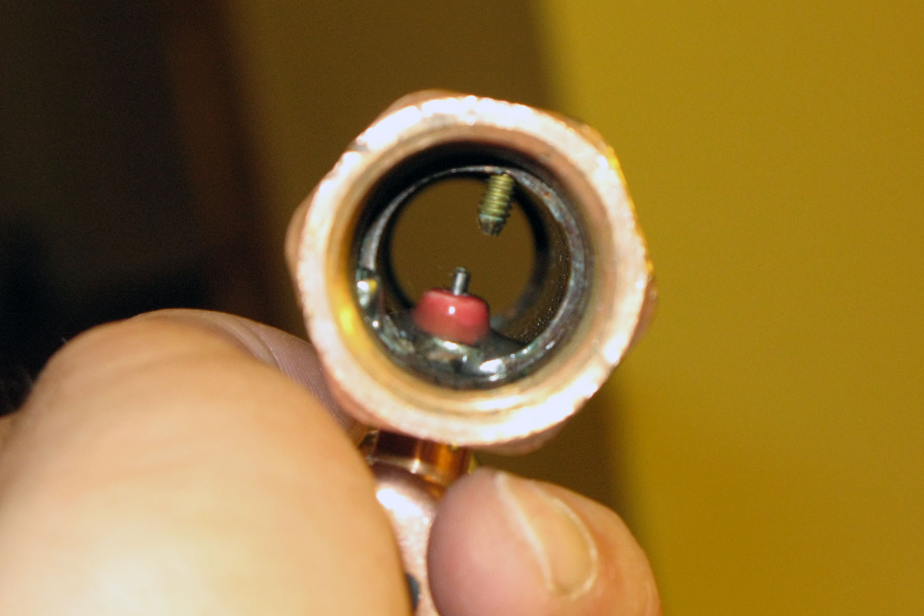

Very nice, what did u use to insolate the sparker
1700kPa
Posts: 5
Joined: Tue Mar 06, 2007 1:50 pm
I used the ceramic insulated electrode that came with the igniter. It is housed in the rear 1/4" connecting tube and was locked in place by filling the tube with J-B Weld.
