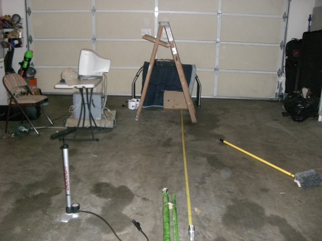

The tip of your barrel is placed exactly 10 feet from a piece of paper(suspended between two legs of a chair or whatever).
Use a audio splitter from your computer to two microphones, one place by your gun and one placed behind the piece of paper.
I used this model available from Target (and their website) for $9.99
next download the free software called Audacity http://audacity.sourceforge.net/
This program will allow you to record sound and then go back and select specific points in time. With the chrono set up, hit record and fire your gun from exactly 10 feet away at the piece of paper. When you review what you recorded it should look something like this.
Now select the very front/beginning of the first sound (gun firing) and drag it to the very front of the second sound(dart hitting paper). It should now tell you exactly how long it took for the dart to travel 10 feet, to the nearest .0001 second!
Do this 5 times for an average time and then go on to your next modification and see how much of a difference it made.

Here is a picture of the setup in my living room
The Homade Chronograph (accurate too!)
