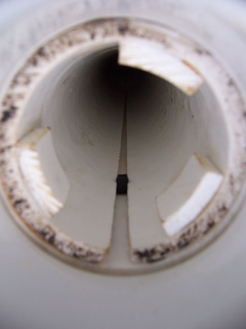

I took two pieces of sch 40 scrap 2 inch that I had laying around and quickly sleeved them together to make sure I could do it correctly before I did it for the actual barrel of my gun. I am glad now that I did. the barrel seems to be too small for the golf ball. I can force it through, but i really don't think this would be very practical for a barrel. The fit is way too tight. Do I need to wedge in a spacer in the gap of the inner pipe??

From other posts I have read, this is a plausible way to make a golfball barrel. I was just wondering if anyone else has run into this problem. In the second picture it looks as though the golfball would fit just fine on the vertical plane, but not on the horizontal. Does anyone know if this is caused by the gap i left in the inner pipe?? It seemed to me that cutting the strip out a little bigger than it needed to be would help make it easier to insert it into the other pipe.

easier to fit, yes, but it makes an eliptical shap, not a circular, as you have noticed and pointed out. So, yes; this was caused by the gap you left. That gap also allows air to pass by your projectile instaed of pushing it.

You can see that I also had a gap when I sleeved 2"PVC to make golf ball barrels. It might not show up in the photos, but I think the gap on my barrels was about half as much as the gap on yours. So I recommend trying it again, but remove a thinner strip of PVC from the inner pipe. With such a large gap, your inner barrel might not be able to lay evenly against the outer barrel.
Also, in the photos of your barrel, only one end is shown. What's happening on the other end? If the inner barrel sticks out from the end of the outer barrel, it can tend to pull apart. With your short test barrel, the effects of any distortion at one end of the barrel could have a big impact on the other end of the barrel.

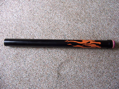

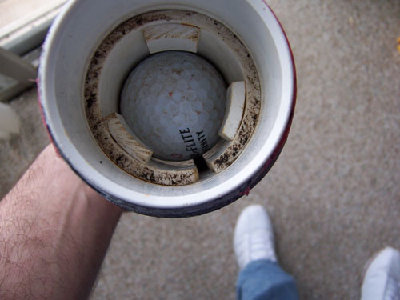

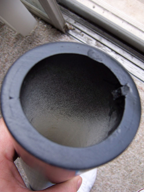

I thought I would share my experience again with 2" s40 pvc golf ball barrel sleeving. I used the plans by Foxx and had a devil of a time.
I made my cuts on a table saw which I had to cut and re-cut again until I was happy with the fit. I utilized hose clamps (2) to hold the cut pipe tightly together, then I started beating, and hammering, and pushing, and jumping, trying to defeat the seemingly impossible task. I noticed my hose clamps s-l-o-w-l-y micro metering their way down, I knew then that this was at least working.
I spent the next 40+ minutes working towards my goal and at one point broke about 1/3 of the pipe off. :cry: I used this to my advantage when I realized I was just going to have a shorter barrel, and my job was that much closer to being done!

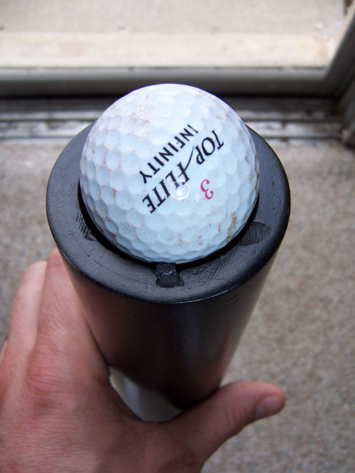

All in all, I'm happy with the final results. The proverbial 'gap' is non-existent for most of the length of the barrel. The gap that was left closest to the breech I used to wedge in a small piece of neoprene to hold the ball when loaded, it doesn't roll out. I also sanded down a few of the broken pieces of pvc and utilized them as a ball stop. At the muzzle end, I notched out a small area and JB welded (best stuff on earth) a small piece of neoprene in for a hop up. The balls fly straighter than ever, and far mind you.
Anyway, here are some pics. The handcrafted orange flames give it an overall kick-ass look when mounted on The Harley.
Muzzle end with no gap and hop up.
Breech end with gap & ball stops.  The discoloration is from a few combustion shots.
Ball being held in place.
