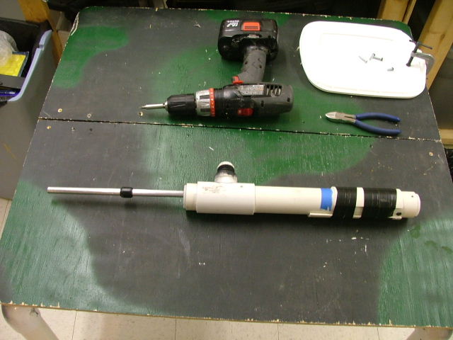

To maximise performance, use as long a barrel as possible and eliminate all the dead space in the BB reservoir. You can do this by having the BBs already in the pressurised chamber, passing through a ball valve through the barrel like so:
