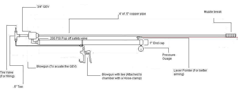

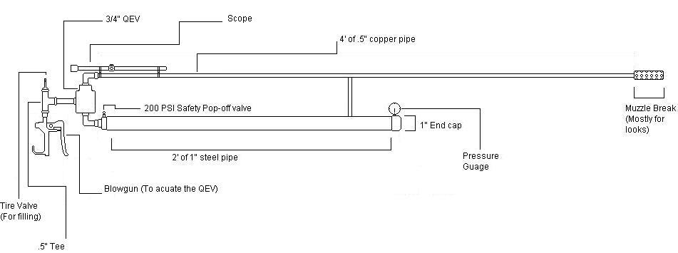

Well, i have been gone for a while and im hoping to be able to save up to build this marble sniper cannon soon, i made some plans for it in paint maybe you can check the out and give me some suggestions/comments before i start the build.
This will be an all metal gun, the chamber will be either 1" steel or black iron, and the barrel will be .5" copper.
(The 200 PSI Safety Pop-off valve is mostly so i don't blow the QEV wich the one i have is only rated up to 250 PSI.)
Im hoping to get this done soon, but the metal pipe around here is insanely expensive.
I got the basic design from Hotwired's Copperhead Prime wich is a good design, i just hope the .5" copper barrel will fit marbles as good as .5" black iron does.

Extrusion wrote:i just hope the .5" copper barrel will fit marbles as good as .5" black iron does.
Technically, if they have the same dimensions, it's irrelevant what the pipe is made out of...
Also, why do you need the 200 psi pop-off valve? Doesn't your pump have a gauge? Personally I think it's an unneccessary complication, after all just because your QEV is nominally rated for 250 psi, it doesn't mean it's going to explode when you hit 251 psi.
ShowNoMercy
Posts: 1094
Location: Jersey Bitches!
The ID for cast iron (which is what I think you wanna use?) is 0.622" for .5" nominal sizes. The ID for copper are, 0.527, 0.545 and 0.569 those are for the different types of copper. Im not sure what type of metal you are using but they dont match if you use cast iron.
Jesus saves, no need to pray
It seems you've lost your way
A-98
Posts: 921
Location: Santa Barbara, CA
one problem with the design, you need the schrader to be on the pilot side, it wont fill from the chamber.

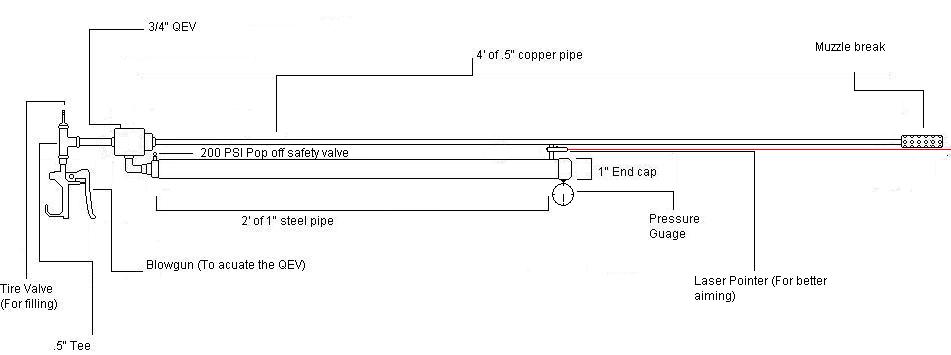

Here is the new concept i am thinking of.
I have also found a scope + scope rings that im almost sure i can somehow fit onto this, as for sighting it in i found a barrel laser (One of the things you fit into the barrel and turn it on and it shoots a laser beam out of the barrel) all i would have to do is put it in there and adjust the cross hairs onto the laser dot. :)
@Jacks
My air compressor fills my other pneumatic (with a 2', 2" chamber) up pretty fast, i know the QEV isnt going to explode the second i hit 251 PSI, but i just want it on there to feel safe, i don't see the problem with it really.
@ShowNoMercy
I'm talking about .5" black iron pipe, wich i use for a barrel on my other pneumatic cannon, it fits marbles well, but i don't think it is "cast iron".

A-98
Posts: 921
check this topic out. i have a few designs, and i have explained how qev's work pretty well (in the diagrams atleast).
the problem with your above gun is that the qev cannot be oriented like that. ill draw how it would be oriented in the type of cannon you want.
sorry for the lack of fittings, but you get the idea.

I tweaked the design a little, but found out that it wouldn't be very comfortable to use the scope with the tire valve sticking in my neck when i aim with it :lol: so i added a laser pointer mounted into the wooden barrel support.
-EDIT-
@noname
I thought about that, and tweaked the design yet again, i decided to add a tee to the blowgun and run some pressure-rated hose from where it was to where it is now, basicly i just put a tee onto the blow gun, then screwed a barbed hose adapter onto the other end of the tee, i did the same for the tee attached to the QEV, i would then use the tee coming from the QEV as a shoulder mount.
This is just a quick fix for my aiming problem, i'm a bit tired at the moment (11:00PM here)

Tweaked it some more, ill use the tee with the tire valve as a shoulder mount.
