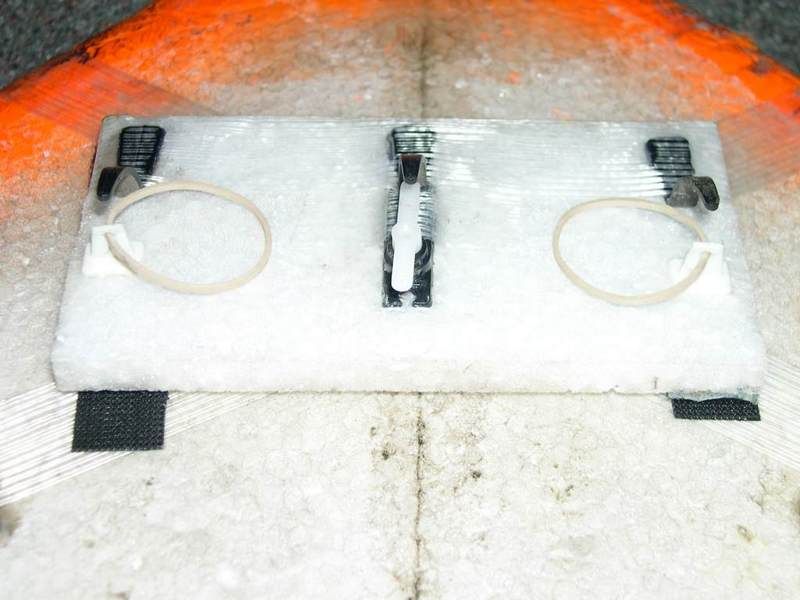

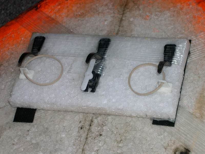

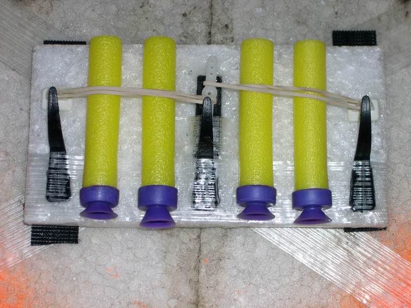

I was reading on another forum about the possibility of "air strikes" in an airsoft game and I remembered that I build this thing years ago.
Anyway, this is my "bomb" dropper. The idea is pretty simple. You have two rubber bands anchored at either end and stretched over a servo arm. The rubber bands keep tension on a few Nerf darts. When you flip the switch, the servo arms turn and release the bands and the bombs drop.

Noice! I should probsbly get around to making something like that. You should put pressureized chambers with pellets in them, then have them rain down at high speeds :D

Hey, thats cool, ill have to try that with my planes/ helicopter. I was trying to think of how i would get something like that to work and you showed me, thanks. Ill probly drop paint balls or something.

Ive got to admit, thats quite creative. The only thing Im concerned with is the practicality of air-strikes in an airsoft game. I mean it's cool and all, but it's not going to be very effective unless you have something like a nose mounted camera for dive bombing.
