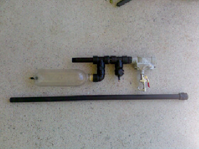

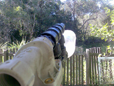

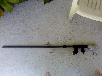

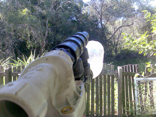

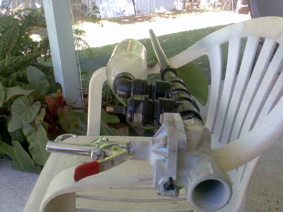

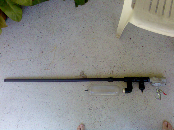

Hey guys,
This is my 3rd Pneumatic. Its a Barrel-Sealing Piston gun made from Poly Pipe and fittings with a coke bottle chamber. It goes from a very powerful Sawn-off to very very powerful Sniper with screwed on barrel extention. In sniper mode, at 110psi I can get roughly 703fps but I intend to make a Poly chamber and crack it to 160psi which gives me 802fps.

Very nice design.
What size porting is your piston? May I ask what you used for a piston material? I see it's vented by a 1" modified sprinkler, that must actuate the piston VERY quickly.
My only complaint is the schrader in the pop bottle, that would weaken it a bit I'd think...
I can't wait to see the polymer chamber, I hope it has much more volume than a coke bottle... a valve that nice deserves it
Keep in mind not to go over the sprinkler valve's rated pressure, or switch to a higher-rated pilot valve when you get the poly chamber.

Thanks alot for that Pete.
Yeah the bottle and the Sprinker Valve were from my old gun, hence why the Schrader is in the bottle. I'm going to get a brand new bottle and keep it completely intact concidering I fill it up from the Schrader next the Sprinker Valve so the new bottle should be alot stronger.
The piston is made from a rubber cork that fits perfectly inside the T. I have a soft Neoprene washer thats screwed onto it. I originally glued it on but when the piston opened, the 110psi just ripped it straight off and blew it out the barrel, but with the screw, it stays on perfectly
When I eventually do make the Poly chamber and crank it up to 160 or more psi, I'll remove the Sprinkler valve and just stick on a Modded Blow Gun. But I doubt I'd need to crank it much higher then 150psi really...the power I have now is more then enough to keep me satisfied for now

Is that sprinkler valve metal???
- killagorrila99
- Sergeant 2
- Posts: 1100
- Location: Australia.
So it's plastic, yet rated to 150 psi?
