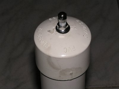

dude, i picked up this schrader valve from the local tire fitting shop for 4.50AUD:
works a treat easy as to install. just drill a snug hole, and insert the schrader.
final product:
installed on a 50mm end cap.
ArticWolf
Posts: 129
Joined: Sat Mar 10, 2007 7:18 am
Location: Greenville PA.
That set up is pretty much the same concept that Benstern and me were talking about. That will work too because it is techniclly bolted it good job on it and it looks good too
