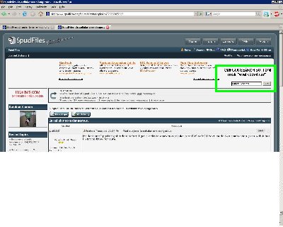

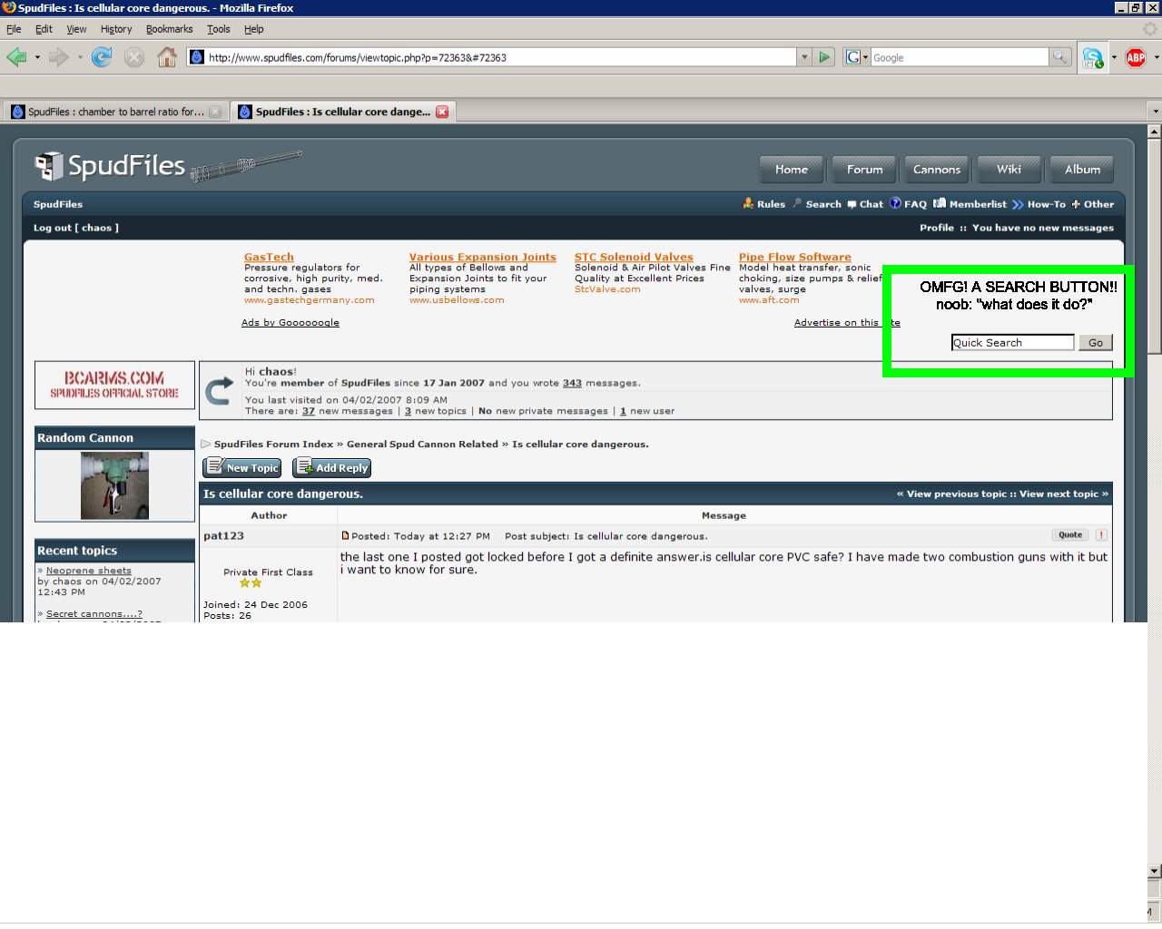

*thinking why it got locked* oh maybe because it has been answered a billion time b4.
Do Your Damn Research !!
