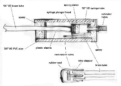

Yes it is, extremely versatile material - can be frustrating to work with but it does offer a lot of possibilities that standard fittings don't. It's not cheap, 9 lbs of the stuff cost me around $100 but I bought it 3 years ago and still have half the containers left so the cost per project is minimal.

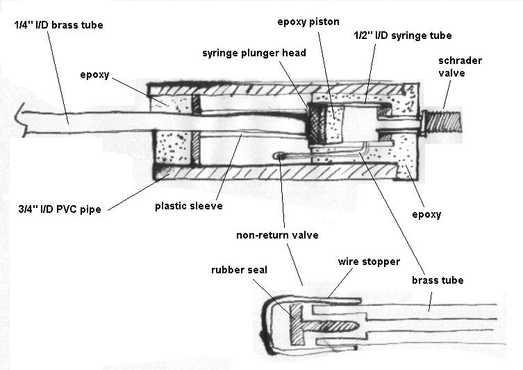

my current mini coaxial design, without the completely airtight piston which removes the need for an equalisation tube and check valve.

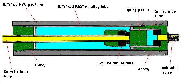

this is what the internals of the above coaxial look like
