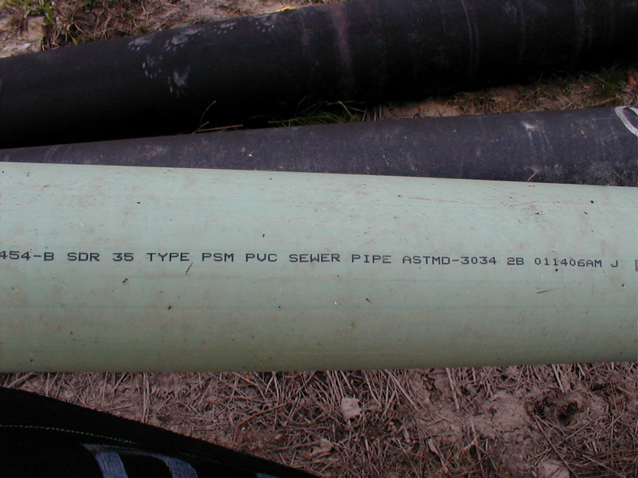

Does anyone know what kind of pipe this is?
- Posts: 375
- Joined: Sun Mar 18, 2007 4:22 pm
- Location: Illinios

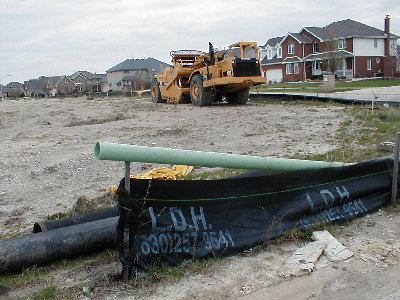

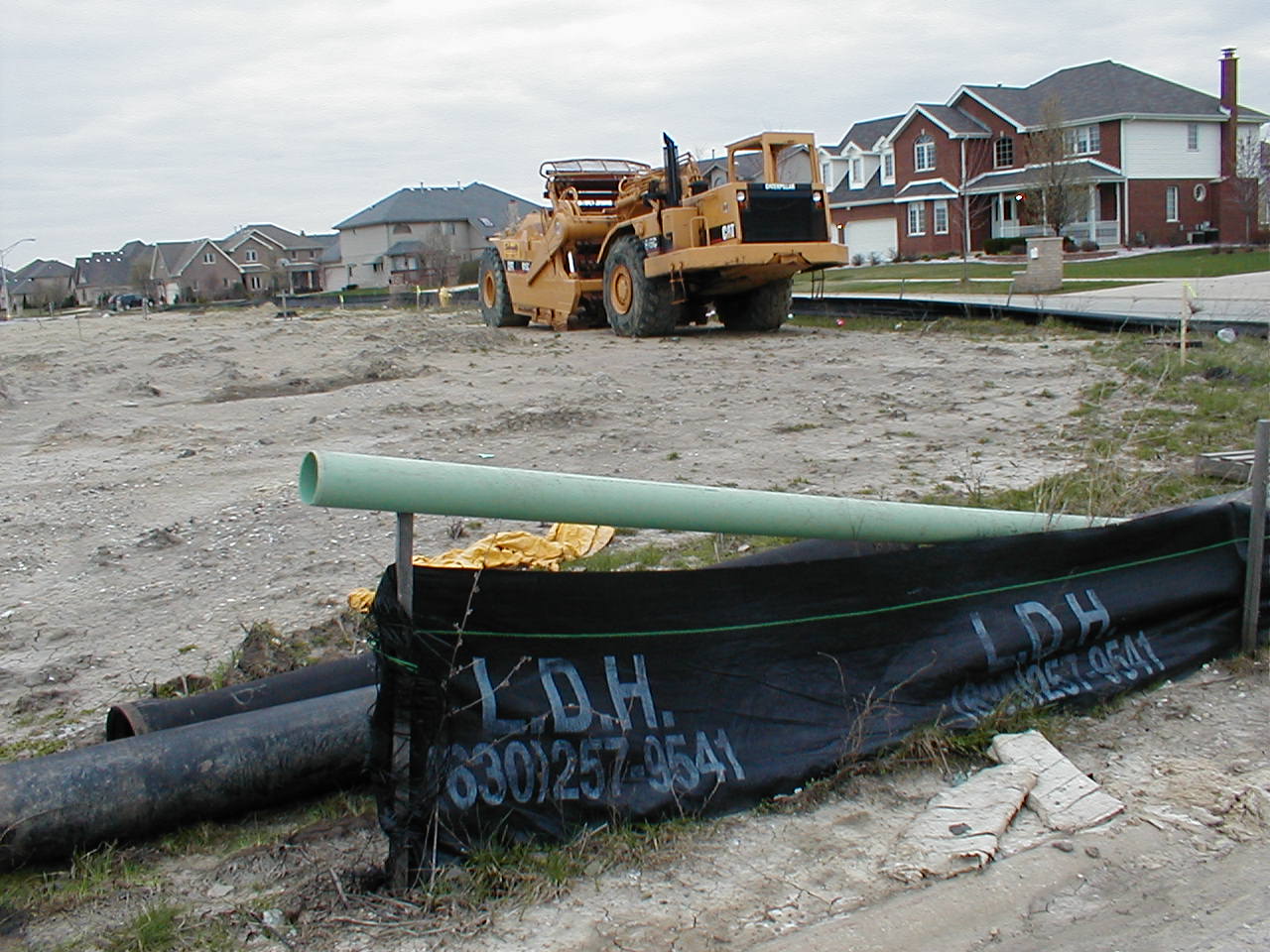

hey i found this pipe near a construction site that no one has worked on in forever. does anyone know what kind of pipe this is it is 4 inches by like 12 feet
it is like a sea green color and doesnt have much writing on it. i wanted to use it for a potato gun barrel or chamber but i need to know if i can use it. if anyone knows what kind of pipe it is please let me know!

Residentral sewer line, my cousin works with this all the time. He's a foreman for Comer Construction, Forest Hill, Md. Runs a utility pipe laying crew. Develeptments/commerical sites. Uses a lot of copper line when running house connections in new developments, 3/4" i think.

Rated to 46psi, I'd say no. A metered propane combustion gun can theoretically produce 82-86psi, this is too much of a pressure spike for pipe rated to 46.Specialist wrote:do any of you guys think i could use it for a combustion gun chamber? it would be great if i could cause then i could just take the pipe and no one would notice![]()
P.S. thanks for the table link ill use it!
Though there's continual debate on the topic, I prefer cellular core ABS for combustion guns - if it DOES fail, it rips clean with no shrapnel (as far as my testing can tell...). It's also dirt cheap.
NSF-PW PVC is always considered the best.
