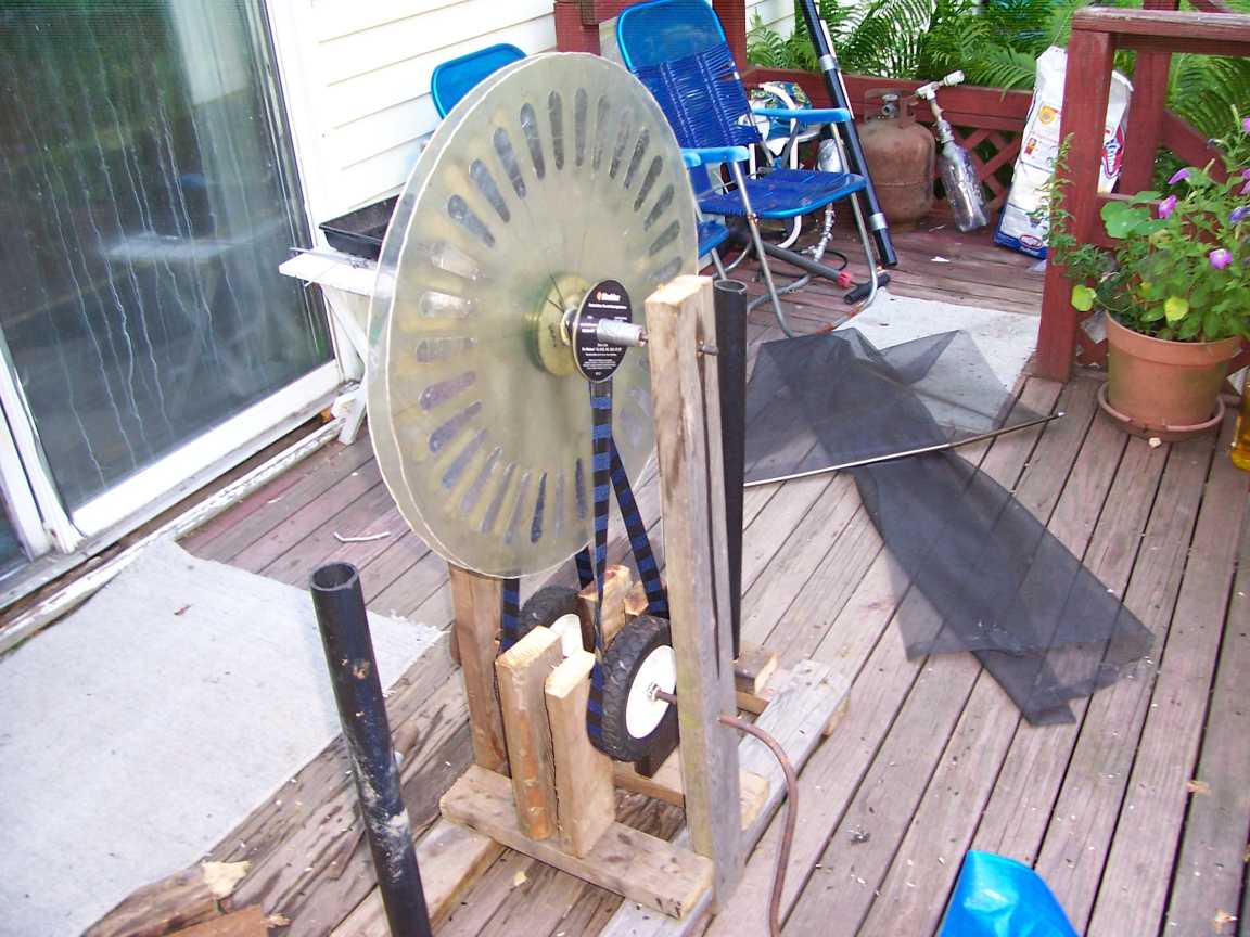

Has anyone ever done a wimshurst generator before? I have an unfinished one sitting on my porch which I hope to finish when summer comes around (Its too big to store inside; the plates are 2' in diameter).
Ill post a picture of it later.
This was taken last summer. Ive done a little more on it since then, but I dont feel like taking a new pic cause its cold outside now.<br /> I hope to make new plates for it soon as these are really crappy looking.
