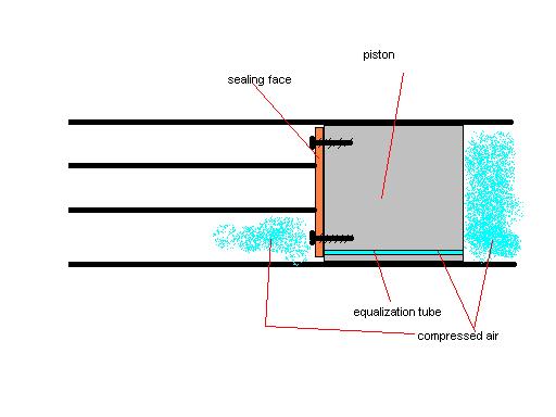

i have a few questions. i m building a coaxal and i need to know a few things about the piston
1. i have a idea for an equalization tube in my piston, it is covered in the front by the edge of the sealing face which i m hoping will act as a sort of check valve. do i need this or is there a better way of doing it?
2. the barrel is 1/2'' so i figure it would be better to put 4 screws towards the outer edge of the sealing face as to not interfere with the seal with the barrel p.s.(2'' chamber). would it be better to just put one screw and washer in the middle?
3. is it better to have a spring behind the piston?

1 just drill a small diameter hole for equalisation (sp?)
2 dunno
3 if you dont have a spring you should probably have a bumper

1. I like the equalization idea. Thats nice.
2. It depends on the psi of the rubber. If it can hold enough, you don't really need a screw there. I would just put one there anyway along with the screws around the barrel.
3. what mopherman said

are you sure an equalisation hole is needed?

jackssmirkingrevenge wrote:are you sure an equalisation hole is needed?
if he dosent have a equilization hole wont it jut pressurize behind the piston?
Been thanked: 350 times
lukemc wrote:if he dosent have a equilization hole wont it jut pressurize behind the piston?
Assuming the piston is 100% airtight, this will happen, but I doubt this is the case without o-rings

I've fastened rubber on the piston's sealing face with screws around the perimeter instead of the middle. The things to consider are:
1) The rubber has to be able to hold the pressure and not burst into the barrel, like "keep_it_real" said.
2) If the rubber is thin and flexible enough, it is somewhat difficult to keep it from bunching up in the middle.
P.S. Make sure the screws are either screwed into something solid or are really long because they can/will be pulled out when it fires.
P.P.S. Try to put washers on your screws so that the rubber won't be pulled off the screw heads.
