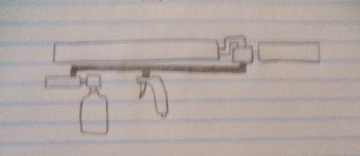

If you're planning on making a bazooka style launcher, try making a coaxial. For the chamber just use a 4' lentgh of 4" pvc, for the piston, use a 3" endcap, and for he sealing face, just attatch a rubber coupling onto the end of the barrel. You should also use a modified sprinkler valve to pilot the piston. If you want to add bazooka-style barrel flare, just attatch a 4" closet flange to the rear end,
Look at judgement_arms L.A.W.
its basically the perfect paintball cannon...
im making a cannon much like that actualy
use 2 inch sch40 for a barrel because u want to use nerf rockets
if you use a 4 inch pvc as the outside peice i would recommend making it about 40 inches give or take... thats how long an AT4 is so it is a good length ergonomicaly.. it will also give you more then enough performance so you can regulate your gun down to legal usage!!

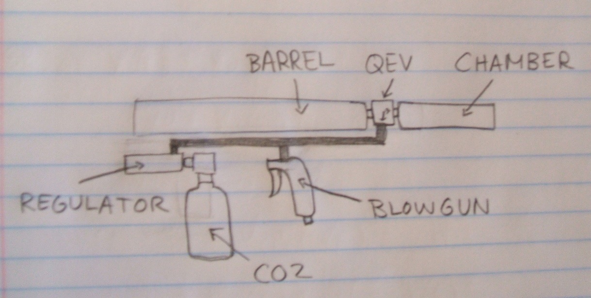

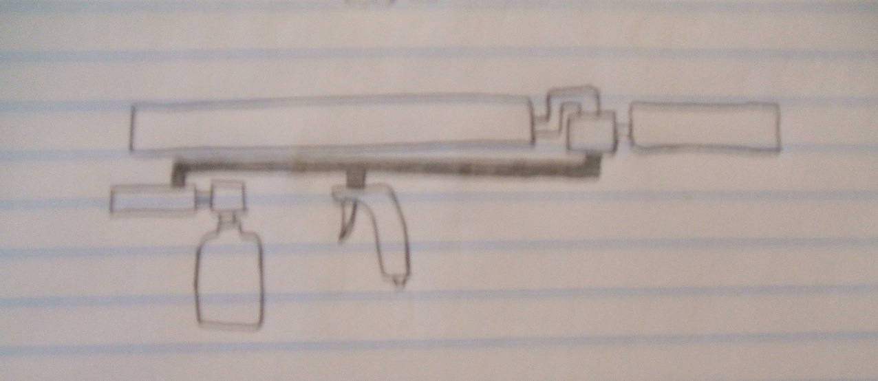

Actually, I like your setup better. you might want to make the chamber a little bigger though...
keep_it_real
- Posts: 320
- Joined: Sat Dec 23, 2006 4:41 pm
- Location: Bend, Oregon
You can't put the pilot valve and the co2 together like that. It might sorta work but the co2 will just go out the blow gun. Instead I would use a slide valve.
could i just put a ball valve inbetween the CO2 and the pilot valve that would get shutoff when the chamber filled? whats a slide valve?keep_it_real wrote:You can't put the pilot valve and the co2 together like that. It might sorta work but the co2 will just go out the blow gun. Instead I would use a slide valve.
keep_it_real
- Posts: 320
a slide valve will do exactly what you want. It pilots the valve when its back and lets air through to load the chamber when its forward.
go to http://www.mcmaster.com/ and look up sleeve valves (same as slide valve)
