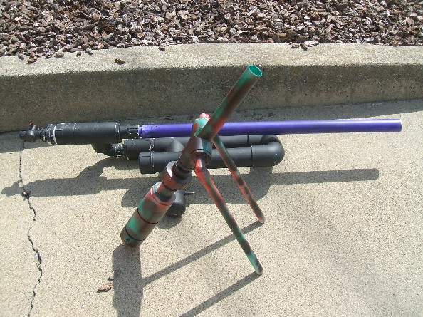

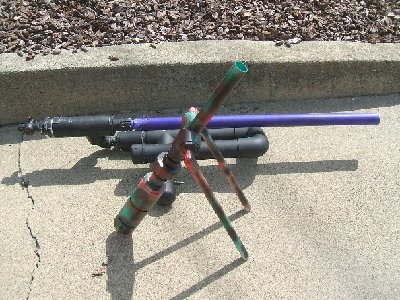

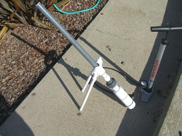

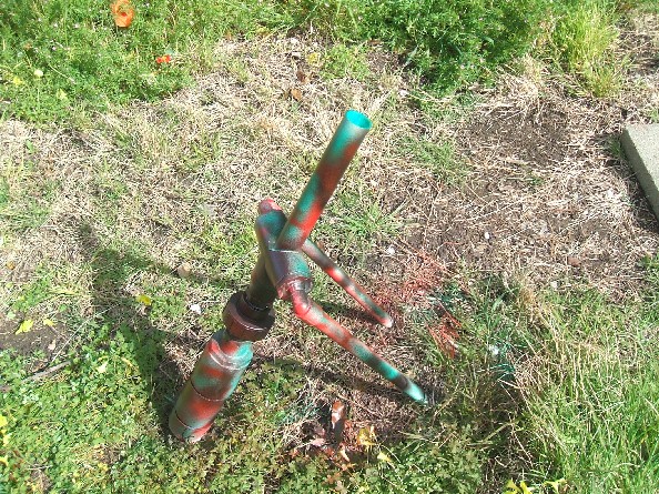

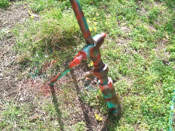

Well, this is just a burst disc cannon, and unfortuneately it's stronger than the barrel sealer 4 times its size.
Chamber: 1 foot of double layered 2" Sch 40
Barrel: 1 foot of 1" SDR 21
Valve: 1" Union
Burst Discs: Scored Playing Cards (thanks fnord)

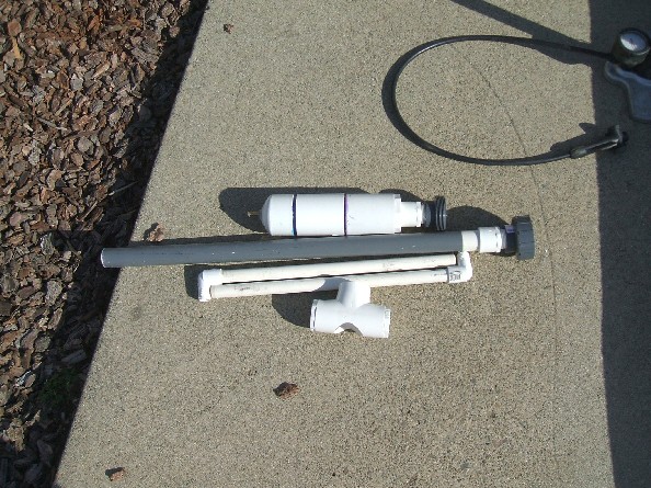

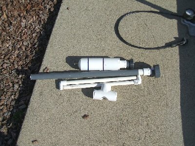

Detachable/collapsable/multi-angle stand
Extremely compact when disassembled
Ammo is 1/2" end caps filled with BBs or whatever with a screw in the bottom. Drop it down when the gun is pressurized and when the cap gets to the bottom of the barrel, it's blasted out.
Any questions, just ask.

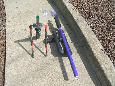

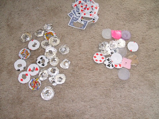

WOW......... that is one nice gun....but how does it go off when u drop the ammo down the barrel??? and one more question are the burst discs in your pic on the left used and on the right unused?? idk but some have holes in them so i was jsut wondering

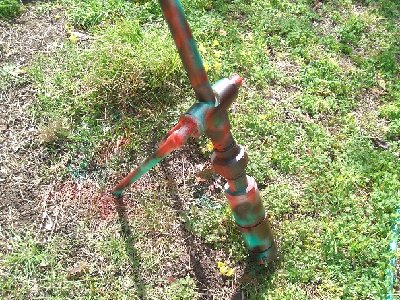

Nice paint job, what's the best way to paint camo?

Spudthug, the ones on the left burst successfully and the ones on the right didn't. It "goes off" because the ammo has a screw in the back of it, so it pokes a hole in the disc, then air rips it apart.
According to the CV listings on the SpudTech forum, a 1" union has twice the flow of a 1" sprinkler.
And yes, this gun does have crazy power. At the angle you see it, it will make a 2" long piece of dowel land about 100 yards away. Shooting an end ap "dart" at a 45 degree angle ends up with the dart about 250 yards away.
It's also loud enough to keep me from hearing anything for about 20 seconds after I shoot , and the blast echoes off the surrounding houses and makes all the dogs bark. I think I'll make another one, paint it black, and hide it in a bush to freak out little kids.
Jeez, this is what, the 4th edit?
The easiest way to paint camo is a base coat of the lightest color, or a color that doesn't show up when you paint it over darker colors. This was green in mine. I painted it green and red first, one can in each hand, just spraying randomly with both. When that coat was dry, I did it again. Lastly, I did a coat of black and red, and came out with the current paintjob.
As I was typing this, Flying Salt posted, sooo
They don't burst until I pop them (about 90-120 psi), unless I score lines on them with a nail.
ahh very clever a burst disk that is "popped" instead of broken. from your picture it looks like about half of the disks didnt work why is it that so many failed?

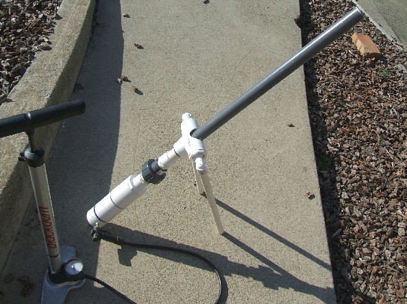

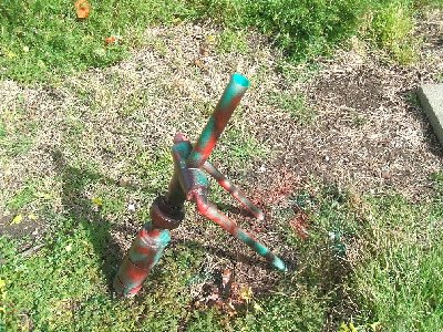

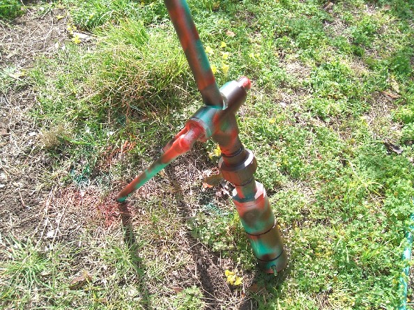

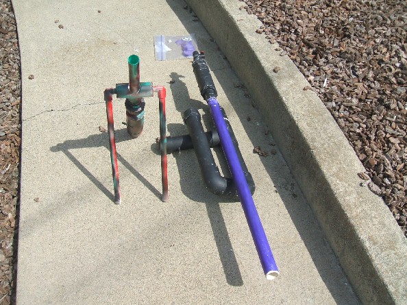

To anyone wondering about the stand:
It's a 1 1/4" T with a 1 1/2" hole in one side. There's a short piece of pipe in the lower socket to make it fit perfectly over the 1" barrel. The sides have 1 1/4" x 1/2" female threaded bushings. The legs are pieces of 1/2" Sch 40 with male threaded street elbows at each end, making it detachable/multi-angle.
