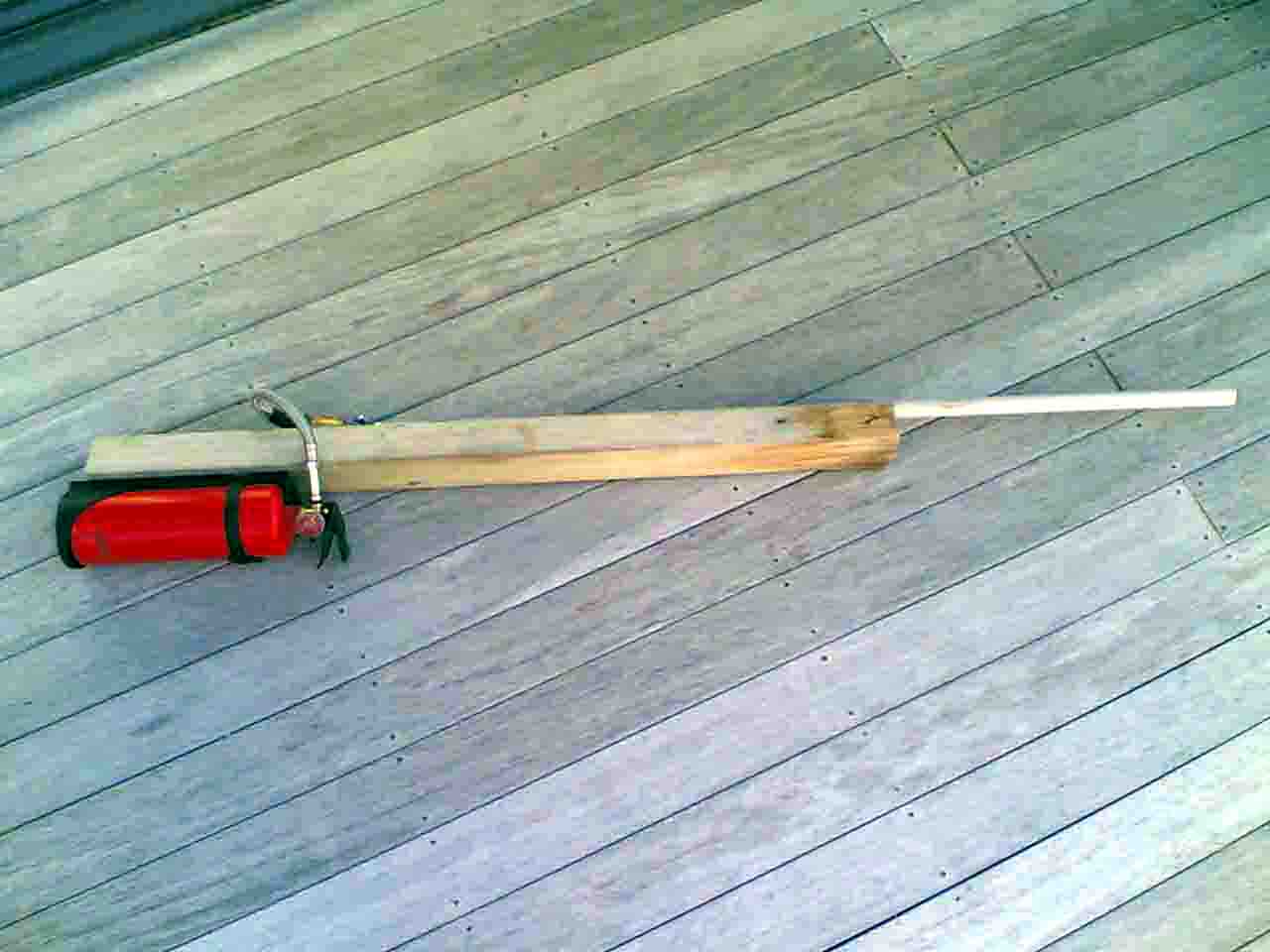

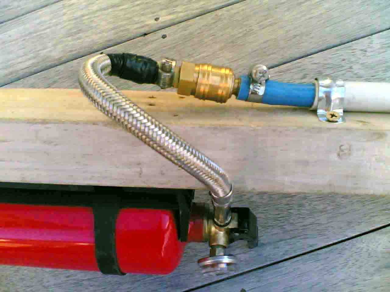

I made this one out of an old fire extinguisher, a 2 by 4 and some electrical pipe. This is as simple as it gets for using a fire extinguisher as a chamber.

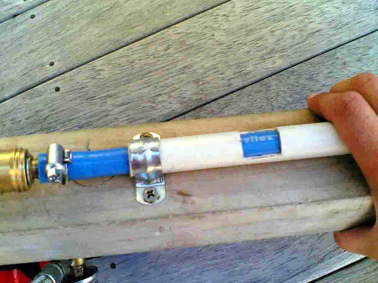

Since I didn't have the right tools to weld I decided to leave the valve on the fire extinguisher and use the gauge built into it. The flexible hose you see attached to the extinguisher is a... well I don't know what it is but I forced it into the extinguisher, no leaks even without plumbers tape. The barrel is electrical pipe, its not pressure rated but I have done tests on it to 150psi and it still holds strong.
To fill it, I detach the quick connect fitting and attach it to a DIY tire valve on a hose, then I pull the trigger on the extinguisher till it reaches 120psi.

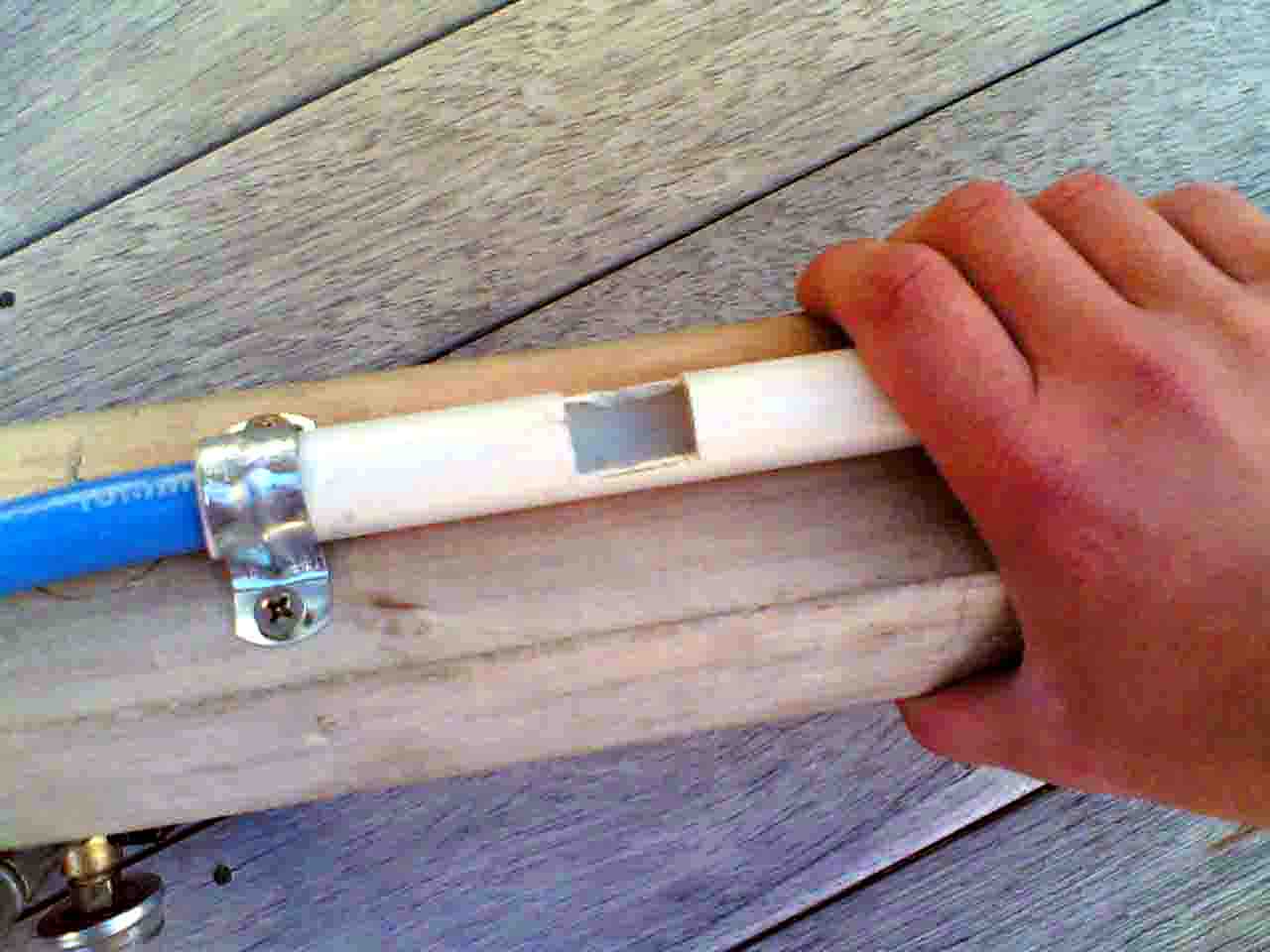

To load I pull the blue hose out of the barrel a bit so I can load marbles or grapes through the breech, then shove the hose back in.
To fire I detach it from the filling thingy and connect it back to the other thingy. Then squeeze the trigger while pressing your thumb down on the breech to stop the hose from flying out.

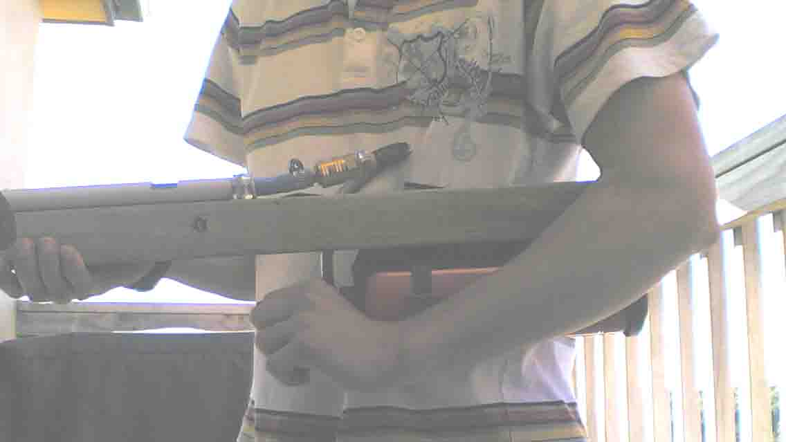

This is my friend sally
My awesome budget as trigger setup.
breech closed
breech closed
breech open, pile in the ammo
This is how you hold it.

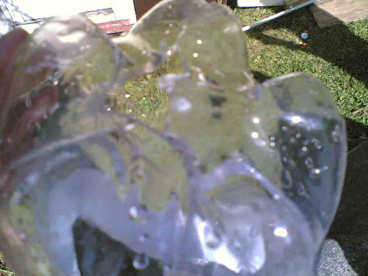

I thought It would be fun to fill a coke bottle up with water and shove it on the end of the barrel, with a marble loaded in it. Made a nice hole

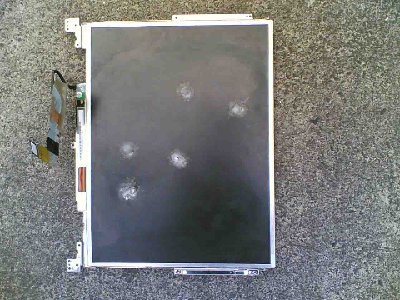

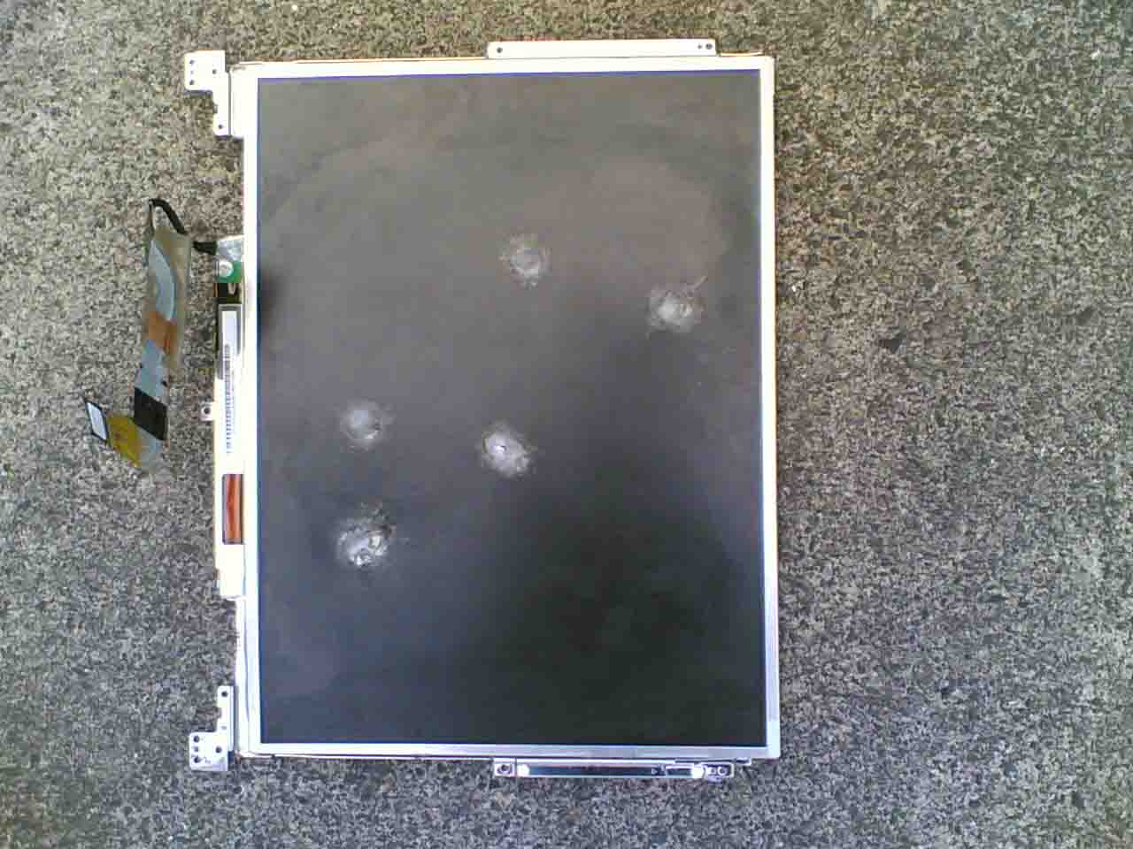

Shot some hard monkey apple type things at a laptop screen. Straight through.

lol, i like the breech. does the FE valve hold pressure? mine always had a slight leak so i trashed it. I also like your fill valve that doubles as how you conect the barrel. i guess that when you dont have much you have to bee creative. very nice. :wink:

No my FE doesnt leak at all and yes I do have a tip. Buy one of the FE's that have a black hose coming out of the nozzle that is used to aim the powder stuff. That way you can stick a hose barb of whatever size you want into it, its much easier than trying to find the right threads. If I wanted a really awesome gun I would not use a FE as the main chamber, I would probably use it to fill a smaller chamber because it is hard to get a good flow from one.

nice job on it man but i'd watch the hose clamps, they tend to blow off easy and anything blowing off is bad so be safe.
