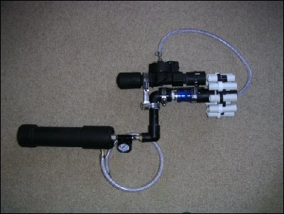

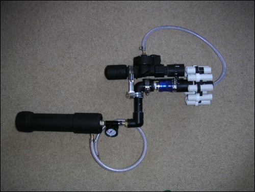

The first load is at 30 psi the second is around 50. I really don't know if thats right though because the regulator is a piece of crap.
This is around 70 psi I think. Ignore that kid that I called "chaseykin"
Description

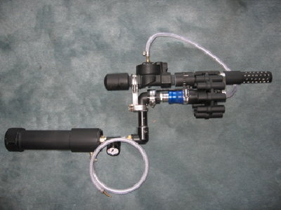

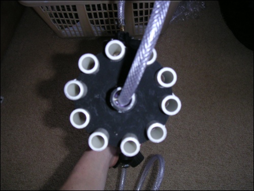

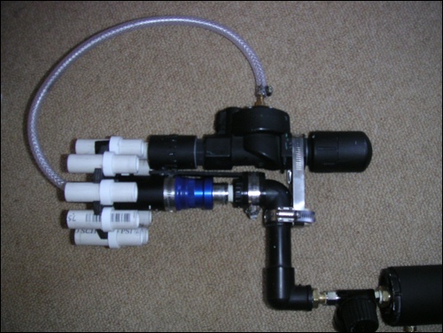

RevoSemi holds ten nerfs although the tank that's on there right now can only hold enough for about 5 or 6 good shots. I don't have a compressor so I can't show you it's full capacity. It took probably 1 and a half to 2 months to make (I kinda forget but it's been a while). There is a regulator on there between the main chamber and the firing chamber. All I can say is that the regulator is realllllyyy slow and inconsistent. Sometime I'll just invest in a co2 regulator from palmers pursuit but 90 bucks is a lot. Anyway, I'm still not clear on whether it's ok to use regulated co2 in pvc.

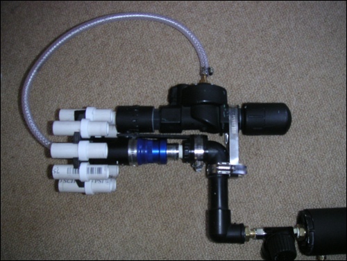

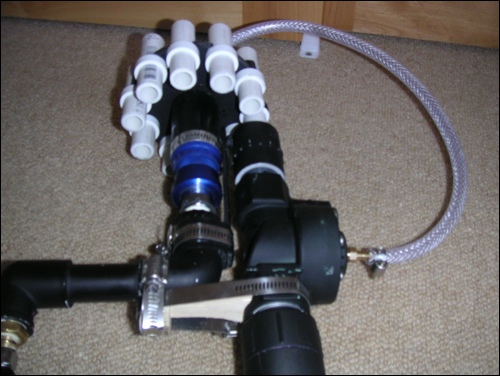

Surprisingly enough, I just winged this gun. The only thing I ever wrote down on paper was how the part that spins the revolving disk was going to work. I opened up a Nerf Maverick for some help on how it worked.
Heres my first prototype of the whatchyamacallit:
http://www.spudfiles.com/forums/revolver-t6497.html
That one didn't work. I made a new one that works ten times better. The only difference is there isn't as much space for the pin to slide around in. It's more of a track than teeth type things.
Stuff

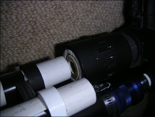

Sometimes I have a feeling to whether a gun will work and I can tell you, I wasn't feeling to good until I fired off the first shot and amazed myself (thanks for the quote "hi"). First, I couldn't get the whatchyamacallit thing to work, then I had to do countless hours of sanding/filing to get a small piece of 1/2" inside 3/4" inside, 1", which was inside a 1" coupler and viola! I had a piece that turned when you moved the slide valve. My next biggest problem was getting a some sort of good seal between the cartridge and the sprinkler valve. What I did was cut out a small piece of wood with a hole in it and sanded it down (took way too long) so that it fit inside 1" sch 40. So when the gun shoots the wood shoots forward and hits the cartridge and the air goes through the hole. Normally, the piece only has to move a tiny bit so not much air is wasted. The last problem was the actual barrel. I made this barrel that looked way cool. I modeled it after the Ultimate Inline II by neospud. Later, I figured out that that since I didn't have a seal between the cartridge and the barrel that there was too much friction and it slowed the nerf way down or it didn't even make it out. After some hours of deep thought, I realized this with a certain amount of duh factor and I reluctantly took the barrel off. It doesn't look quite as cool but it's frickin' sweet.

Yup, she's a beauty.
Ahhh
Ahhh
Wooden bolt with a hole in it. It works better than I thought it would.
Firing stuff. If/When I get a co2 regulator, I can take off the reservoir and it sort of turns into a 2 handed pistol (oxymoron)

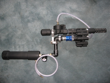

Revamped Revosemi
Revamped Revosemi

The only reason I'm not taking it up higher is because I'm scared of the wooden bolt breaking when it hits the cartridge. I thought about putting rubber on the front of the bolt but when the next cartridge comes around it would get stuck on the rubber. I rounded the bolt so this wouldn't happen.
On the other hand, I think I'm gonna go take another video with the pressure cranked up a bit.

Go to the link in my post under the design section. It shows a picture of the thing I made that turns the revolver. I made a better one than that though. It's just tighter. But yes, I pull back on the blue slide valve which shoots it and turns it a bit.
