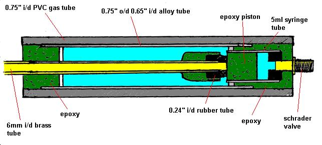

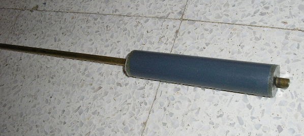

For smaller launchers, I think chamber volume is less important than PSI (although it should be considered, read on)
Have a look at what I had done with my HVBB launcher back on spudtech.
Here's the pictures as the don't show in the archived thread:
- HVBB extended chamber
- hvbbplus.JPG (17.57 KiB) Viewed 7034 times
- HVBB original configuration
- hvbb.JPG (32.48 KiB) Viewed 7034 times

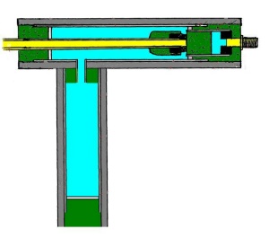

K thanks jackssmirking revenge and hi..Guys.. I have a really basic and seemingly stupid question here... In this piston design...which has been the most helpful to me..I can't figure out why the equalization hole would be through the center of the piston!
http://www.advancedspuds.com/valve2.htm
Okay sorry for the stupid question.....I've used search, both on this site and on the internet...Okay here goes..
1) So that fitting that is in the lower left- the one that looks like a reducer coupling.that is connected to the chamber...And then the upper part of the T goes to the barrel correct?
2) One more thing- I just plain forgot something..kind of embarrasing...In order for the piston to seal.....the equalization hole would have to be sealed for a little correct?? How would I do that?? Or would it provide sufficient pressure...Just by making the equalization hole small enough?? Or should I make some sort of valve??
K so sorry for all of these stupid questions...I just need this one little more bit of information to really get this concept into my head..
If your piston fits tight enough in the chamber (assuming a barrel sealer where the piston face seals against the breech end of the barrel, not a chamber sealer) you won't need o-rings or an equalisation hole.
i agree with jack, i dont have o rings or equlization holes on mine and they work. also, the equilization hole doesnt have to be in the center, it can be a narrow groove on the side.
it would be impossible to be right in the center because thats where the the bolt for the sealing face goes.

The reason it runs through th centr is because it's a chamber sealer. Look at the animation at the boottom of the page.
