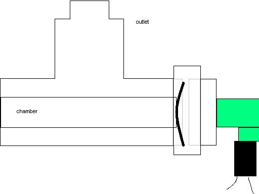

I'll build one of these for an upcoming cannon, but I just posted a diagram anyways.
According to some people, it's impossible to build a chamber sealing valve without O-rings. I proved you guys wrong when I thought this up on vacation. It probably won't have as good of flow as a barrel sealer would, but this makes it possible for me to use a Vogt pattern barrel. Credit partially goes to hi, becase he said a diaphragm is placed in a union. That made me think.
The valve is basically a barrel sealer with the diaphragm in a union, with an equilization port going into the chamber.

You prove us wrong when you build it and show it works. I can see a problem...

And exactly what is this problem you speak of?

Hawkeye wrote:You prove us wrong when you build it and show it works. I can see a problem...
Why not tell him what the problem is?
Anyways, I really like this design; it is incredibly unique, and it will open up all sorts of possibilities for those of us who can't build chamber sealing valves. Make sure to add a spring behind the diaphragm though to help it seal.

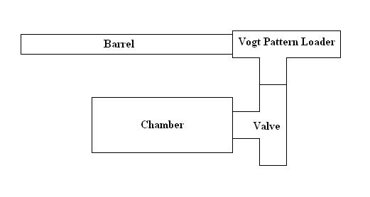

And BTW, couldn't you just make a Vogt pattern gun if you used a barrel sealing piston valve connected directly to the chamber with no 90* turn, and then attached the Vogt pattern assembly on top of that?

Rmich, thanks, I did forget the spring, although it may not need one because I'll fill through the pilot side. I couldn't use a barrel sealer in the configuration you're talking about because the chamber has a 180* turn in it, making it a "stationary cannon" type thing.

noname wrote:...the chamber has a 180* turn in it, making it a "stationary cannon" type thing...
I am not sure what you mean here.
<img src="http://www.spudfiles.com/uploader/uploa ... LOADER.JPG">
You couldn't just arrange the cannon like this? If you are planning on submitting your cannon for the contest, then I will just find out what you mean when the time comes.

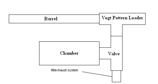

Exactly what I can't do. The bottom of the valve and the fill/exhaust system would get in the way.

When the diaphragm bows forward to seal the chamber will air not be able to leak around the edges? That would prevent the pilot from holding pressure wouldn't it?

Hawkeye, that's why it's in a union.

I wouldn't say there are a lot of chamber sealing sprinkler valves, but they certainly aren't rare. The jar-top Watermaster is fairly common and it's a chamber sealing valve, pics can be seen http://www.thehalls-in-bfe.com/GGDT/lib ... 1_mod.html
I'm pretty sure I've seen quite a few others as well, but I can't remember the models.
Your design should work as long as your diaphragm is strong enough and the union is tight enough, but since you have to make the chamber outlet go all the way through to the other side of the tee flow will be limited. IMO it would be worth it to try some of the various latheless o-ring groove methods and make a piston and have a bigger sealing port.
