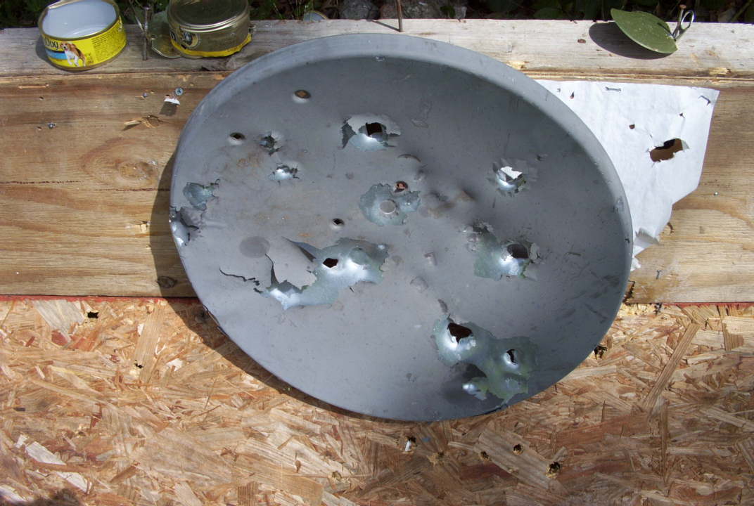

well, we have done some ser ious damage and it has been a lot of fun. Jake shot up all my potatoes while he was here for the weekend. t he dish is riddles with holes and you c an see that a few missed.
EDIT:Air cannons a re ve ry dangerous , especially if you use lead slugs made from fishing sinkers and lug nuts .pushed out the barrel by wooden dowels. One slug that we made to fit the barrell ,actually made a cookie cutter type hole in the half inch plywood.with the larger slugs the cannon had a lot of re coil . I have a light bruise on my face from the recoil I didn't expect..I have a shooting range and live out in the country ,or else I couldn't do this . My nephew Jake really eats this stuff up. but he shot up all my potatoes while he was sown for the weekend. He did however help me make the bulles for the cannon trials.

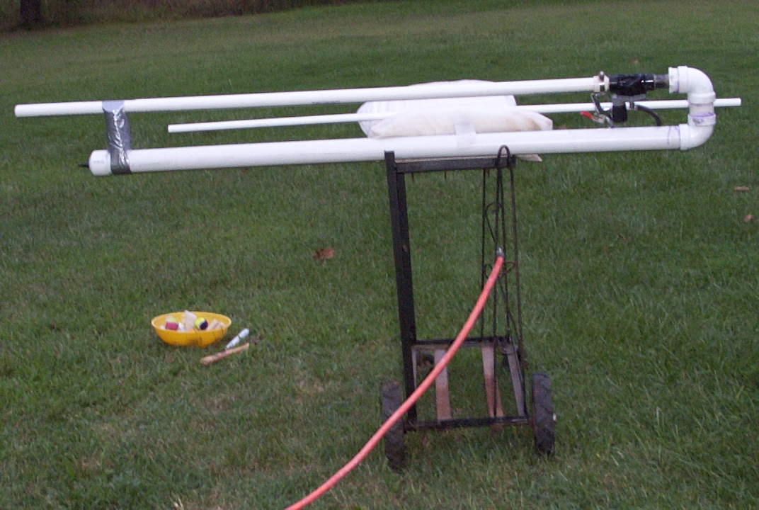

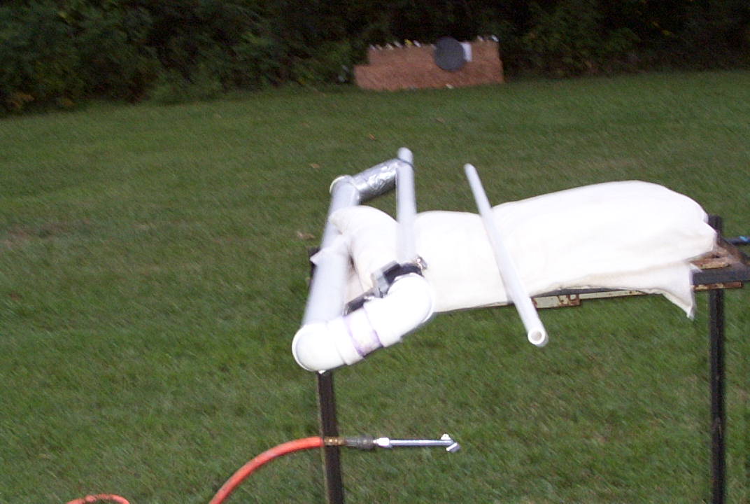

One I just built is an under over pneumatic ,a big one ,3" tank 2" barrel
I borrowed an Idea I saw here a few weeks ago and I built a power ram to open the 2" manual valve ,since I didn't want to spring for a 2" sprinkler valve.
It works better than I even thought it would ,it is so loud when it shoots that I lenghtened the barrel to 75" and it may need more.It seems to shoot about a quarter mile. The ram is opened via a blowgun which taps air from the cannons air tank. I built the ram out of 1 1/2" pvc ,a long bolt ,two washer ,two nuts, piece of ruber,two endcaps,one fitting to let air in. So far I have only launched potatoed in it but I have a tennis ball barrel that will fit it.
