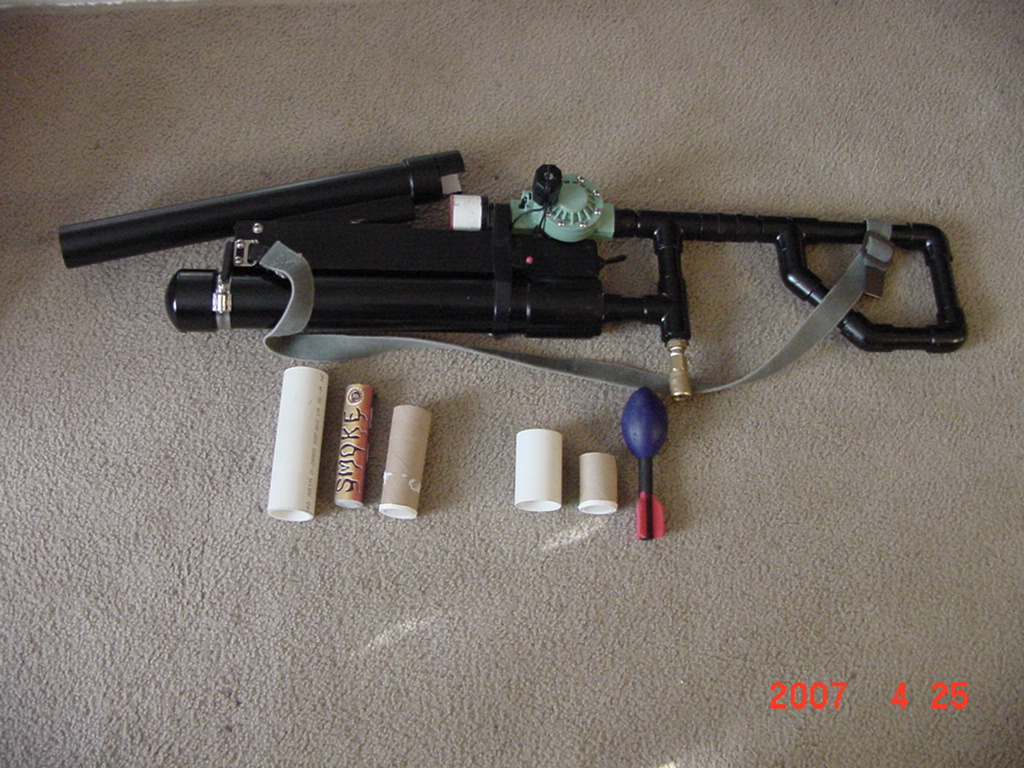

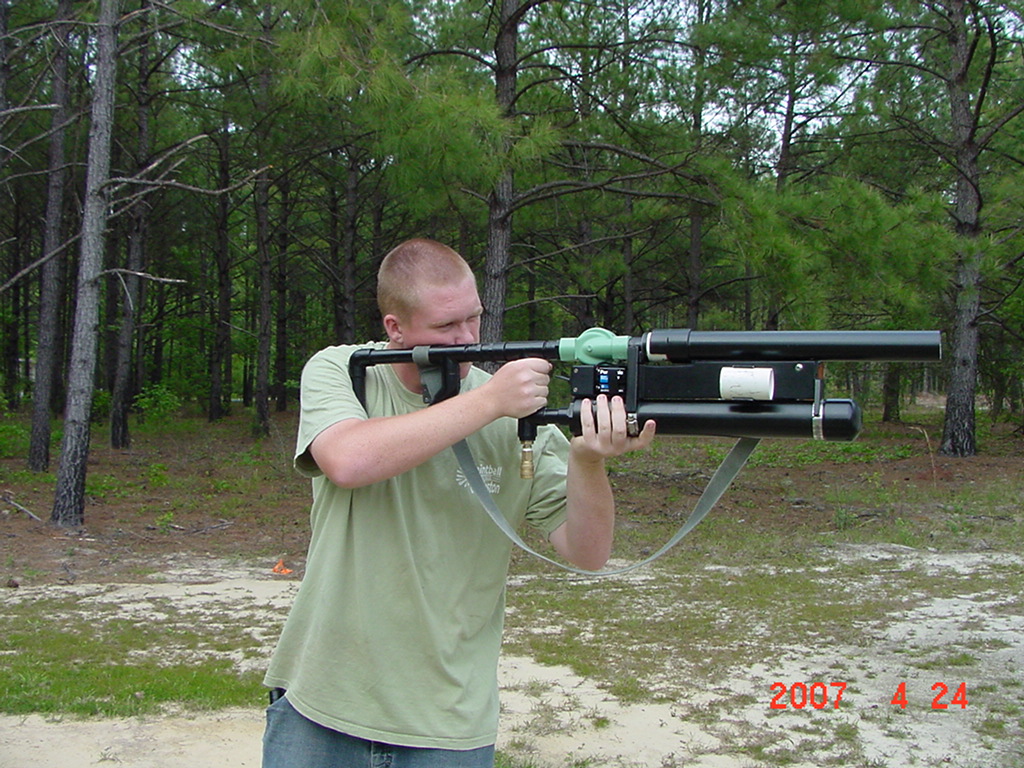

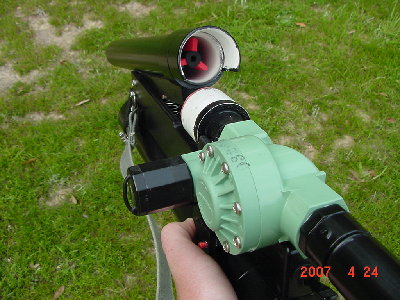

This baby has been my pride and joy for the past couple of months.I built it for use at paintball scenario games.I tank hunt so this is my prime weapon.So far I have been very succesful with it 20 confirmed tank kills in the last game.Not to shabby for the first time out.Hope ya'll enjoy and VOTE FOR GOAT!
Specs:
Overall length:40 1/2"
Air chamber:2" sch.40 18" long
Barrel:1 1/2" sch.40 18 1/2"
Valve: Standard sprinkler
Action: single shot
Operating pressure:80-145 psi.
Detachable stock(forgot to add earlier)
And a video of me loading in 5 sec.(sorry vid quality VERY BAD)
loaded football
loaded football

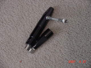

Ammumnition and respective cartridges.<br />Left to right:large cartridge,smoke grenade,24rd shotshell,half cartridge,12rd.shotshell,and nerf football.

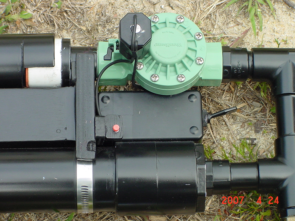

The fire control mechanism.The toggle is safety and red is fire

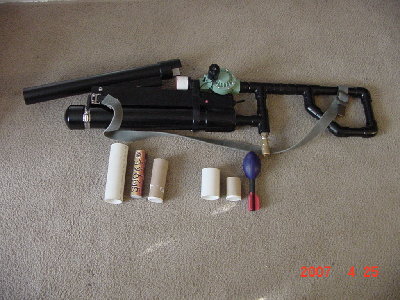

side view showing extra shell holder
Here is the beast........and the cannon

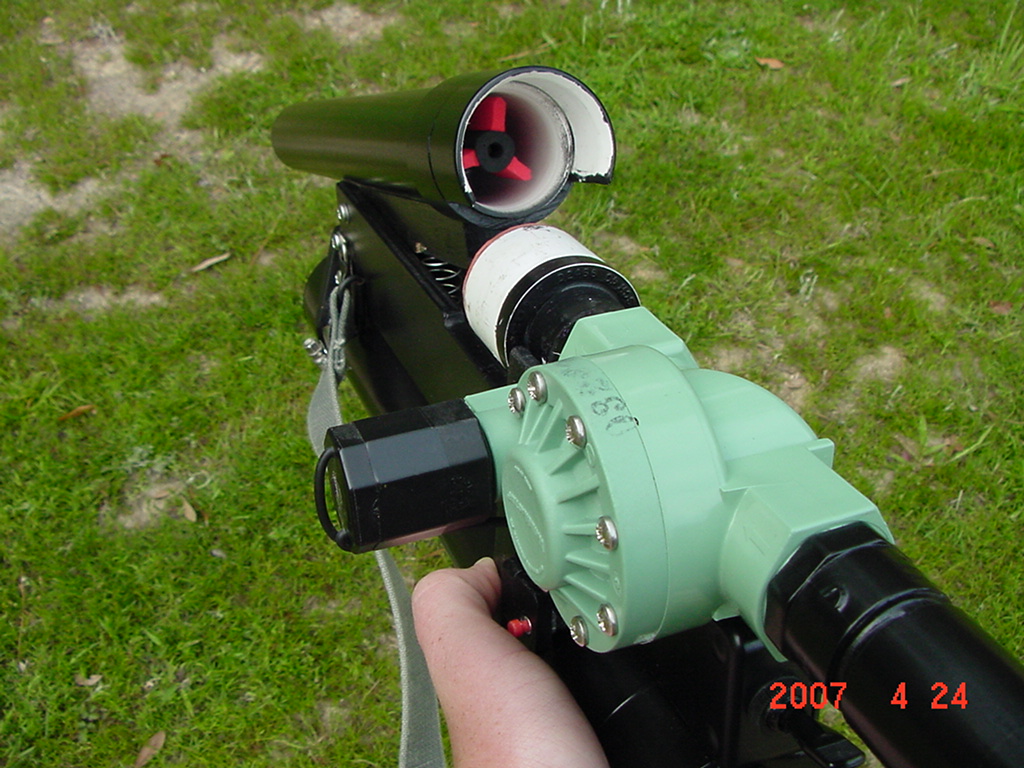

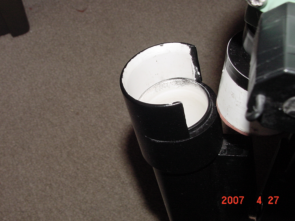

thats (sic). i really like your break-barrel. does it leak at all at the barrel when you shoot? what exactly did you do for the break barrel? if you dont mind telling :wink: . is it just a coupler? what ever it is i really like it.
goathunter
Posts: 675
Joined: Thu Feb 15, 2007 9:20 pm
Yeah about that :roll: The paint I used the first time around melted off when the paintball goo got on it.And I've been lazy and haven't put the marks on since I've repainted it.The barrel does have a union on it.I took a saw to it and cut it so as to make a clamp on the bushing.No it doesn't leak.I have a gasket on the bushing that seals against the barrel when it closes(the red thing under the union).

I like it. Never seen a loading system of that design, apparently works well, yet simple in operation, and design. Although I might be scared that the pressure may break the fitting on the barrel over the course of time. Very clean construction, to bad that is bound to go under the wheel in scenario play.
I noticed you mentioned that you sealed the "breaking barrel" joint with a gasket, and I noticed it in the photograph. Is there a chance you have a photograph with a alternative perspective displaying the gasketed connection? I am interested in how you made the joint exactly. Mainly how the sealing face was attached, and positioned.
I never saw it mentioned, but I assume you use some sort of CO2 regulating system in game play? Just interested as to how that works out.

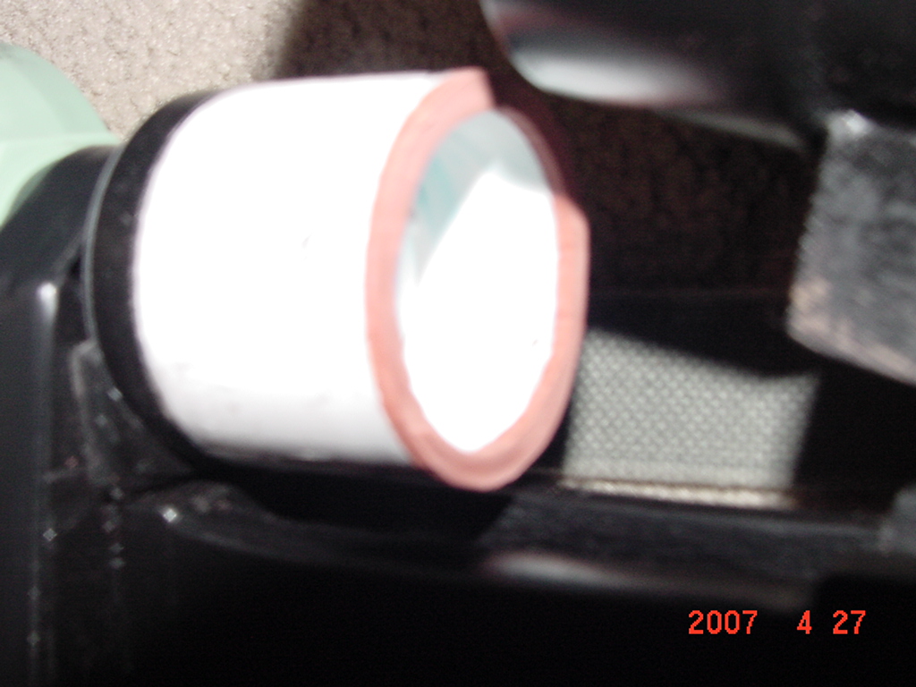

Pimpman, got the pics. The union sees no pressure from the gun.It is simply there to hold the barrel in place.The gasket is a piece of 1/8" gasket material that was super glued to the bushing face.I trimmed it down to fit properly.
Skinner,batteries for me are better.The original model was modified but after it broke i went back to electronic.Since field owners are obsessed with safety the ability to have a safety on the gun is a must.Second and most important is the fact of the valve can be repaired when I'm out of state.Total modularity.
inside of union. You can see the small ridge poking out from the bottom of the union,this is the barrel.Rather than use the union to seal the barrel.   The barrel pivots on the action and uses that for pressure against the gasket.The action is made out of glued marine plywood(not going to break anytime soon)
Picture of sealing face.The barrel not the coupler seals against it.
