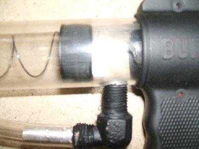

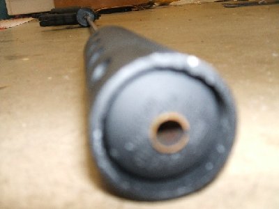

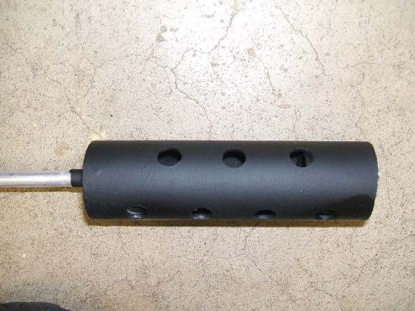

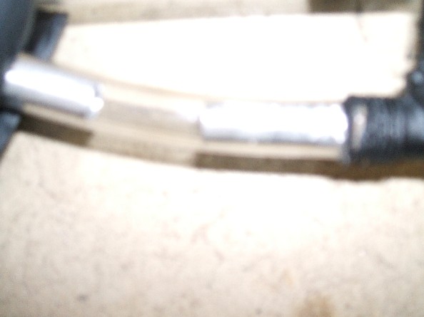

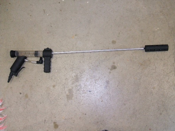

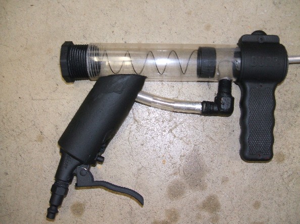

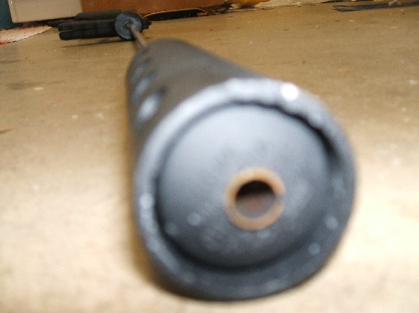

My newest airsoft strafer, thrown together for the competition. It utilizes a clear 1" SDR 21 chamber, a spring powered plunger, ghetto cut (but very clean) threads in the back, a 2 foot 9/32" brakeline barrel, a fake silencer that looks really kickass, a modified blowgun in a PVC handle, some clear epoxy, a clear vortex block with no shrouds and the front filed away for better feed, and some other stuff. It's about as strong as the Pocket Strafer but has a higher ROF and lasts longer (compared to the 1 second of firing out of the Pocket Strafer :lol: ).
Overall
Overall

The kickass silencer

The air feed system
The air feed system

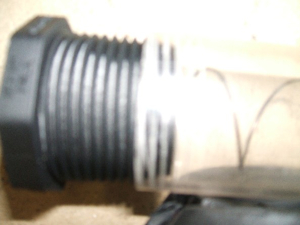

The self tapped plug, tapped without a tap

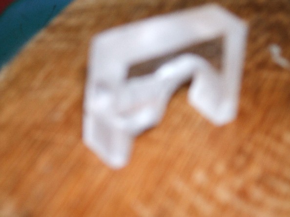

The vortex block
The vortex block

That is cool! It looks ghettoish but well made. How did you manage to get the brakeline that straight (i think it comes in rolls / not straight?)

I've seen it sold in rolls and straight; I got the straight kind. :wink:

Looks very nice! I really need to build a BBMG sometime soon (and if I do, it will be an inline vortex block).
This is a very clean gun; did you use a bottle cap for the plunger?
Those are pretty clean threads; for my upcoming project though, I am going to need to get a 2" tap :evil:

Yep, it's a soda bottle cap with expanding rubber to make it seal.
I have yet to buy a tap of any size! They're too expensive, I just ghetto tap all mine, though with this one I couldn't. A steel nipple was the same size though, so I heated the plastic to make it soft screwed the nipple in, heated, screwed in, etc., until I had enough threads.

i love the clear vortex block nice touch.is 9/32 better than 5/16? its 1/32" smaller so wouldnt it be too tight?

thats a cool gun. the barrel looks a bit ghetto.........i like the silencer

Pyrogeek, in my opinion, they're not, because you can do the same thing with a steel nipple of any size. No, I could not glue a female fitting on, because that would ruin it aesthetically and this pipe isn't even PVC, it's just a little bigger than 1" SDR 21.
LukeMC, 9/32" brakeline is the best you can get. From 50 feet with a 5/16" brakeline barrel, the spread with this gun is about a foot and a half. With 9/32," the spread is reduced to 6 inches. It's also a lot more powerful because there's almost no blowby.
ID of 9/32" brakeline: 6.03 mm
OD of BB: 5.93 mm
Spudthug, I could probably do most of the things you said, but no way would it be as small as a hand.
SoCalSiege, this gun was built from a Burp gun, which is this clear little gun thing that shoots Ping-Pong balls. I guess I had a different use in mind.....
XxtriviumxX, the barrel only looks ghetto because I didn't want to take another 30 minutes making a new vortex block because I drilled the exit hole a little low.
