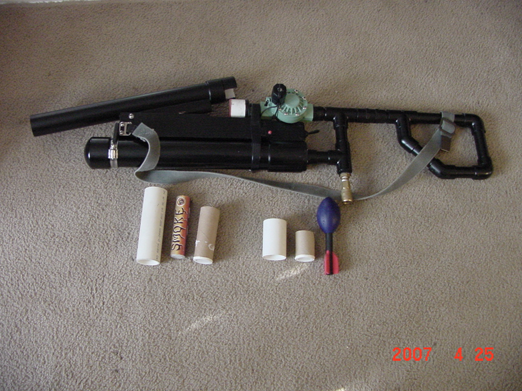

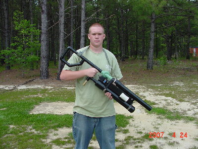

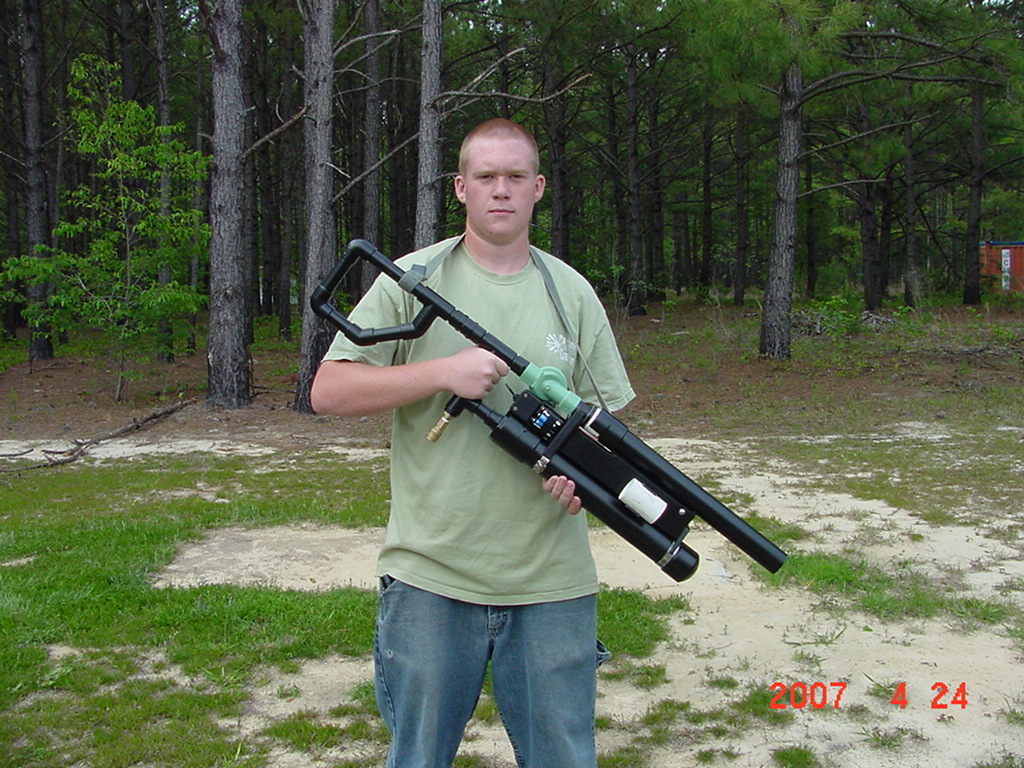

This baby has been my pride and joy for the past couple of months.I built it for use at paintball scenario games.I tank hunt so this is my prime weapon.So far I have been very succesful with it, 20 confirmed tank kills in the last game.Not to shabby for the first time out.Hope ya'll enjoy and VOTE FOR GOAT :D
Specs:
Overall length:40 1/2"
Air chamber:2" sch.40 18" long
Barrel:1 1/2" sch.40 18 1/2"
Valve: Standard sprinkler
Action:break open single shot
Operating pressure:80-145 psi.
Detachable stock
And a video of me loading in 5 sec.(sorry vid quality VERY BAD)

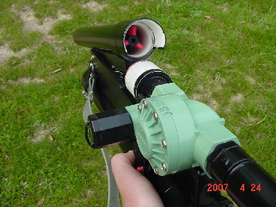

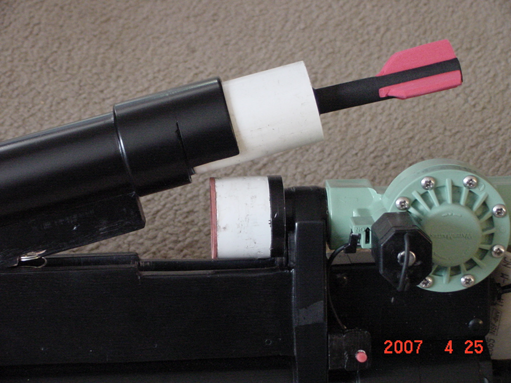

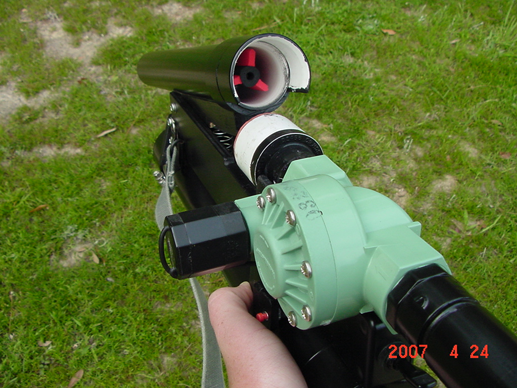

Cartridge in position to have ammunition loaded
loaded football
loaded football

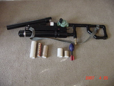

Ammumnition and respective cartridges.<br />Left to right:large cartridge,smoke grenade,24rd shotshell,half cartridge,12rd.shotshell,and nerf football.

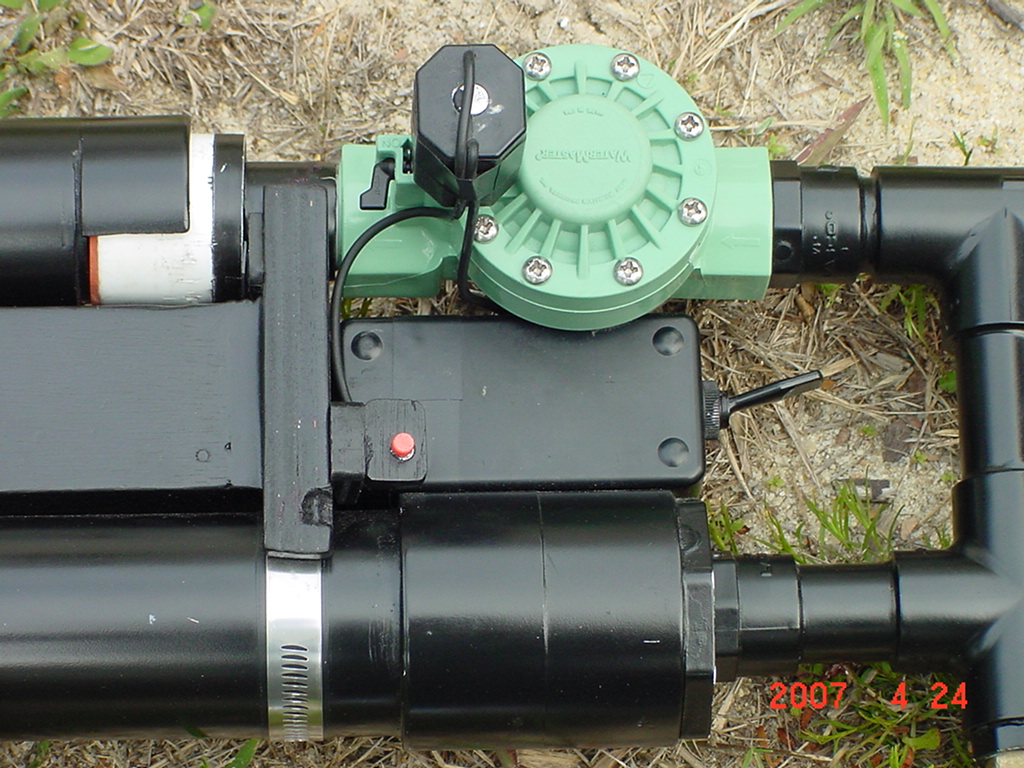

The fire control mechanism.The toggle is safety and red is fire.

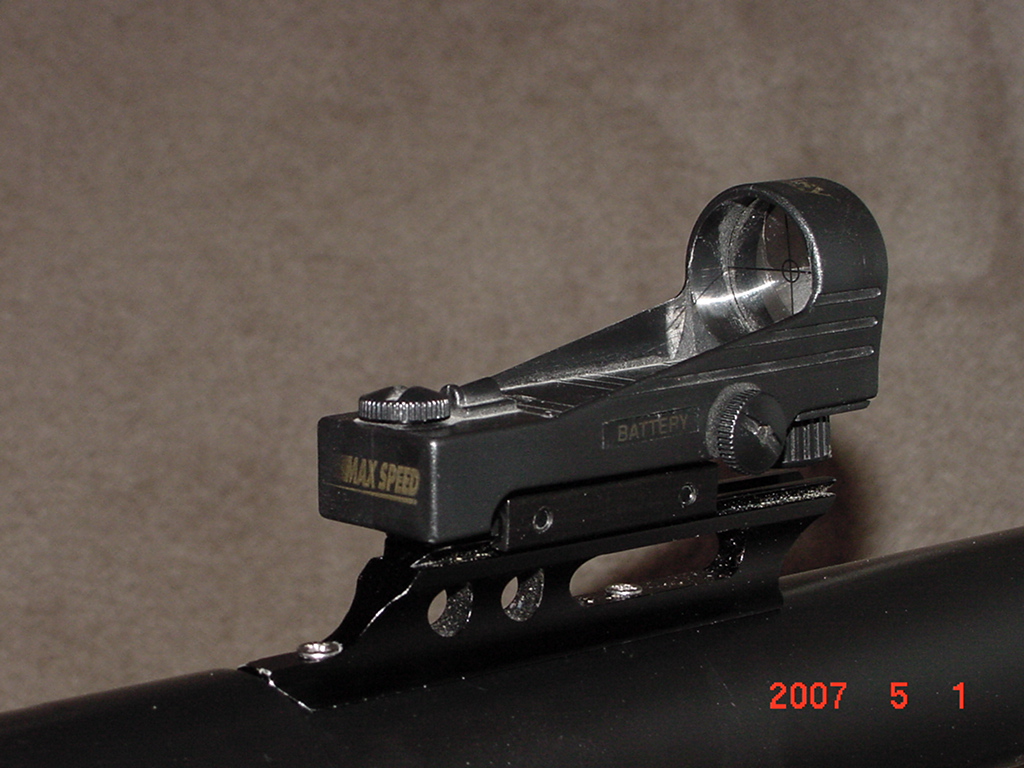

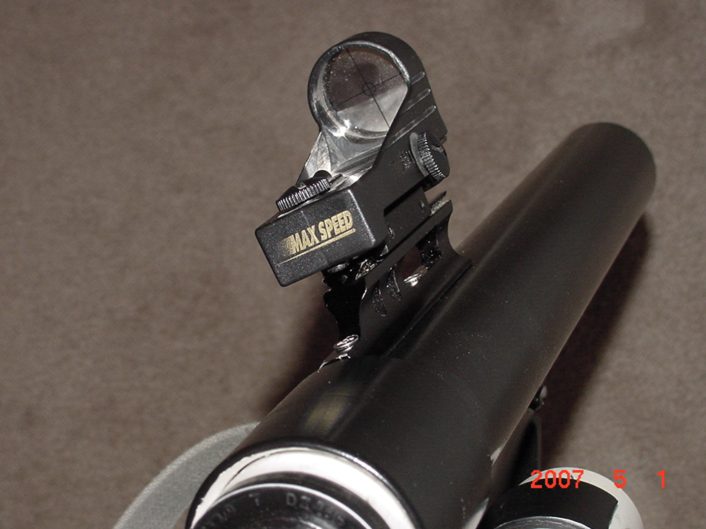

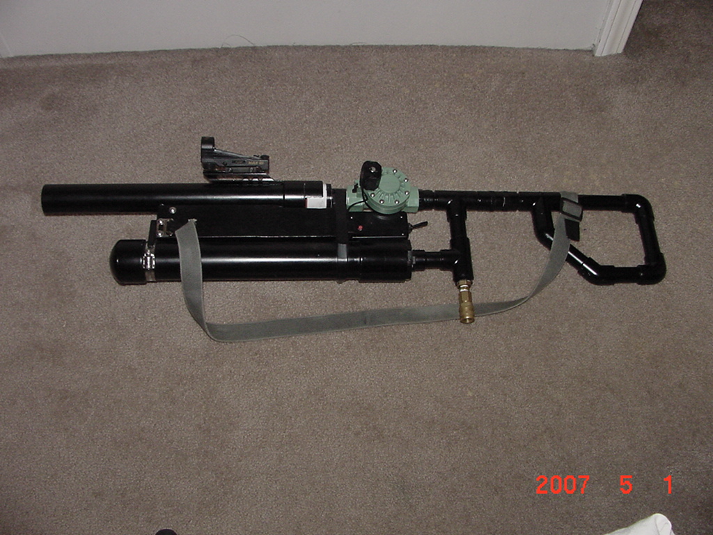

I know folks told me that I should put a sight on.Well, I did. So here is the Goat Gun with new sight rail.I found the rail in some old parts that came with my phantom.I drilled the barrel and screwed the sight rail down.
the sight rail and red dot sight
You can see here the sight is off center to accommodate a paintball mask.
The whole setup
The whole setup

The sight is horribly innacurate as i haven't sighted it in yet(batteries are dead,have to find replacements) :D
I doubt if it will compensate for anything over 30m(75 ft?) The football begins to seriously lob at that range.

Sorry Briar, I winged this gun.It's not that hard to figure out(KISS principle in action).The only thing worth noting is the female adapter were the stock screws in. The connector pipe(in between the adapter and T) is filled with JB weld to stop the stock from filling with air. That and the action is made out of 1/4" marine plywood.See if you can figure it out from the pics ,anything else just ask.
