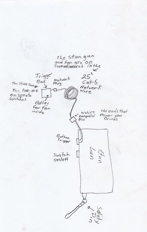

I drew this, this is pretty much the whole concept on paper I'm not good at explaining things I just do them when I think of them I didn't mean to confuse you hope this help's more

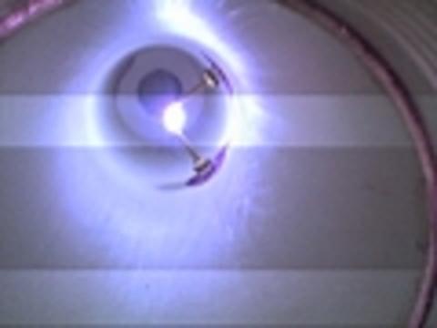

The stun gun is a 650kv wirered to a single spark gap, the gap is less then a 1/4"

- the spark it made at 1/4" gap no remote used
- Spark from Hell.jpg (11.42 KiB) Viewed 2693 times

Update I jumped the button and tryed to use the safety pin wire's still didn't work I checked the voltage when the gun is on and the voltage is like 3 volts it dropped big time I know the ethernet cable is to small but It looked cool oh well, it don't hurt to try lol. I'll have to try a bit heavyer duty wire like the 4 wire from a utility trailer it is i think 16 gage wire the wire's on the gun were small so I didn't think it would hurt to try but I think I'll have to power it seperatly, stun gun's can handle 12 volts dc at 1 amp right I figured the voltage drop was causing it not to work but I could be wrong.
Well I am going to just disconnect the battery's and disable the all switches and safety's on the stun gun. I will try to power it with a 12 volt DC power cord remotely through the trigger box to see if that will work. I checked the voltage with a volt meter and there is no drop through out the wire, I can power the fan that way so I dont see why I couldn't power the stun gun the same way. The wire like sandman said can handle 300 to 600 volts so pushing 12 volts at 3 amp's is nothing for the wire to handle it. If not I will use heavier wire but I still think the Network wire can do the work. But any advice will still help This is the way the trigger box is wired up after I get done soldering it up.
Edit: You have to click on the picture to see it right Don't know why it looks funny is here.
Update: I finally finished my trigger box network cable and all. It all work's, had to take the battery's and all switches and safety's out of the stun gun but I knew that I could get it to work. The only thing is that the battery for the trigger box isn't contained in the box no more it is a 12 Volt battery from a ride on electric four wheeler that plug's in to the box like a power cord for a laptop. The little plug to plug the network cable in is a surface mount one now no loose things to get snagged on, other than the wire for the battery but at 25 foot away from the cannon there's nothing to worry about will get pics up today some time till then just wanted to let you all know it is done and work's.
