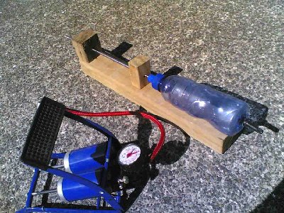

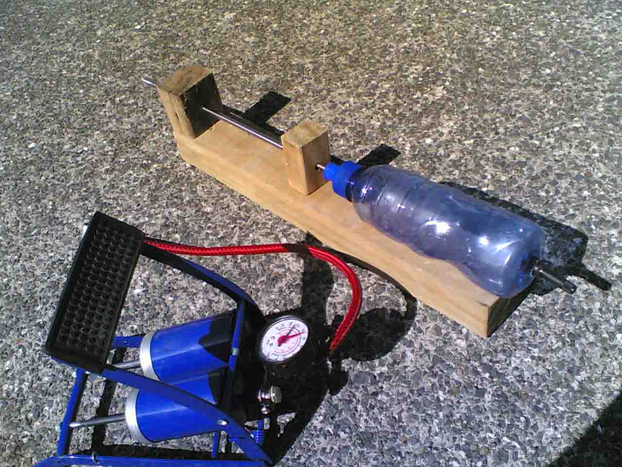

This is my prototype bb gun I just put together, it doesn't look like much, but it demonstrates the power of a drink bottle. I came up with the idea after failing many times to make a piston valve, I thought it would be simpler to have something similar but actuated mechanically.
It uses a water bottle as a chamber, the bottle top is the valve, and an aluminum barrel to fire 6mm bb's at 274 fps (thats as fast as a quality spring powered bb gun).
The drink bottle cap opens very quickly when there is pressure behind it, it just takes a little bit of force to actuate it.

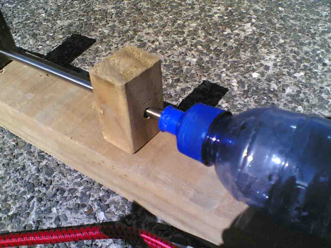

I couldnt find a good way to attach the end of the bottle cap to a barrel so i put the barrel in a fixed position through the wood. When I fire it, I hold the drink bottle behind the barrel (about 5mm away from barrel) and then open the cap, when the cap is fully open it connects up to the barrel so most of the air is directed down it. Some air escapes through the side but that doesn't matter because it is just a prototype.
At 10psi it will perform better than a $2 shop bb gun which fires at 48fps
At 20psi it performs better than my other crappy bb gun I made
At 30psi i recorded it at 63.1m/s (207 fps)
At 40psi i recorded it at 83.6m/s (274 fps)
I don't want to take it above 40psi because it is just a water bottle, not really made to hold pressure.
When i get the chance I will make a proper version, I hope to get over 500fps by:
Making a replica of the drink bottle top out of brass using a lathe
A smaller chamber at higher pressure
A built in mini shock pump
Creating a proper seal around the barrel
And making some kind of semi auto setup.
So tell me what you think about my design.

Close up while the valve is open

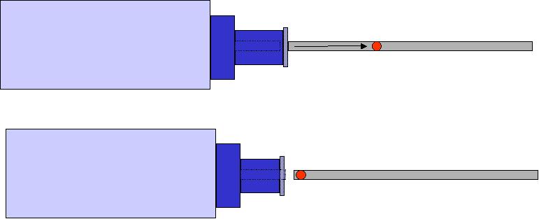

This diagram is a bit messed up. The top picture shows the valve open. The lower picture shows valve closed

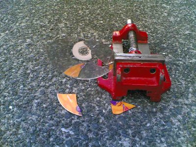

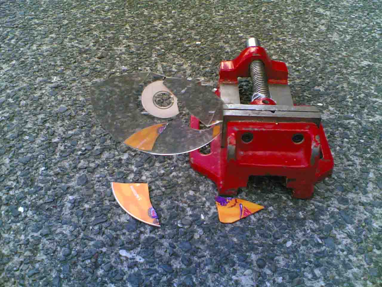

Damage. It will go through a cd and through a milk bottle but its not quite powerful enough to go through a can.

ive tried something similar to that, the pop lids cant hold that much pressure

nice. . you should use a pop bottle. they will hold 120 psi

cool only 40psi and 247fps? that a good result
BTW nice pump you got there
A-98
Posts: 921
Location: Santa Barbara, CA
ummm...why does your pump say something like 40 psi, and yet its not connected to the gun?
shud_b_rite
Posts: 290
Joined: Tue Jan 30, 2007 7:10 pm
Because the needle on it wont go below 30psi anymore for some reason. I use a different tire pressure guage checker thing to check the pressure of my cannons.
