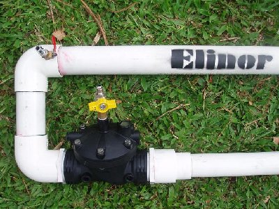

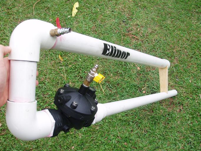

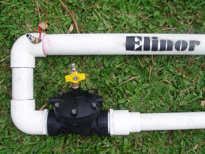

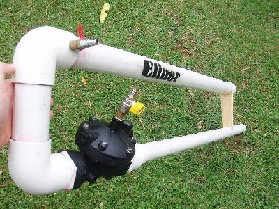

Made for a customer who wants to shoot golfballs and other objects.Over-under configuration shoots golfball over 400 meters.Designed to specific plans,not what I would of made the gun like but thats how it was meant to be also going to be used by a left handed person so everything is built to be shot for a left handed person.
50mm chamber.PN12
40mm barrel.PN12
50mm/2"modded sprinkler valve.
120psi.
'Nuff said,pic' time.
M.H.I.S 2" golfballer-Elinor.

Well not to cheap thats all I can say,the valve was the killer in price.$200 ontop of build price which was about...$50 or so excluding valve cost.
And the simple gun is often the best gun and in fact I'am in the process of making an old-school OVer-Under sprinkler gun.Ahh the simple life.
What you think of the name?Elinor,classy I recon and Gone In 60 Seconds had a bit of a influence on the name.
