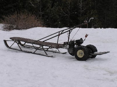

I am in boyscouts and we do an event every year called the Klondyke Dirby. We Hike three miles in the snow to shaver lake's Camp Chawanakee while pushing old outdated wooden sleds loaded with various items that amout to about 600-800LBS per sled (we usually bring Two or three) Anyways I got tired of pushing every yar, so I built a gas powered all steel sled. It has a Kawazaki 200 streetbike engine that I got for 100 bucks, all it needed to run was a spark coil and it started right up. This thing has six gears and the way I have it geared it tops out at about 15 MPH in sixth gear. I built and designed and tested this at my house. It took about 120-130 hours to get to where it is now. Im going to paint it soon.

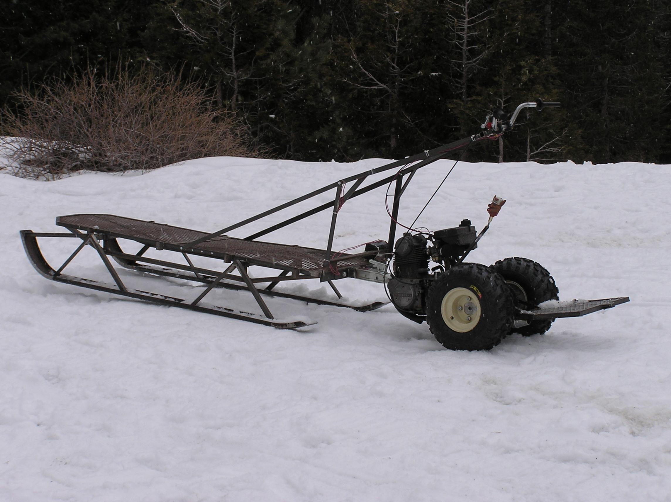

Their she is (before my wicked sweet exaust work)
Snow sled.jpg (33.44 KiB) Viewed 4523 times

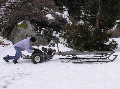

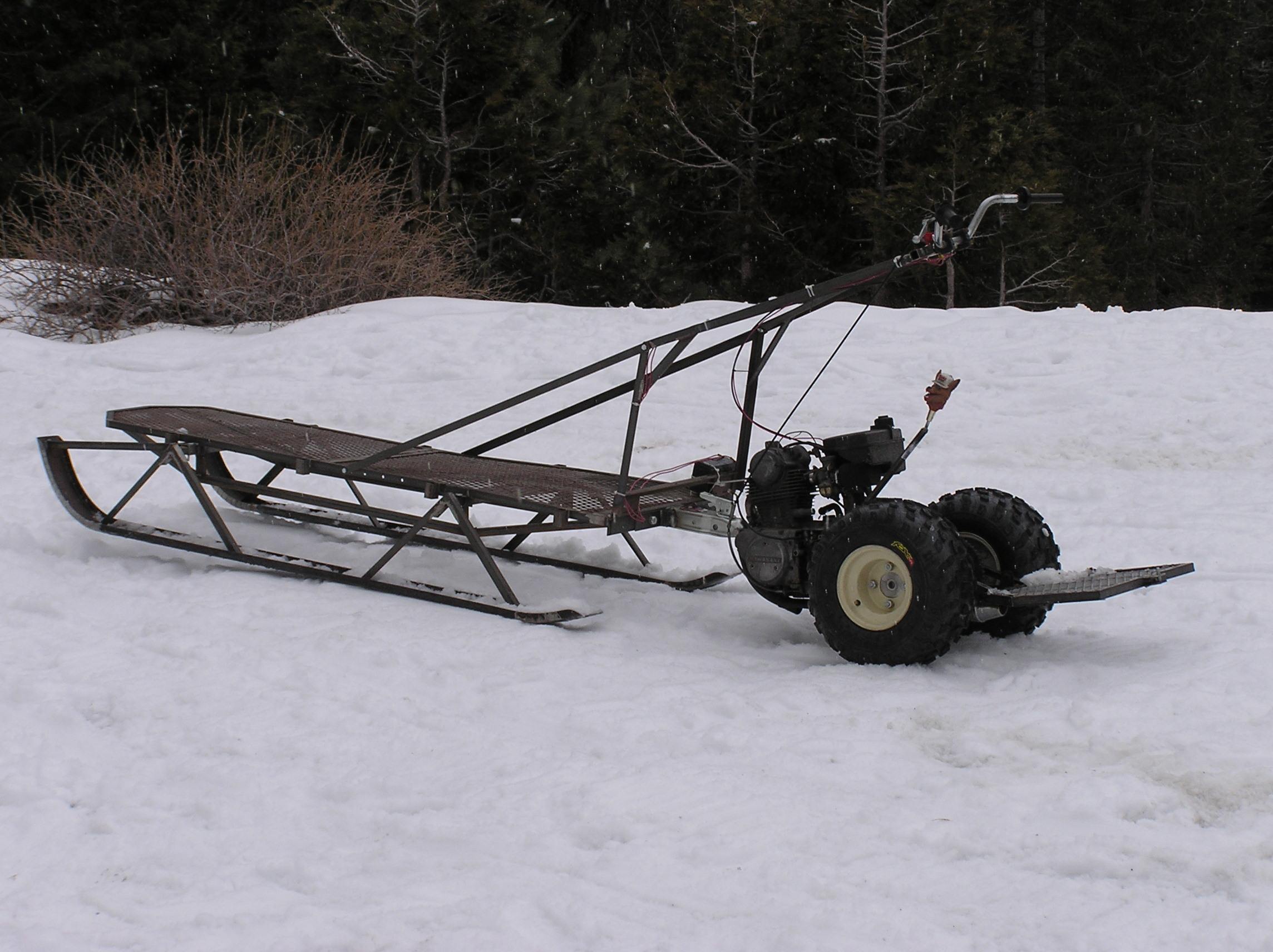

Their she is!!
Their she is!!

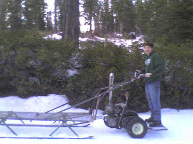

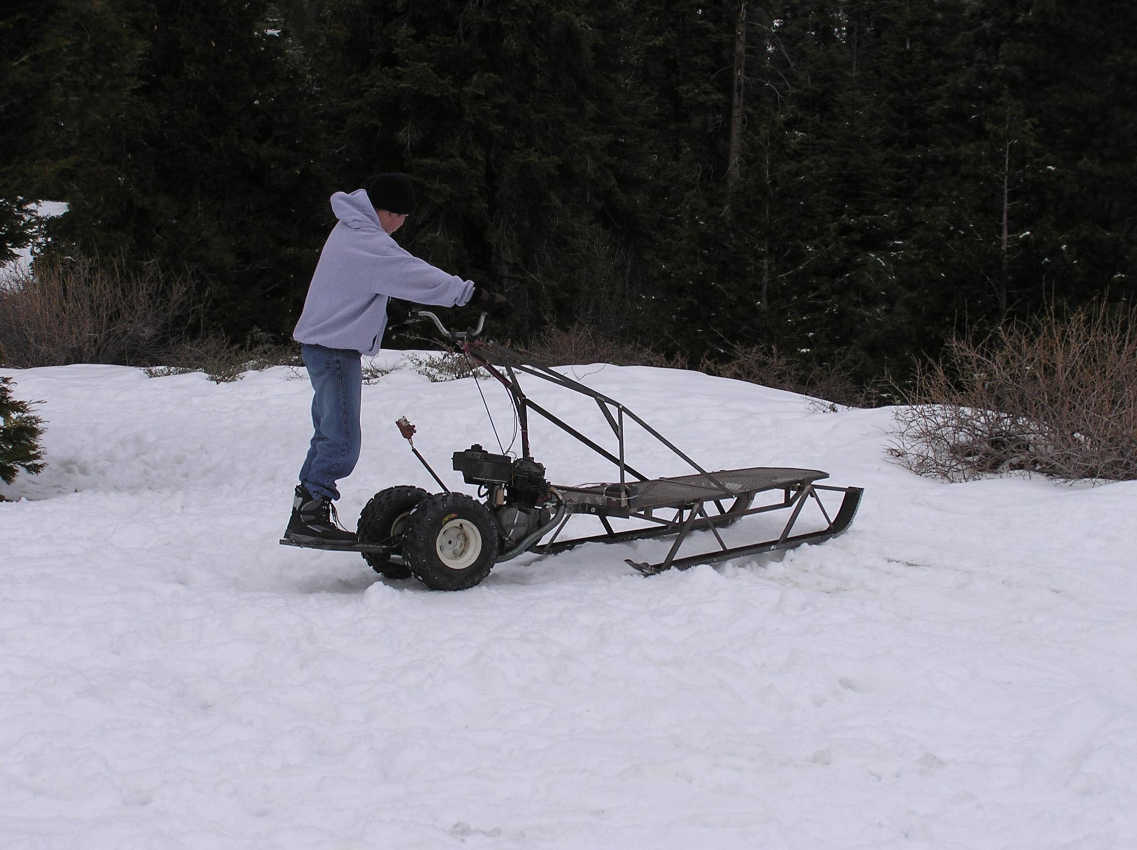

Me Before it broke
Me Before it broke

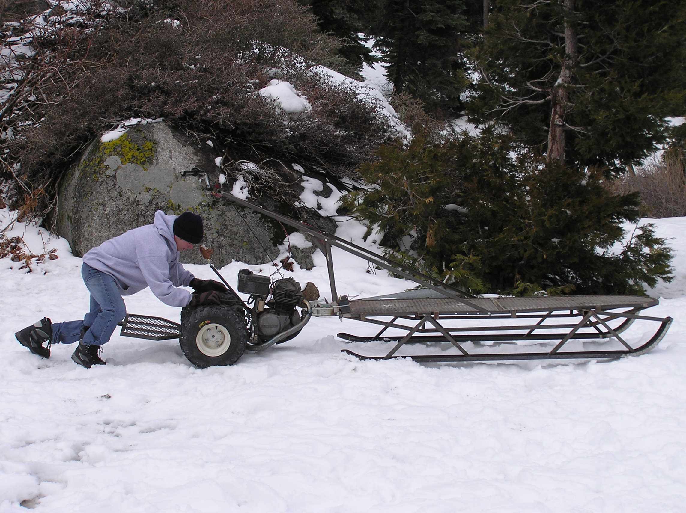

Me After it broke
Me After it broke

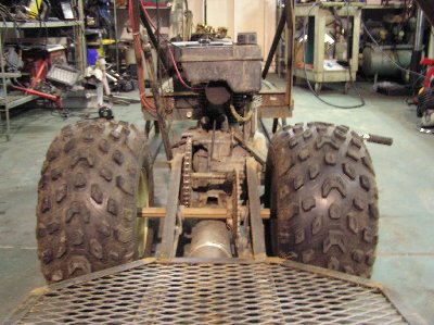

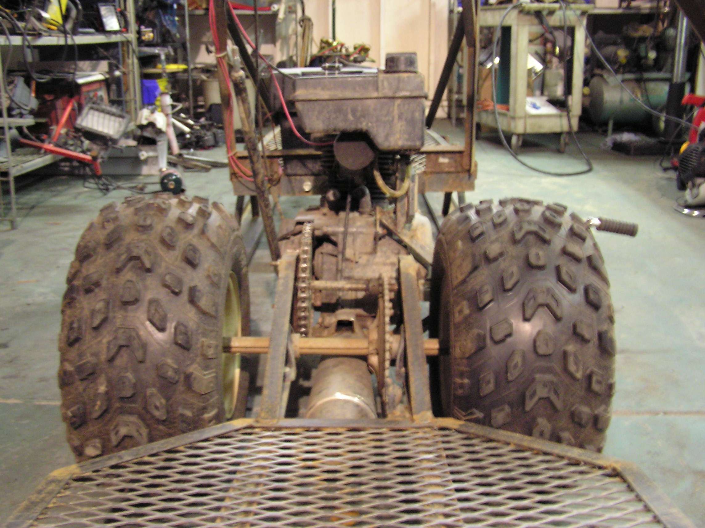

Motor assebly with new exaust work (took me 3hours to get it to work)

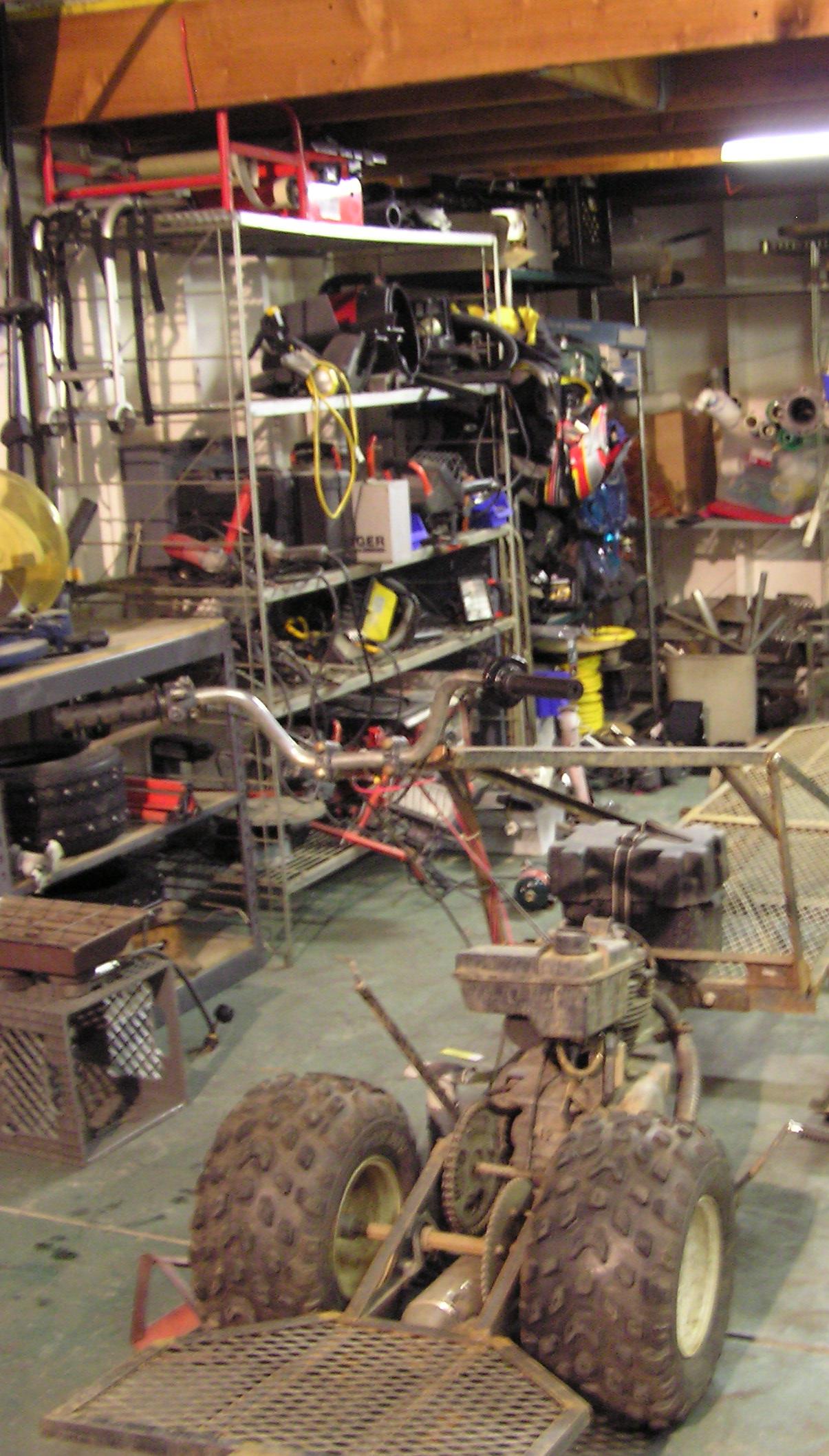

Part of my very messy shop

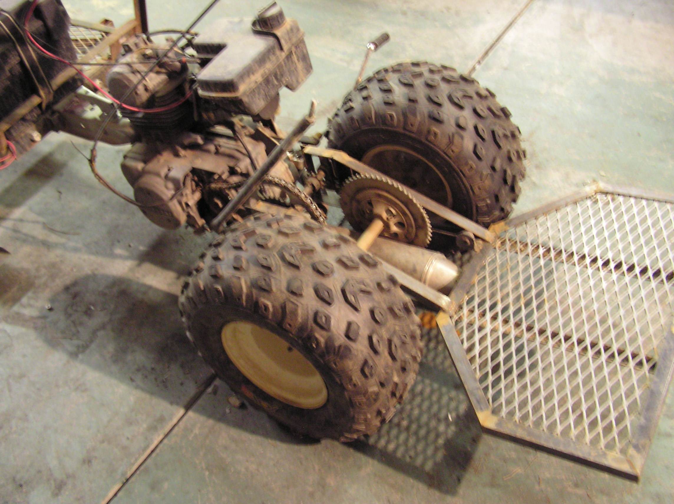

Motor Assembly
Motor Assembly
