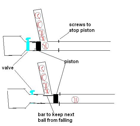

does anyone have any ideas on how to make a pneumatic pitching machine. i have been thinking about it but i'm can't think of much.
this is my only idea do you think it will work?
pitching machine.JPG (20.04 KiB) Viewed 2398 times
It'll work great... once.

Make it spring return. When the valve closes. the piston would push back.
Infernal Maveric
Posts: 220
Joined: Sat Oct 08, 2005 3:41 pm
Like Jack said, I think it would only work once.
A) Because there seems to be now way for the gas to exhaust from, and no spring return for the piston.
B) because as soon as the piston is triggered to fly forwards, it will tear the crews/stop straight from the barrel, destroying the whole set up in a matter of seconds.
Just make the air propel (sp?) baseball, rather than a hammer/piston.

or go out and buy a pitching machine that will launch using only electricity and throw at a reasonable speed.
