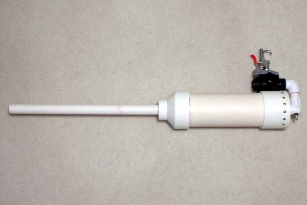

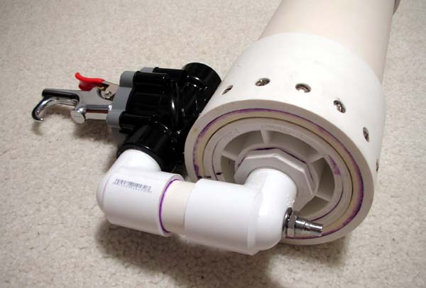

Musket Specs:
Barrel: 1" bore x 34" length
Chamber: 4" ID x 15" lenght
Piston: 4" ID (3" Pipe Cap)
Pilot for piston: Rainbird CP-100
Pilot for sprinkler valve: Heavily bored Husky(Home Depot) Blowgun
Paint: TBD
Sights: TBD
The goal of this project was to build an easily portable carbine with greater power than one using a single 1" sprinkler valve. Also, all parts must be obtainable locally (mid atlantic USA!).
I put this gun together in 2 evenings with no formal plans. I haven't decided on a paint scheme as of yet so I am sure to get flamed for the messy purple primer. I fill it with regulated pressurized air, so I did not install a pressure gauge. At 70psi and up, the report causes moderate ringing of the ears. I have put over 250 rounds through this gun, mostly segments of 1" dowel.
Any comments or ideas are welcome, thanks for viewing.
Side view
Side view

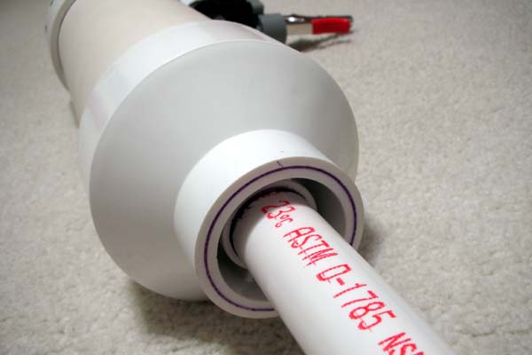

The front end (the bushing was glued into the reducer from the inside)
The back end
The back end

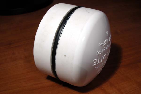

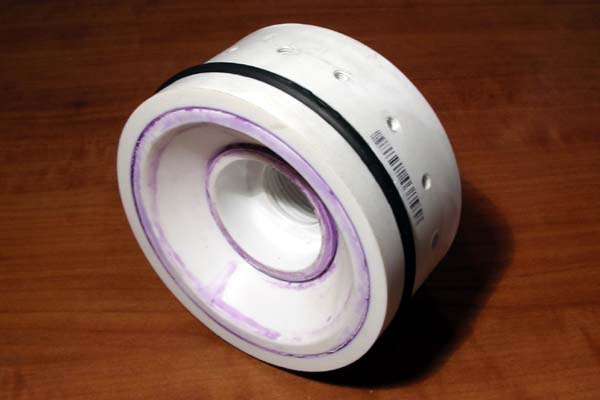

Plug front (the o-rings are hoover vacuum cleaner belts)

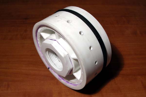

Plug back (3" cap with a trimmed flush bushing glued inside)

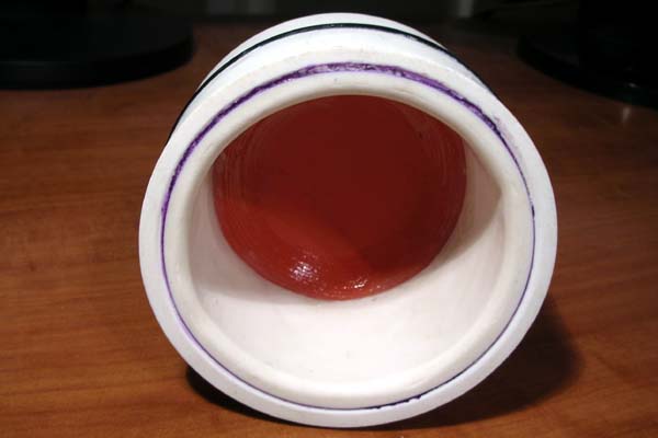

Piston side (notice the small equilibrium port)
Piston front (1/4" rubber glued in place and secured with 3"cell-core pipe for weight reduction)

Very nice gun, I love all the flush bushings and the clean primer job. You do have DWV fitting(s) on it though, so I wouldn't use it above 60 psi.

do you have a lathe?, if not, how did you do the o-rings?

very nicely done - if I could make one suggestion, I would have gone with a longer, thinner chamber of the same volume - that way, you would have had a smaller diameter piston, therefore less pilot volume and you could have piloted it simply with a blowgun.
If you are referring to the bell reducer, under it is a 3" coupling with flush bushings glued inside the 4" dia pipe. It fit together very tight. Also I filled the space between the internal reducer and the bell reducer with epoxy so the bell is really more of a dress collar[/quote]
I turned the groves for the o-rings on a table saw. I set the saw to the depth needed, put the flat end to the fence, and rotated the piece by hand. I have used this trick many times, even just to cleanly cut 4" pipe (my chop saw's only 12" so it just doesn't clear).

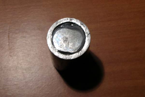

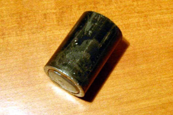

Today I machined a weaver type mount from a 1" coupling so I can mount an old bb gun laser sight I had lying around. Tomorrow, I am making some ammo from 3/4" black iron pipe by cutting 1"-2" lengths and filling them with molten lead. I should be able to update with new pics and damage shots this weekend.

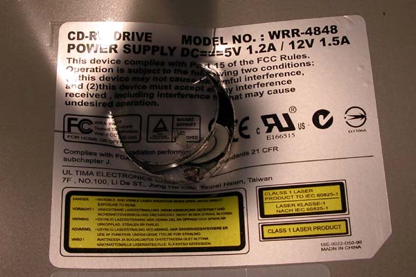

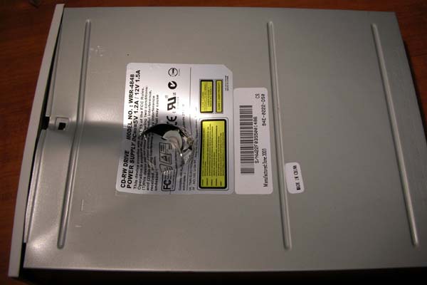

The projectile, and the damage... The CD drive was just sat up on end; when struck, it flew up and back about 5-6 feet.
Slug1
Slug1
Slug2
Slug2
CDW1
CDW1
CDW2
CDW2
CDW3
CDW3
