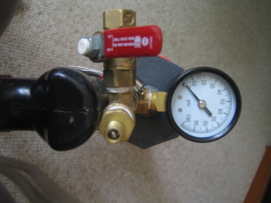

Well, my first professional-ish looking piston cannon is done!
Specs:
2.5" chamber . . . about 2-3 ft.
1" barrel with female adapter
Hot glue piston with a neoprene disk
Pressure Gauge
Schrader valve for filling
1/4" NPT ball valve for actuating piston
2 grips from a water gun
Mostly made of parts I found around the house.

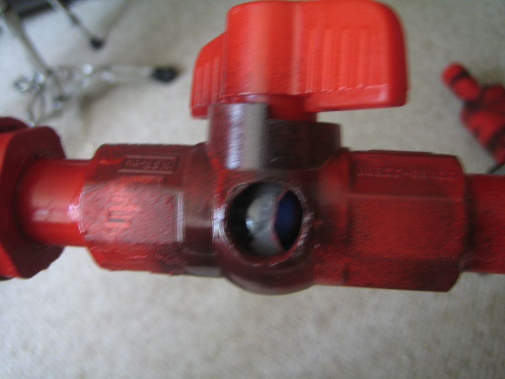

Ball valve breech on marble barrel

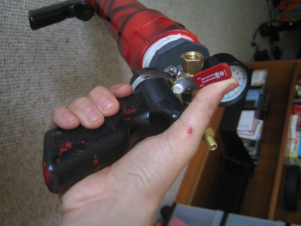

Holding it
Holding it
Back setup
Back setup

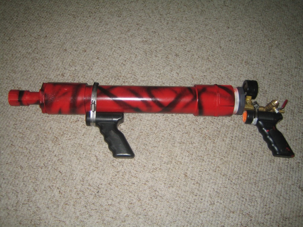

The cannon
The cannon

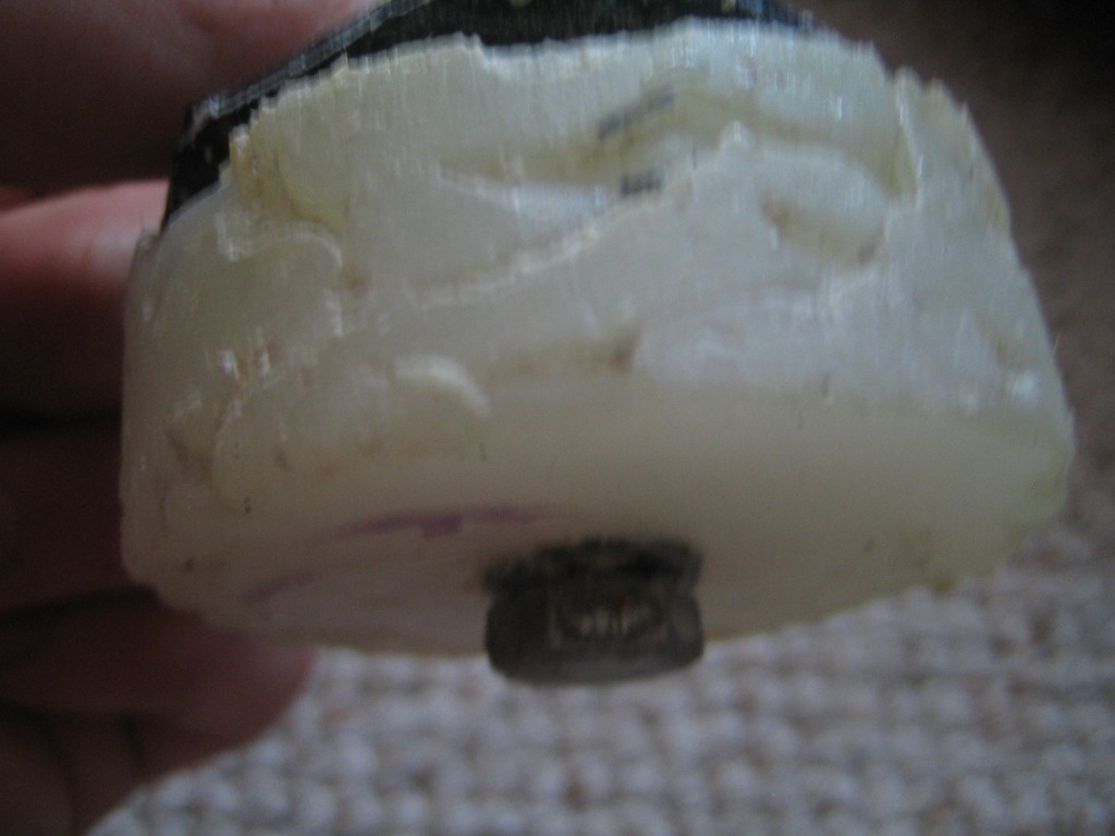

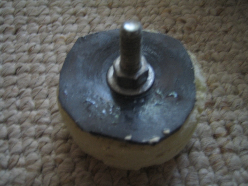

Again the piston
Again the piston
The piston
The piston

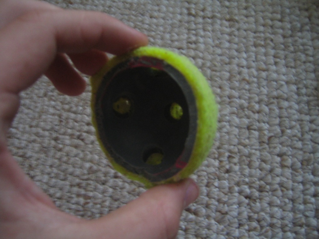

Half tennis ball bumper

Added piston pics, etc.

The marble barrel screws on to the end of the 1" barrel, so its just kinda "half breech loading".
