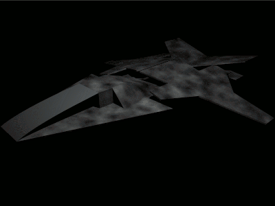

blender is cool)DEMON( wrote:You should check out blender 3D, very good program. There are many tutorials in wiki form for it and it is completely free. You can make your own movies and games out if it too. Worth a look: http://www.blender.org/
i made this in blender, but i hate that texture and i cant get it to go away

I have to third Blender, I've been using it for about a year now, and a spud cannon should be a pretty simple thing to make. (In fact, Blender pulled me away from the old Spudtech forums for a long time...) Perhaps I'll throw together a basic combustion gun later and post a nice render from Yafray.
[Edit] Sandman, to get rid of that texture, just hit the little 'X' next to the texture's name in the texturing buttons.
[Edit 2] I should point out, it can be kind of hard to make precise technical models in Blender, since its primary function is not as a CAD program. It can be done though. So if you really need the precision, a CAD program like Alibre or Rhino might be a better bet.
