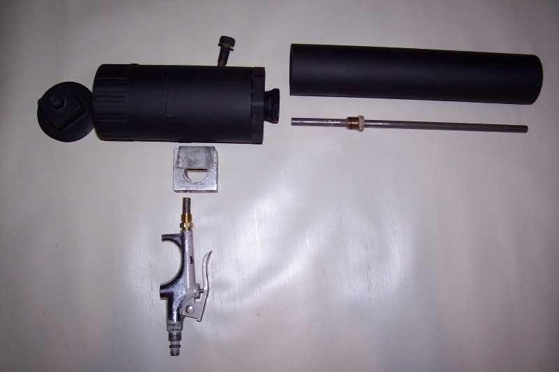

ok guys this is my first aluminum vortex block for my mac 10 .177 cal bbmg. I finally got to shoot it and take video but it was dark sorry, this thing is awesome to say the least. the ROF is amazing and it shoots harder than the cloud i first built. i made both to see the difference, a cloud and a vortex and i would go with the vortex anyday. this gun can be completely stripped down with a cresent wrench. im going to install a spring and plunger soon. btw i try to keep my shots in a big cardboard box so i can use a magnet to gather up the bb's and reuse them unless they hit something hard.

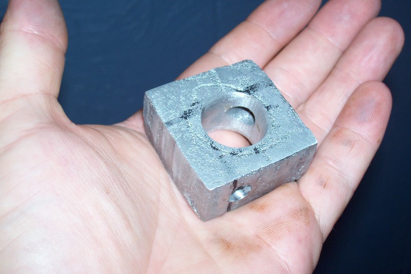

drilled and ready to install

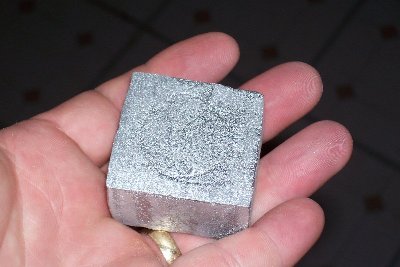

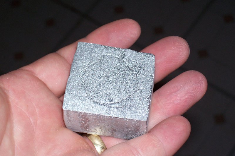

solid aluminum block after casting

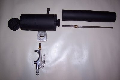

stripped down - new paint job, new grip in the works

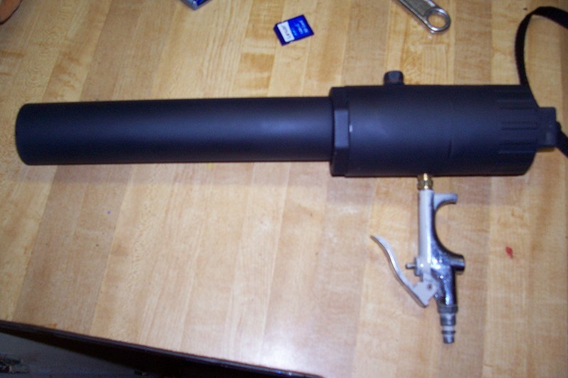

Mac 10 bbmg
Mac 10 bbmg

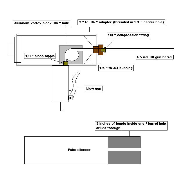

here is a sketch of how the gun is assembled. i think it is a little different from some of the others but not sure.
iknowmy3tables
Posts: 1596
Location: maryland
Has thanked: 3 times
Been thanked: 9 times
awesome job so far for a guy who sounds iffy on vortex blocks. now you need a ram a spring loaded device that will push the bbs forward other wise you will have feeding problems after to tank gets a little low

great advice thx, i will work on that spring loaded plunger bb feeding mechanism thingy dober majiger.

A silencer would be useless for a strafer, except for looks. There isn't enough sound to be silenced, although I'd find the pinging of the BBs and the metal block funny. :lol:
Make sure the block is removable, because you used the "full hole" type of block, which is prone to jamming without shrouds on it.
Another problem I see is that the air input is going to be very difficult to set up, unless you mount it in clear pipe.
The block itself looks pretty good, great job with the aluminum.

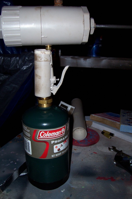

your right noname about the noise, the silencer is only for looks and a hand grip but i got it all put together with shrouds on the block and the whole gun can be taken apart with 1 cresent wrench. everything lined up. it took me a while to get it figured out but i got it to all fit correctly. the rate of fire is awesome. i even hooked up a 1 pound propane bottle to power it but the propane does not come out fast enough, maybe if i made a expansion chamber i could shoot bursts with it. btw according to research green gas is propane.
the bottle adapter can be found at some propane refill stores for a couple bucks.

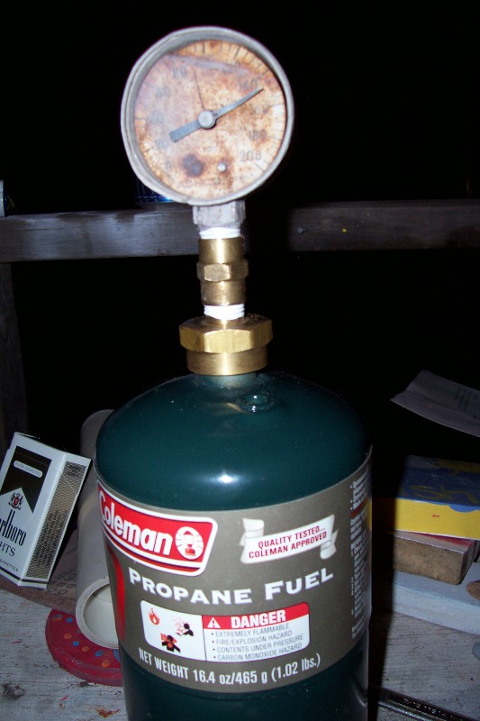

150 psi in a full bottle

danm thats a buitie! The sketch helps me understand it. Overall grate job!
dweasel wrote:Can anyone explain the block to me or send me a good schematic.
You can tell how it works here
