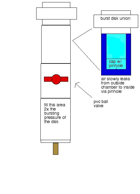

I just built one of PVC Aresnal's Air Delay mines. They work good but the delay is just not sufficient enough, and you can't have it prefilled and ready to go without it triggering within the next 5 seconds. My design to improve on his to fix these problems, is show below:
- It looks kind of like the WW2 German STIELHANDGRANATE 24
- grenade.jpg (24.72 KiB) Viewed 2884 times

I could just put a balloon for a burst disk, and fill it with BBs.homedepotpro wrote:his design seems to be a directional charge, unlike a conventional frag grenade. I figure there was an easier way to achieve the results he wanted
I was also thinking of making a claymore type mine, with a sprinkler w/ solenoid remotely triggered via a wire and a button switch, just like the real thing.

I just noticed this thread. Funny thing is, I was just staring at my mine, trying to figure out what to improve.
I had some good results, but the burst discs were too unreliable. I was using different kinds of tape. None produced a decent power-delay result. And of course, my short attention span caused me to move on to something else. But I will come back to it.
Good luck with yours. If you come across a good burst disc material, please let me know.

well I was pigging out on junk food today and I realized that my gummy snack packages could be used for burst disk, so try various food wrappers and packaging material, it also helps when your mom is a Costco member and tends to buy some stuff in bulk like fruit gummies

Any chip bags or candy wrappers are very good burst discs. In a 1" union, they burst at about 90-115 psi, and in a 1/2" union they burst at about 130 psi. They also seal perfectly, which is also a big improvement on layered aluminum foil.

Cut-up balloons work good. They have a low bursting pressure, but they swell up, so they get even more of a delay (about 3.5 seconds). You could layer them to get more power.PVC Arsenal 17 wrote:I just noticed this thread. Funny thing is, I was just staring at my mine, trying to figure out what to improve.

hmm if maybe if you like ballons tire tubes would be good
