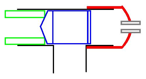

ok i know every one has problem with there pistons but mine doesn't seam to want to pull back when vented now the piston fits perfectly inside the cute and doest need orings or duck tape and seals well against the barrel and even with my light spring removed it wont work
plz help i rely want to get this gun working :(
the crappy paint below is my basic set up

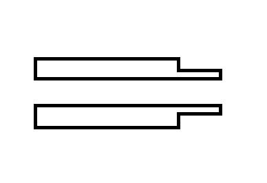

heres the hole piston
heres a blurry picture of my piston

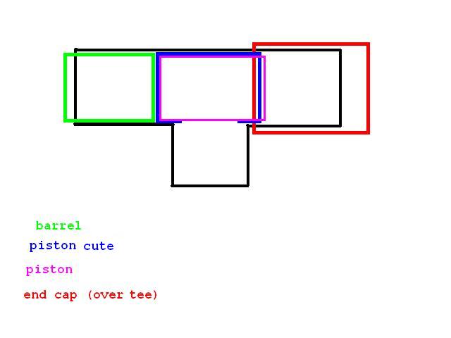

piston inside chute (old piston)
the chute inside tee
inside the tee

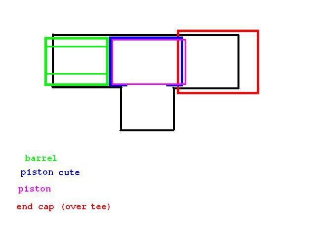

hears a better picture of my set up
hi
Posts: 1619
if that is an accurate picure, then the problem is that there is no air in front of the piston to push it back. try using a tee that is a little bigger.

is there anyway i can make some space in front of the piston? maby remove some
hi
Posts: 1619
doubt it. think you just need a slightly larger tee.
you might get away with drilling holes, but that would weaken it, so i dont think its worth it.
