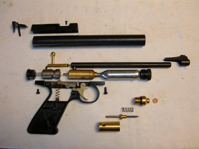

us sniper wrote:Does anyone know any detailed information about how the crosman night stalker works. I am going to build something similar to it and I was wondering if anyone knew what type of velve it has or how it releases the co2.
well im not sure about how the "night stalker" releases co2 but this picture might help
air pistol internals
As far as I know the valve is similar to the 2240 above, with the difference that there's a blowback mechanism which recocks the hammer and rotates the magazine with every shot.

Thank you for the diagram. I think I might build an air rifle around this valve. I do not think that the night stalker uses blow back to cycle the magazine. I think the trigger cycles the magazine.
Do you think that if I increased the size of the bottle of c02 that the design of the gun would still work or not. Would it be able to keep the pressure or would it all explode.

us sniper wrote:I do not think that the night stalker uses blow back to cycle the magazine. I think the trigger cycles the magazine.
it could be the blow-back simply re-cocks the hammer. you might want to have a look at the crosman 1077:
It uses the trigger to recock the hammer and cycle the mag, pretty much like most CO2 designs.
I would advise against making your own, it's a lot of effort and the result you'll get probably won't be any better than a cheap shop-bought model. I think you'd be better off buying a cheapo rifle and modifiying it (stronger hammer spring, longer barrel etc.)

Thanks fore the picture. I cannot tell clearly by the photo, but id the co2 in the foregrip or the stock? I already hade a pumpmaster 760 which is why I am now trying to build a rifle. I want it to be co2 because I hate having to pump so many times.
the CO2 capsules are housed in the tube marked 1077-017
us sniper
Posts: 176
Joined: Wed Jan 17, 2007 12:28 am
Is the c02 the 10 gram or is it larger? If it is the 10 gram how powerful is it and how many shots do you get out of it?
it uses the 12 gram CO2 capsules and gets around 40 shots per capsule.
