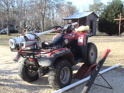

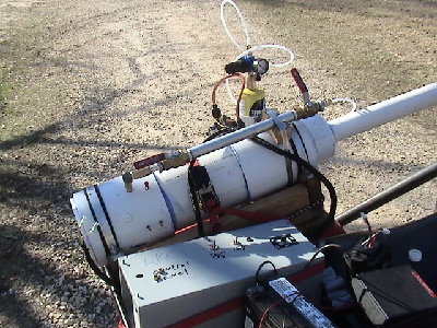

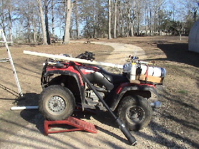

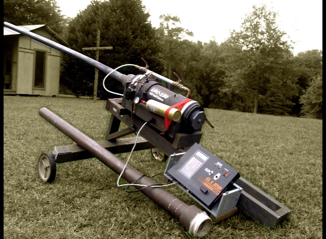

A Propane/MAPP golf ball cannon with 6"X17" chamber and 10 foot golf ball barrel. Can shoot a golf ball up to 1500 yards at 580 fps. Has a 4 inch fan blade mounted on an old power wheels motor. Uses the ignition coil out of a car to fire.

Fnord, that's 580 FPS. It will shoot over a half mile before hitting the ground on a perfect day. NOthing is charging up before ignition, that is the chamber fan mixing the fuel and air. And I have already painted, just no pics yet.

im wondering bout your meter, it looks like there is no pressure gauge on the meter itself, but is that a regulator on the MAPP bottle

Regulator is on the MAPP bottle
