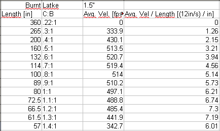

Generally: Which C:B ratio has the best velocity per barrel length unit ?

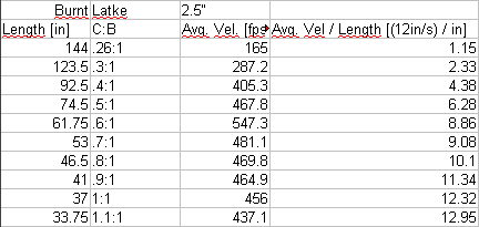

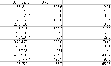

I have tweaked Burnt Latke´s figures a little - divided his velocities by his barrel lengths - see attached images.
The result from this little division experiment seems to be that the 1.5" cannon performed the best with a 1.2:1 C:B ratio, there is no peak for the 2.5" cannon but the curve seems to be about to flatten out at the large-chamber end, and for the 0.75" gun, the most length-efficient barrels are the absurdly short ones (that nobody would want to use anyway).
Just an idea anyway: If you want to match a chamber with your barrel that will give the best performance for the length of the barrel, it appears that 1.2:1 is a good figure overall. Or, put differently again: Below 0.7:1 is a waste of barrel. With a barrel of a reasonable length, above 1.2:1 could be a waste of fuel and may actually degrade performance.

Another look at C:B ratios
- Burnt Latke 2.5" data
http://www.burntlatke.com/jpg600/25-cb-data.gif - bl2.5.PNG (6.83 KiB) Viewed 4309 times
- Burnt Latke 1.5" data
http://www.burntlatke.com/15cb-data.html - bl1.5.PNG (8.35 KiB) Viewed 4309 times
- Burnt Latke 0.75" data
http://www.burntlatke.com/jpg600/cb-testdata.gif - bl0.75.PNG (8.21 KiB) Viewed 4309 times

I may be miss-interpreting your analysis but ...
You say a CB of 1.2 would be optimal because the d(Velocity)/d(length) is maximum for that CB? Latke's data for the 1.5" puts the dV/dL at 7.3 for that ratio.
But, that ratio under performs the gun with the optimal barrel (513 fps vs. 485 fps).
I guess what you are saying is that over a certain range the cost in muzzle velocity for shortening the barrel is fairly minimal. In this case, cutting the barrel length in half only lowered the muzzle velocity by a small amount.
A completely reasonable way to look at the problem. In fact, I've been thinking about a similar way of looking at it. I call it the "10% Rule". If you want to keep the barrel as short as possible you might ask the question "How short can the barrel be such that the decrease in muzzle velocity is less than 10% of the optimal muzzle velocity?" It is really surprising how much barrel you can chop of and still keep the muzzle velocity within 10% of the velocity you get with the optimum barrel. (I choose 10% as the cutoff since that was the shot-to-short variablity that Latke saw using spuds as ammo.) For my combustion model, it looks like the "10% barrel" is roughly half the length of the optimal barrel. Using Latke's 1.5" data the drop in velocity is only 5% for the half length barrel.
With more data and thought we might be able to declare a "Spud Law" on your observation.

What you are noticing is, essentially, that the pressure in the bore decreases as the projectile moves down it.
Also, as a couple of notes:
1) The last few data points of the 1.5" data arn't very good.
2) You really should graph these - your assumption that the curve reaches a maximum doesn't look right. (and that includes the 1.5" curve.)
